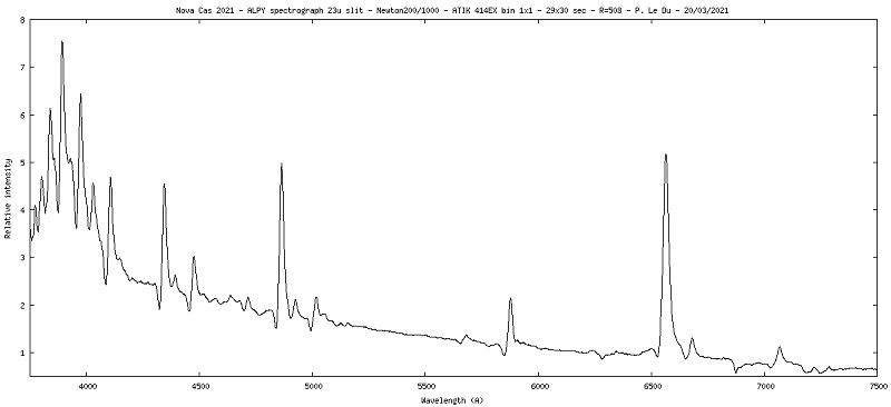

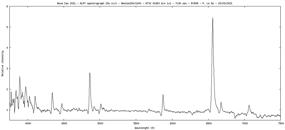

Pascal Le Du
- Posts: 29
- Joined: Mon Dec 07, 2015 5:42 pm
- Location: Porspoder, Brittany
Hello
My small contribution for this very interesting Nova.

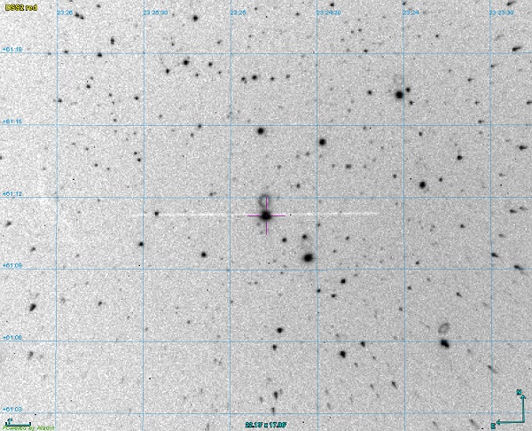

Spectrum realized from the tip of Brittany with a 200 mm newton and an Alpy600 (7x30sec). For information, it is better to make the spectrum of this nova with a vertical slit.
Indeed, as we can see on the PanSTARRS image and on my spectrum which compiles 29 exposures of 30 seconds, the stars located near the nova can pollute its spectrum. Pascal

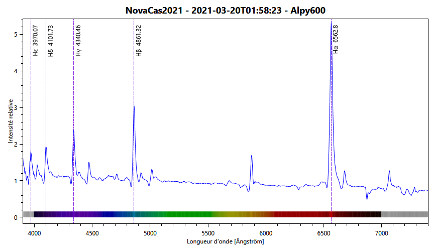

Matthieu Le Lain
- Posts: 24
- Joined: Mon Apr 15, 2019 4:33 pm

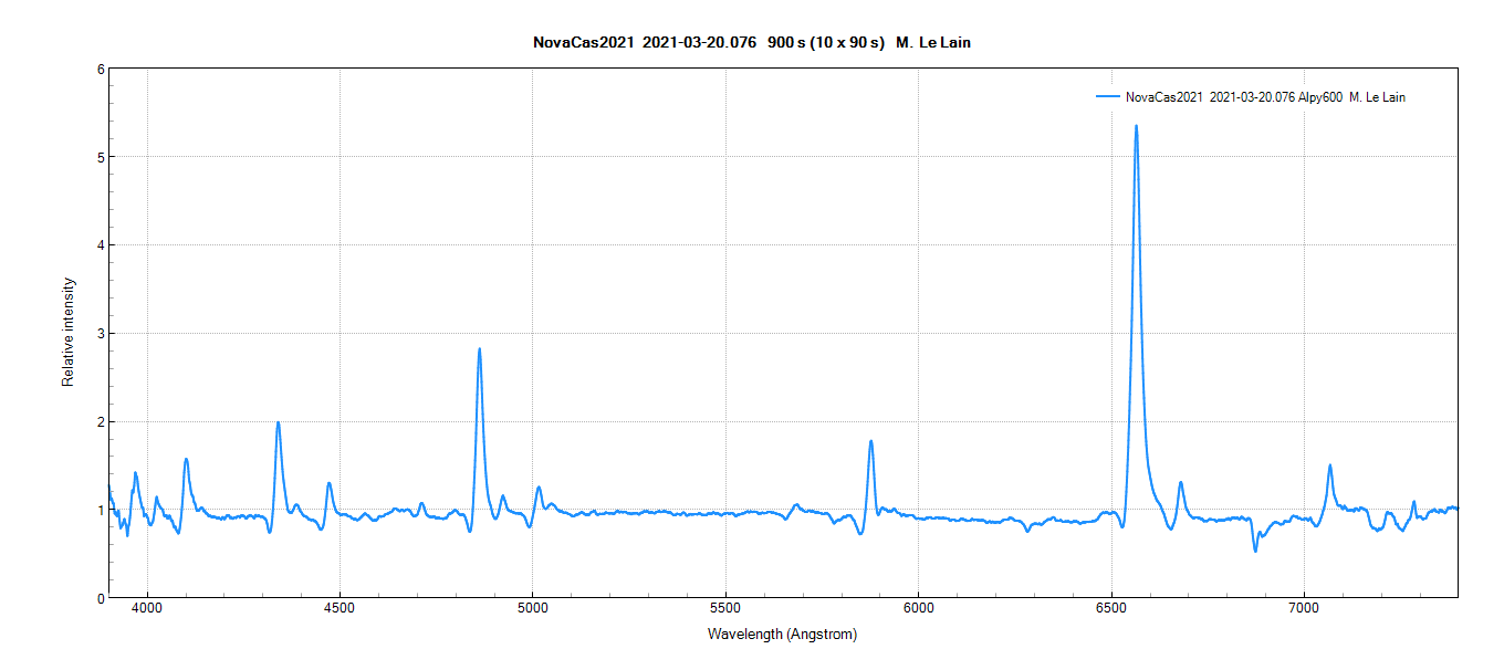

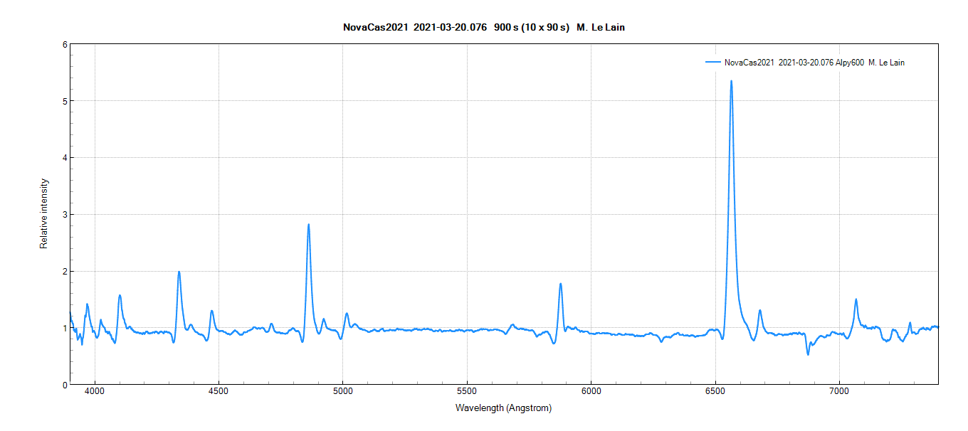

A new spectrum of NovaCas2021 with an Alpy600 last night, on C8 f/6.3 - Atik460Ex - 10 x 90s exp.
Matthieu
Matthieu

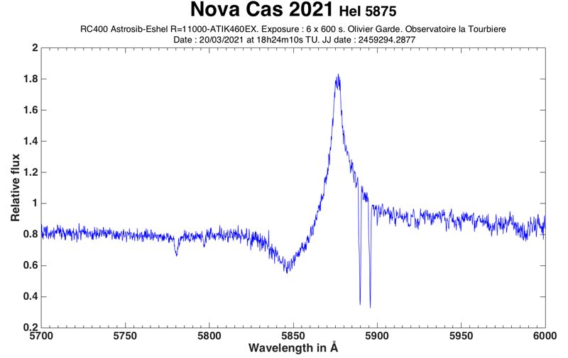

- Posts: 1276
And my contribution with this spectrum taken with an eshel spectrograph (R=11000) with difficulty because I had a tree that was in the line of the sight of the nova !!! and very low in my north west horizon), so only 6 exposures of 600s each.
Here's the full spectrum (I cut the spectrum at 4300 Å because the blue part is very noisy).
And the quick calculation of the ejecta velocity on H Alpha and H beta line
The Helium I 5875 emission line, always with p Cyg profil

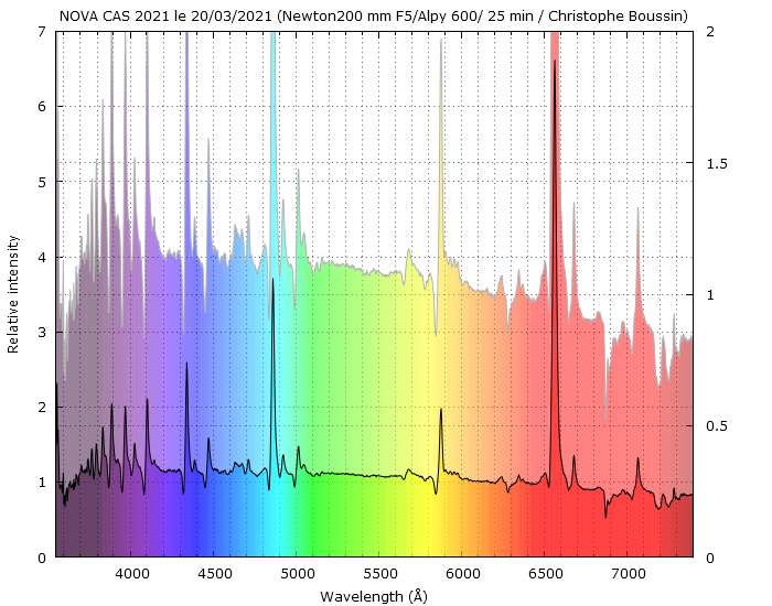

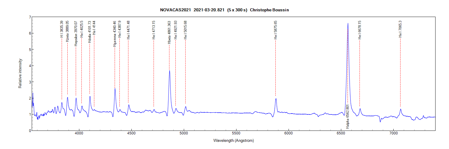

- Posts: 173

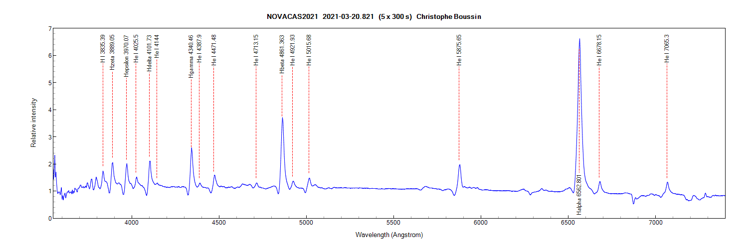

Here is my contribution to the monitoring of the nova Cas 2021.
The following spectrum was obtained the 20th of March at 19 h 42 TU with my Alpy 600 (resolution of 528, JJ = 2459294.3211) and an acquisition time of 25 min (5 x 300s) :
Clear skies,
Clear skies,

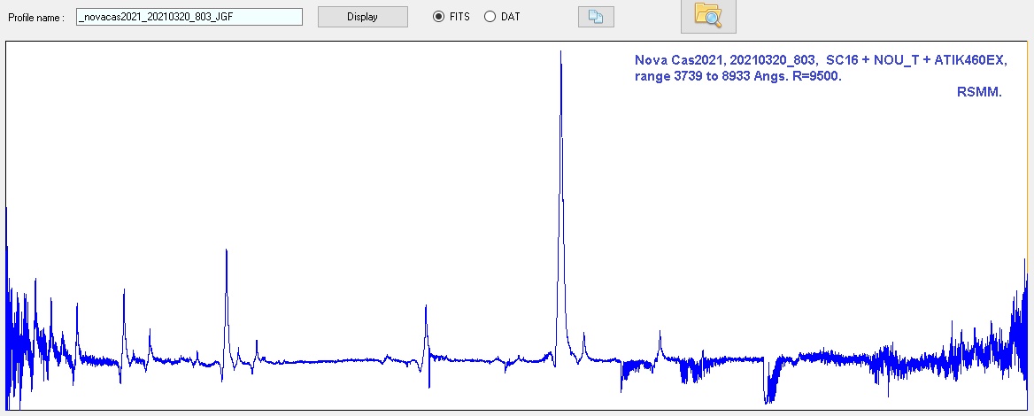

- Posts: 731
Hello at all,
This is Nova Cas 2021 last night from RSMM.
Cheers, J. Guarro.
Cheers, J. Guarro.

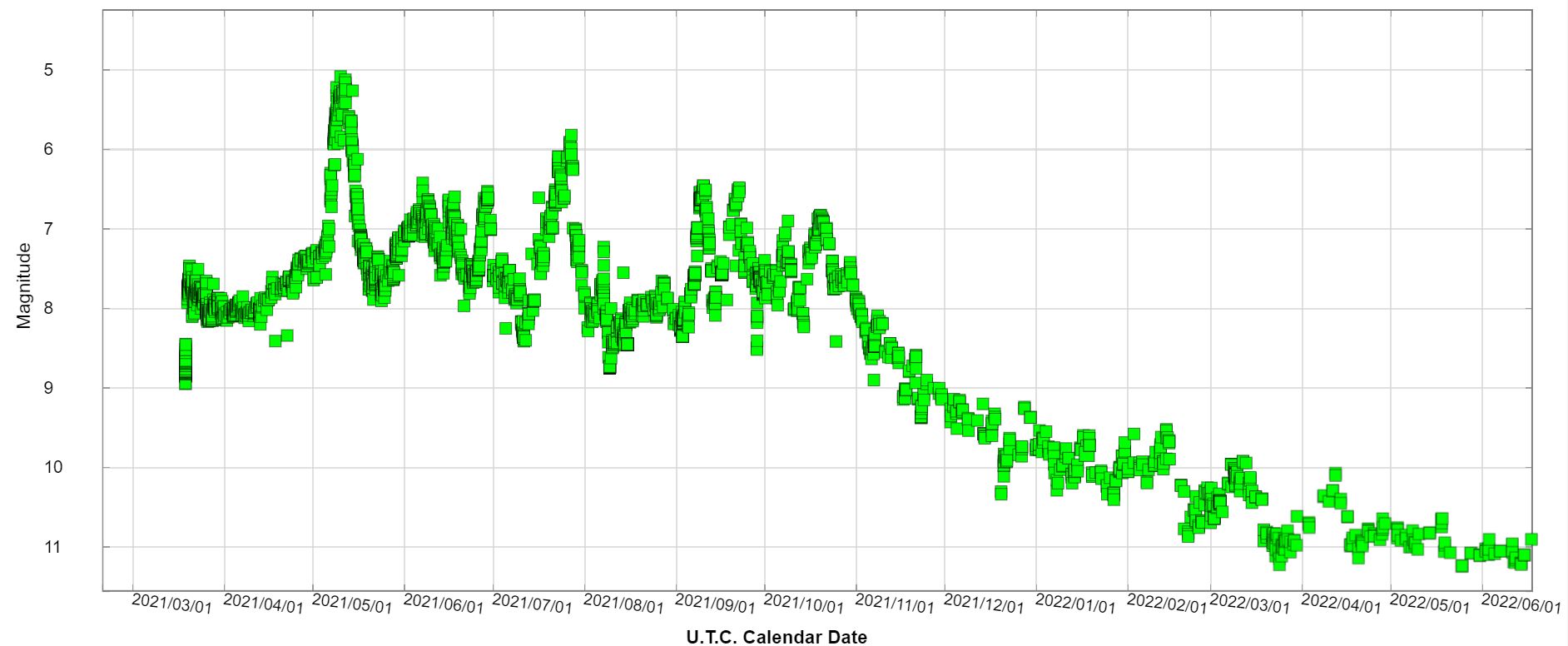

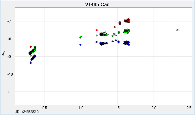

Light curve (BVR) from AAVSO:
- NovaCas2021.png (14.68 KiB) Viewed 68192 times
