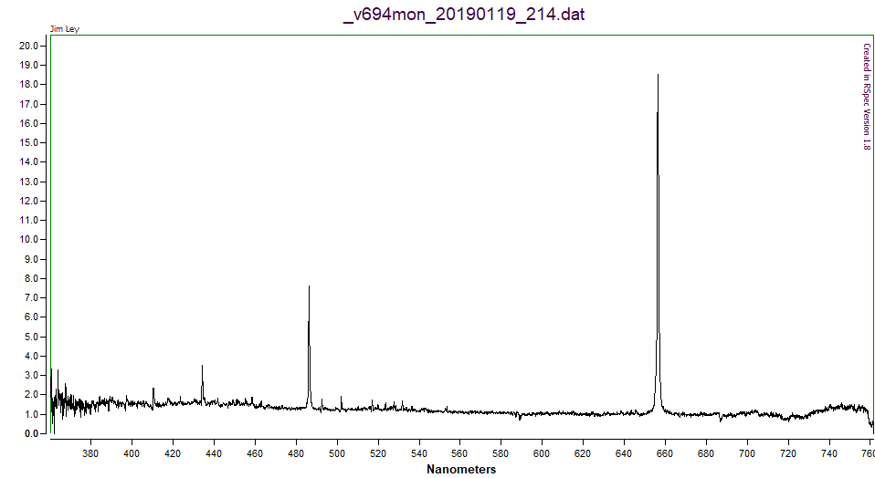

I was only able to record one acquisition of 300s before the clouds rolled in.
V694 Mon full 300s.png (13.94 KiB) Viewed 7234 times

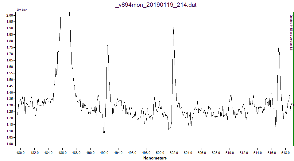

I see the Hydrogen Balmer lines without p-cygni profiles but many metal lines with p-cygni profiles.
V694 Mon P-Cygni.png (18.47 KiB) Viewed 7234 times

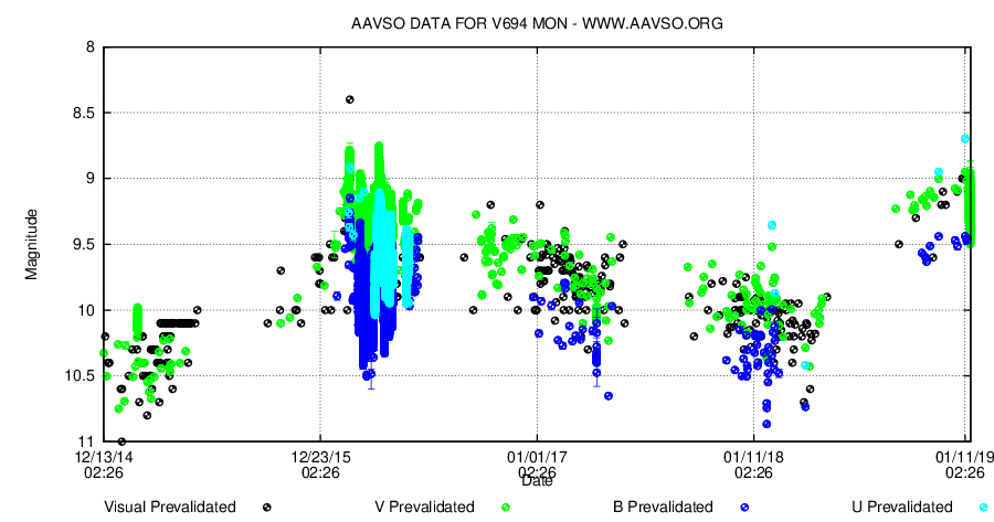

AAVSO suggests continuing brightening, similar to 2016.
V694Mon AAVSO.png (59.7 KiB) Viewed 7234 times
Is V694 Mon in outburst?

Yes, Balmer lines are in (almost) pre emission since october, with just a faint absorption at about -200 km/s
See information letter 2018-03, p. 88 : http://www.astrosurf.com/aras/novae/Inf ... 018-03.pdf,
ATel 12231 http://www.astronomerstelegram.org/?read=12231 with spectra obtained by Peter Somogyi and http://www.astronomerstelegram.org/?read=12227
I'm not conviced by the identification of He I lines 4922 and 5016 as stronger than Fe II. But unfortunately, we have no high res spectra for Hbeta region in november.
This is a peculiar state for this star. The optical outburst (luminosity) is clear from AAVSO data.
But the concept of outburst is unclear for this star which is in permanent outburst, with strong variations of the absorptions in Balmer lines with terminal velocities chnaging from ~ 1000 to 8000 km/s

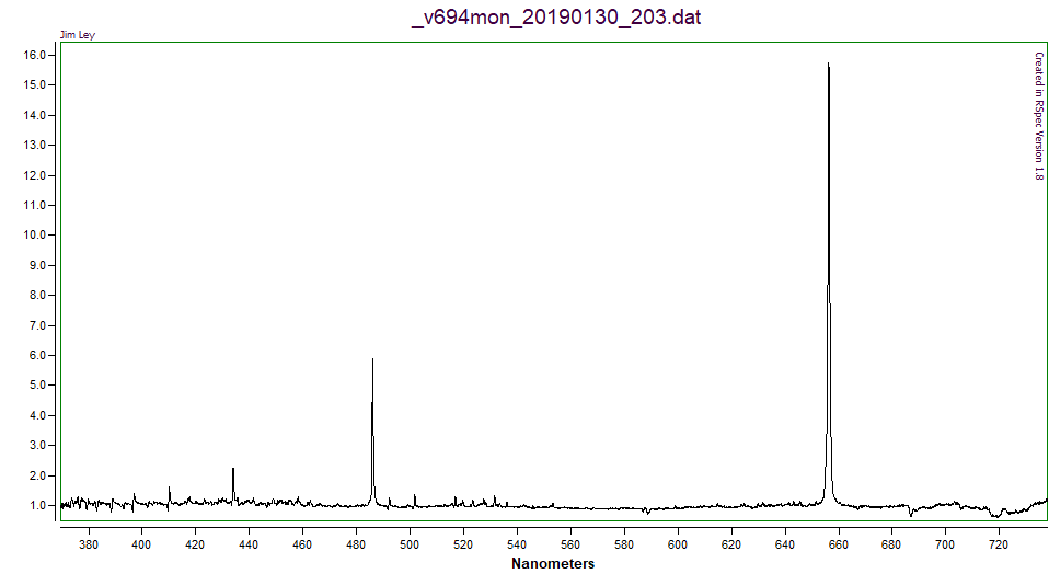

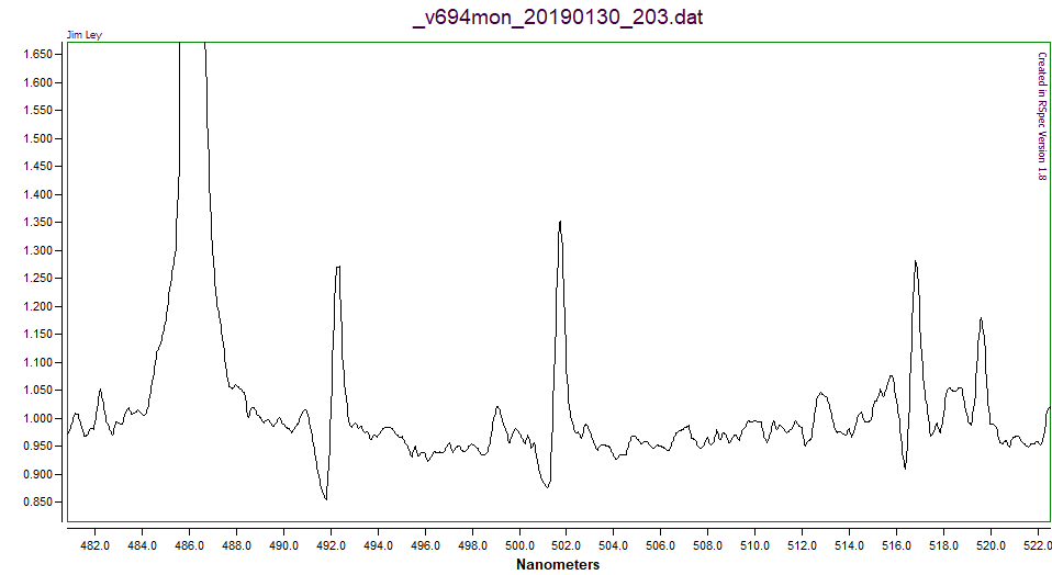

Here is a spectrum that I took last night.
V694 Mon full.png (12.53 KiB) Viewed 7157 times
This was 10 x 600s. That certainly increased the signal to noise ratio!

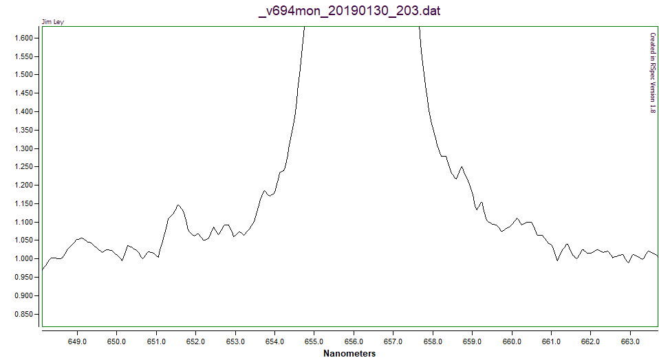

Do you think that these profiles suggest absorption of H-beta and H-alpha?
V694 Mon H-beta.png (16.27 KiB) Viewed 7157 times
V694 Mon H-alpha.png (13.34 KiB) Viewed 7157 times

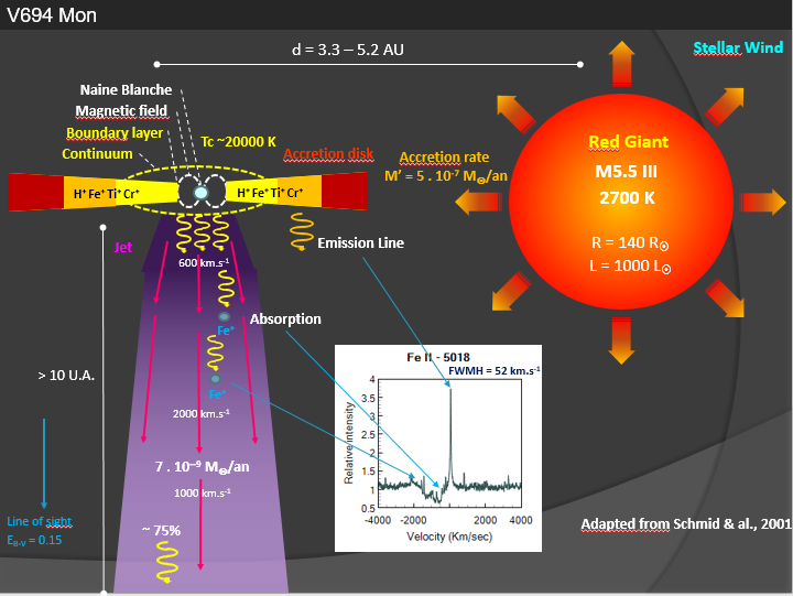

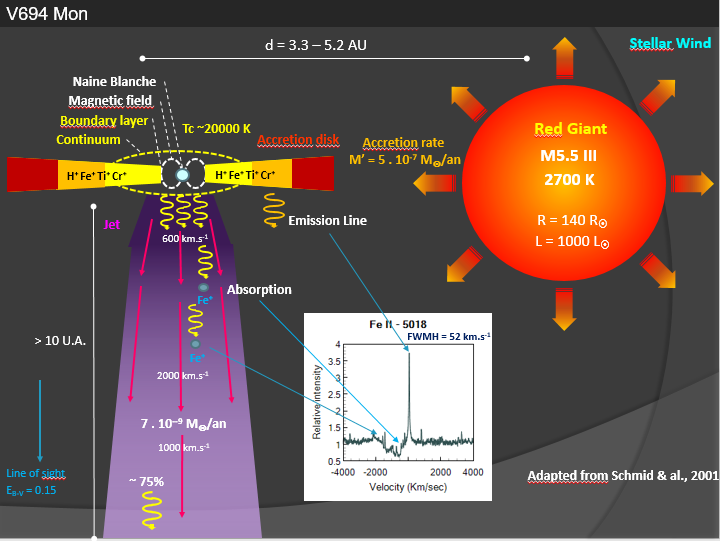

Considering once again your excellent diagram
By definition, one will only see the emissions you show from the accretion disk if the disk is optically thin. Is it possible that, due to increased mass transfer, the disk has become optically thick (to H-alpha at least) and that the H-alpha emission is coming from further out and therefore is not absorbed by the jet? Does that make sense?
