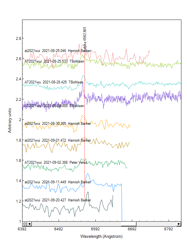

There seems to have been a significant change (the brown trace is the latest spectrum) in the H-alpha profile if the observation I made last night is correctly processed:
Hopefully others can manage to take a spectrum to confirm the change. I don't know if this is "normal" for Be stars, or if it indicates that the object is something else.

clouds clouds clouds, so I have had no chance yet to confirm the the possible change in the spectrum.

I think these sort of effects are seen in discs and accreting systems due to asymmetry.
It reminds me a bit of the changes seen in the He 6678 line in the X ray binary X Per
http://www.spectro-aras.com/forum/viewt ... =10#p14191
Certainly an interesting system. A pity it is rather faint for high SNR at high resolution

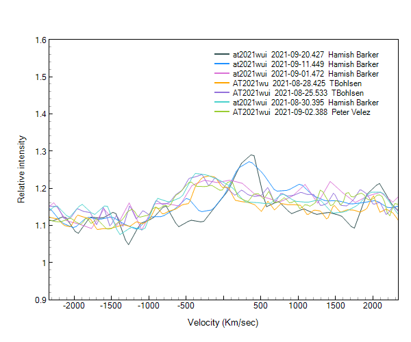

clear again last night, but I started late so only an hour, so the S/N suffered a bit.
the redshifted Halpha peak is there again. comparing to the spectra which were previously taken, it appears to be a fairly symmetric swing of about +/-400 km/s around H alpha.
I don't know how to plot them staggered on plotspectra to avoid confusion. anyway the legend shows the last plot at the top in black.

worked out how to make the stacked chart.
I wonder if that's a trend showing in the doppler shifting of H alpha. It will be interesting to track if it shifts back and/or displays a long term oscillation.

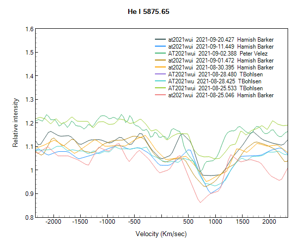

Posted: Tue Sep 21, 2021 1:02 pm
What are the photospheric absorption lines doing eg Balmer, He ? This would give you a clue as to whether it is due to orbital velocity of a binary system or something specifically to do with the H alpha emission source.

He1 ad 5875 and I assume the sodium doublet to the right of it doesn't seem to move. Plotspectra has just crashed so will take me a little while to reload all the spectra again.
