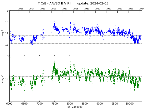

The new season of observations after the solar conjunction is begining.
Since the detection of the end of the high state (2015-2023), T CrB evolves in the same way as before the high state with orbital variations of the photometry and spectroscopic appearence.
First spectra for the new season were secured by Woody Sims.
The aspect of the spectrum (continuum and emission lines) are compliant with the spectroscopic evolution of the traget before the "big active phase" 2015-2023.
We undergo the monitoring before the next nova event. One key point of this monitoring is: Are there any warning signs of the outburst?
One spectrum (both low and medium resolution) by week should be a good cadency at this state.
For spectrographs with short wavelength range the zone 4600-5100 is recommended.
Flux calibrated spectra are a must. Due to the strong flickering (especially B and V) the photometry should be acquired during the acquisition of the spectrum (some duration) and the flux calibration should use mean or median value of the magnitude V.

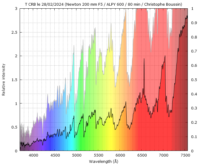

The weather forecast isn't looking good for me at the moment...so when an opportunity presents itself, I can't miss it !
So here's my first T CrB spectrum for the year 2024, obtained with my Alpy 600 on February 28 (resolution of 515, JJ = 2460368.5673) and an acquisition time of 80 min (8 x 600 s) :
T CrB on February 28th, 2024 (3700-7565 A)
_tcrb_20240228_067_Christophe Boussin_3700_7565.png (113.55 KiB) Viewed 17137 times
