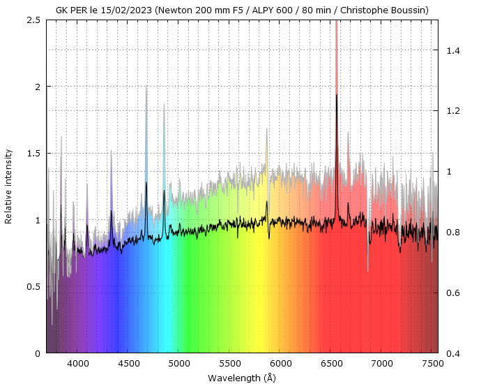

by Christophe Boussin
I obtained a new spectrum of GK Per with my Alpy 600 on 15 February at 20:28 UT (resolution of 520, JJ = 2459991.3942) with an acquisition time of 80 min (8 x 600s) :
GK Per on February 15th, 2023
_gkper_20230215_894_Christophe Boussin_3700_7565.png (93.14 KiB) Viewed 25747 times

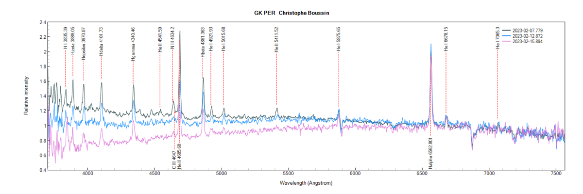

GK Per on February 7th, 12th and 15th, 2023 (identification of some lines from PlotSpectra)

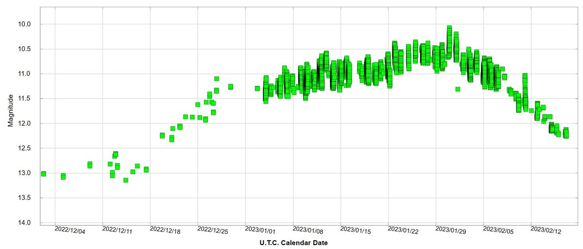

The evolution of the spectrum profile is compatible with the light curve :
Light curve of GK Per (Johnson V : green squares) (AAVSO)
