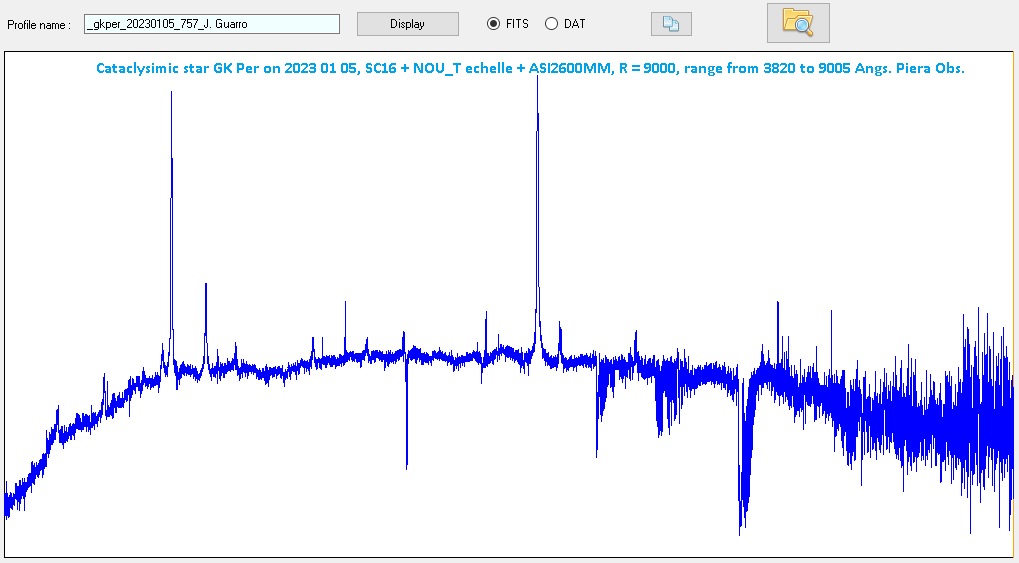

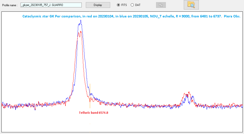

Hello everyone,
These are my first results about this interesting star.
Cheers, J. Guarro.

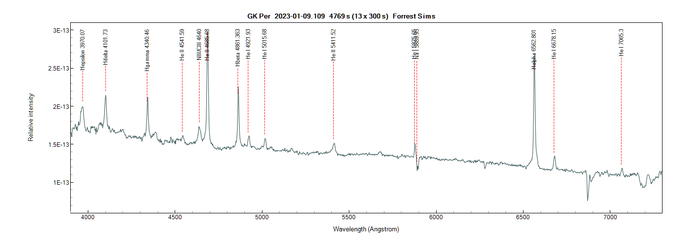

Forrest Sims
- Posts: 86
Re: GK Per Outburst

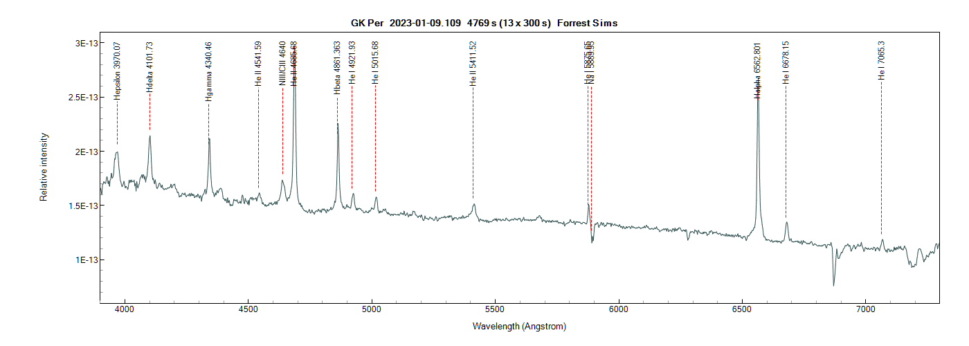

Greetings,
Here is my cropped, flux calibrated spectrum of GK Per for 2023-01-09 UT taken with a Shelyak LISA. Balmer emission lines, NIII, He II, and numerous He I lines plus the Sodium D absorption lines are all present. The blended line near 4640Å would appear to be a blend of NIII 4634.2Å and CIII at 4647Å.

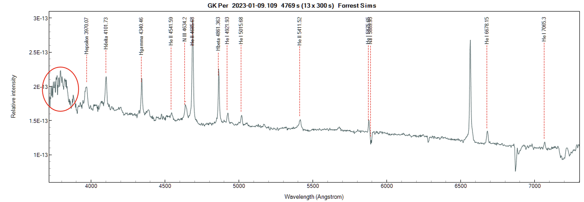

The LISA spectrograph with the Atik414ex does not have great sensitivity below about 3900Å. But this next plot shows the same spectrum, this time including the portion of the spectrum from about 3725Å to 3900Å. There is a bump (circled in red) in the spectrum centered at about 3800Å. We do not have a physical explanation. I checked and repeated the response correction with no change in the resulting "bump". Probably a combination of low signal and noise. But in the paper mentioned to me by David Boyd https://iopscience.iop.org/article/10.1 ... /6/143/pdf. in Figure 13, shows a spectrum of GK Per with a similar bump at about the same wavelength range. Interesting, but probably noise... Still it would be interesting if any of you have spectra, particularly with a different instrument that might cover some of this range below 4000Å.

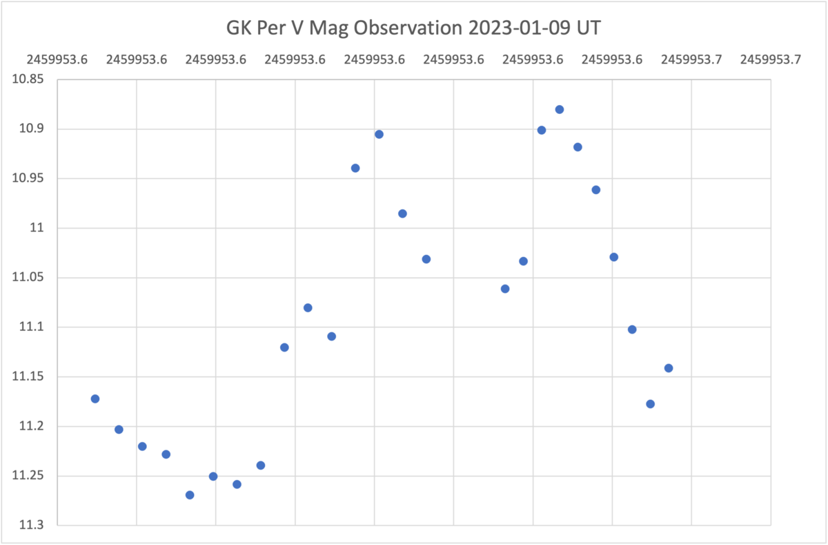

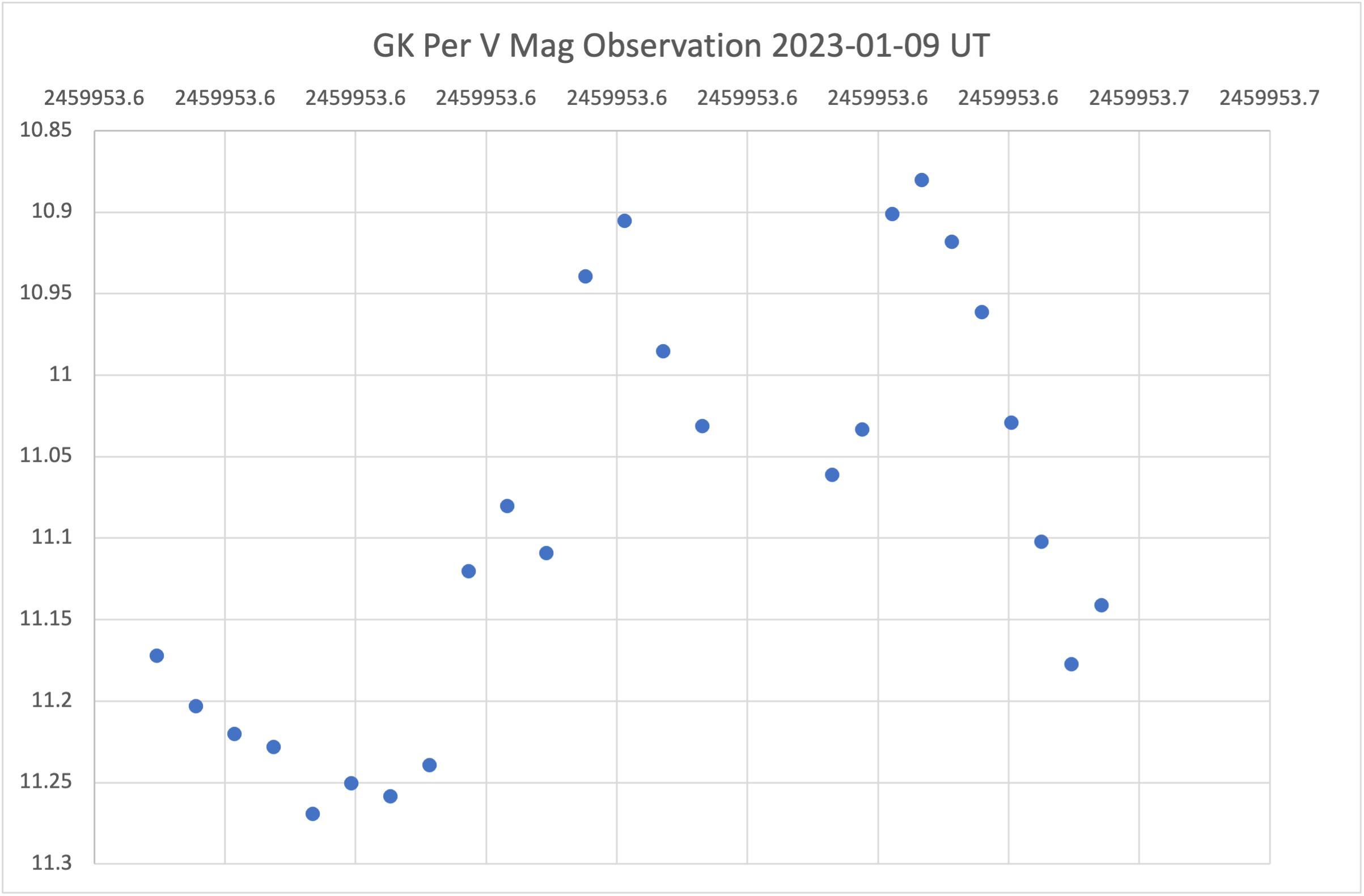

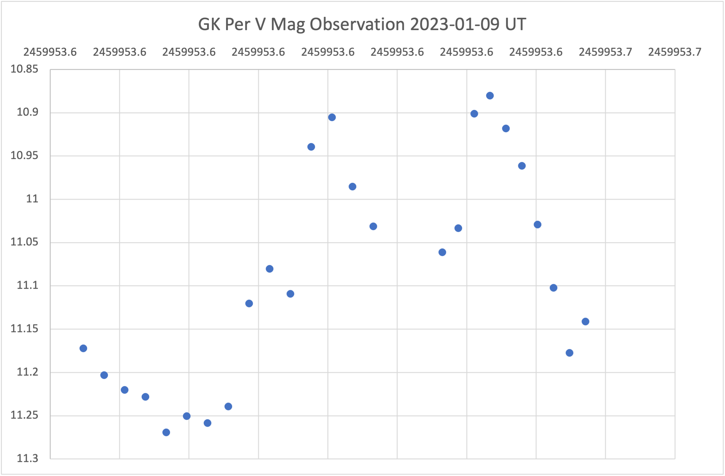

The V magnitude of GK Per was changing rapidly during the observing period is shown in the graph below.
- Posts: 1562
Re: GK Per Outburst
Nice results!
Note: the period is very close to 2 days. Thus any comparison of the spectra should take in account the orbital phase. Currently ~ 0.25 and ~0.75
(Alvarez-Hernandez+ (2021, MNRAS, 507, 5805)
Photometry:
Flickering is high (truncated accretion disk + hot spot and accretion near the magnetic poles).
BVR time series could produce interesting indices.
Woody: the "hump" showed in the paper you cite is Balmer jump. It ends near 3800.
Note: for such an object, it may be misleaded to compare SED of the continuum at different activity states (quiescence and outburst)
I suggest tracing the two spectra on the same graph.
I got a series with the T1M Epsilon at C2PU observatory with a LISA. Currently in reduction phase, I'll show the result asap (but dealing with IRAF ...)
Bonne continuation!

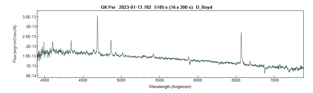

Another spectrum of GK Per taken with a LISA (R~1000) and flux calibrated using a V magnitude concurrently recorded by Franky Dubois (AAVSO AID).

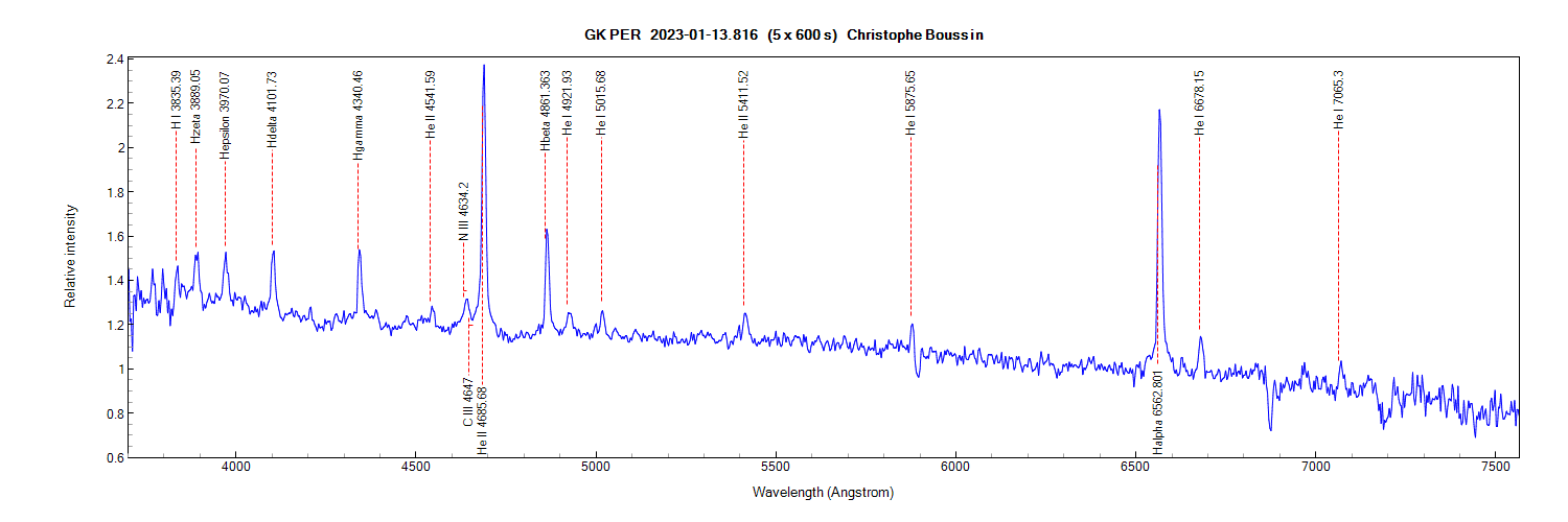

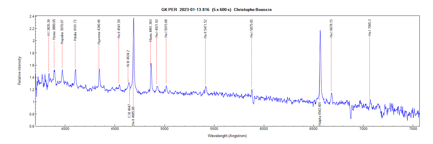

- Posts: 173
Re: GK Per Outburst
Congratulations to all the observers !!
Finally, a clear sky to observe GK Per...
The following spectrum was obtained on 13 January at 19:35 UT (resolution of 540, JJ = 2459958.3156) with my Alpy 600 and an acquisition time of 50 min (5 x 600s) :
Clear skies to all !!

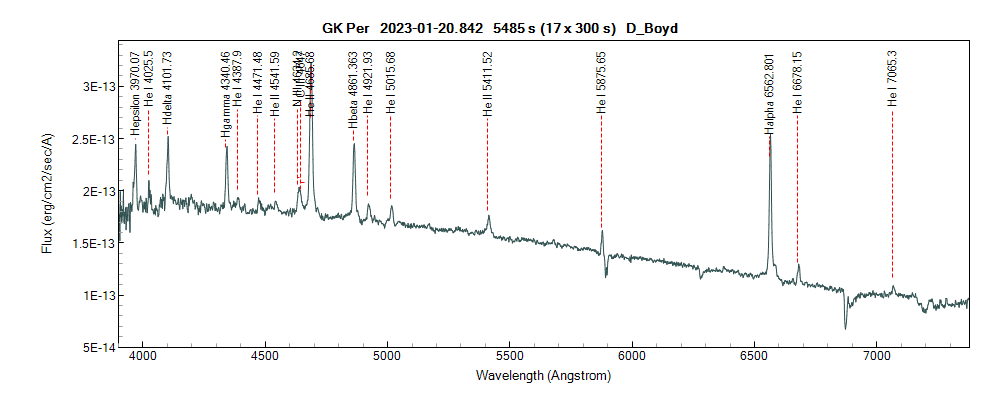

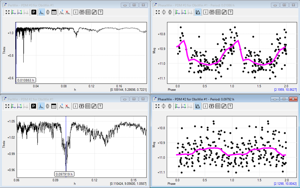

Here is another spectrum of GK Per taken on 20th January and calibrated in absolute flux using concurrently measured V magnitudes with a mean of V = 10.96.

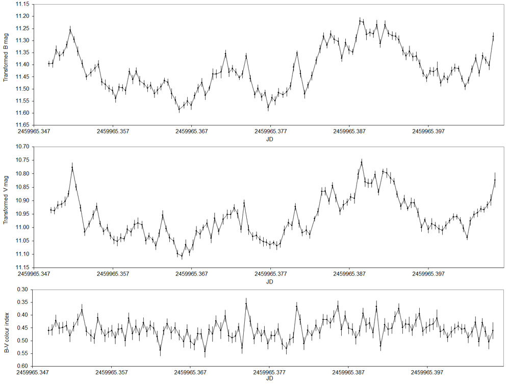

I continued to record B and V magnitudes for 1.4 hrs while recording the spectra and the resulting light curves and colour index are shown below. These show that while there are large variations in both magnitudes, presumably due to flickering(?), these are correlated and the colour remains relatively constant.
Being curious, I carried out a period analysis of the V band light curve using the PDM method in Peranso. The results are shown below. The upper pair of plots show a strong peak at 0.01086 hr = 39.1 sec with aliases. This may be a QPO in the flickering? But I was also curious about the small broad peak around 0.1 hr. The lower pair of plots show an analysis of this peak which gives a period of 0.09792 hr = 352.5 +/- 1.0 sec. A search of the literature revealed that this is the same as the WD spin period of 351 sec found in X-rays by Watson, King & Osborne (1985). I was surprised to see this signal in the V band light curve.
Hubert Boussier
- Posts: 156
- Joined: Fri Aug 17, 2012 12:55 pm
Re: GK Per Outburst
Hello David,
About the rapid variations of the B and V magnitude you underlined, you guess that it may be due to flickering, what was the time exposure you used ?
It seems yhat the B and V are more or less related so don't you think that if it was flickering the variation would be more stochastic ?
Hubert
Hubert
David Boyd
- Posts: 164
Re: GK Per Outburst
Hello Hubert,
According to Bruch, A&A, 266, 237 (1992) the mean B-V colour index of the flickering light source in GK Per is close to 0 so the B and V magnitudes should change together, subject to the stochastic variation inherent in the flickering process.
The exposures were alternately 10 sec in V and 20 sec in B. This means the interval between V measurements was close to the 39 sec signal which appeared in the power spectrum so it looks as though this may be the cause of that signal.
