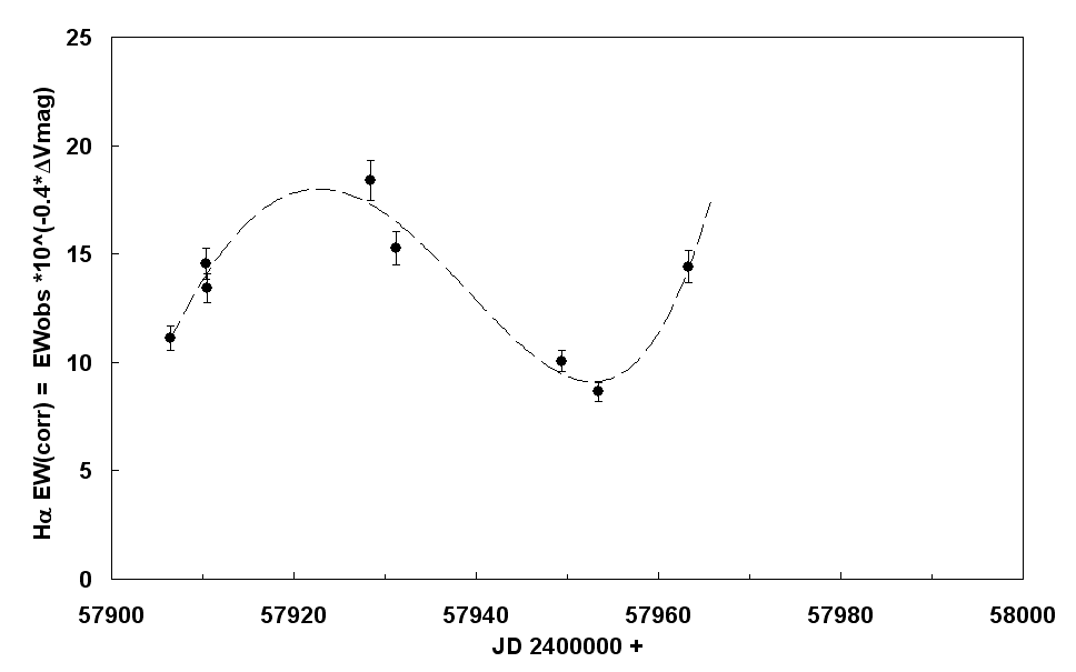

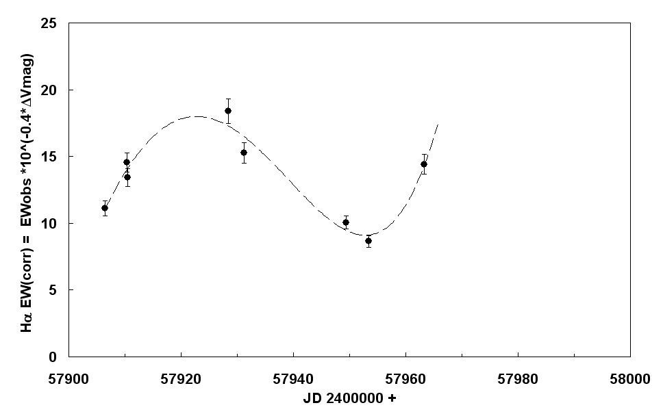

Re: VV Cep: Fe absorptions increase around Ca II doublet
Posted: Sun Aug 13, 2017 10:23 am
by Ernst Pollmann
Hi Robin & Peter,
to my surprise, the Vmag-corrected Halpha flux shows within of a comparable time window a cyclic variability with a minimum approx. to that time, which Robin emphasized (JD 2457953). See the following Fig.
Robin & Peter:
I would recommend to extend your analysis once more corresponding to the time window I am showing here.
Once more: accretion disk plus Be star disk?
When we analyze the higher Balmer lines the question is, where they have been formed? In a (fictive) Be star Kepler-disk, or in a B star accretion disk? Or both?
The velocity variations in Robin´s plots might point out to turbulences in the optic deeper zones. If we would assume, Kepler rotation within the disk(s), then we could expect variations in velocity (cyclic ?).
As Steve Shore wrote correctly:
The (emission) line formation depends on local effects and those can arise for a wide range of causes.
Ernst
