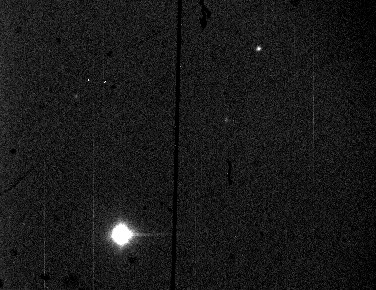

Approximative size of the hole of eshel (50 mcm) with my setup
Autoguiding RMS < 1 arcsec
So I can't get the jets shown by your image
It should be interesting to get an image with the slity aligned with the jets

Hi François, the narrow slit (31 micron) should be on the jet now (PA 35°, for the large slit observation it was at 15°).
The Doppler shift is appreciable on the 2d spectrum. The north-east "lump" is noticeably redshifted on the oxygen line.
The result:
A detail of the slit position:
Perhaps I should try with the 2400 l/mm grating to increase the spectral resolution (but I don't know if the SNR is enough). Also try to observe H-alpha line.
