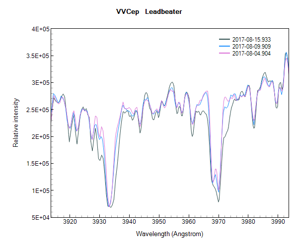

My latest spectrum shows clear broadening of the CaK (and CaH/H epsilon) lines.
This was also seen during ingress of the AZCas eclipse.
http://www.threehillsobservatory.co.uk/ ... tra_43.htm
(spectra 15,14)
The eclipse may have started. Confirming spectra needed

There has also been an increase the depth of the absorption lines at 4030/4033A (Ti??)

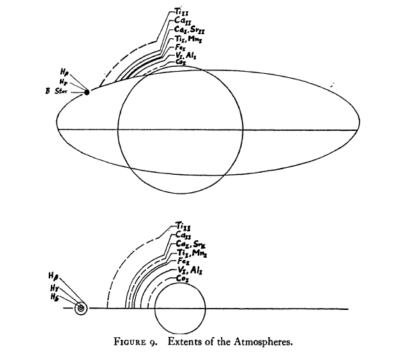

in context with your spectra a very early investigation of V. Geodecke "A Study of the Spectrum of VV Cep" (Publications of the Observatory of the University of Michigan, 1943) is helpful to read. That paper shows in Fig. 9 an instructive drawing of the location of the elements forming, within the outer atmosphere of the M super giant (depending of inclination and computed by the Gaposchkin-Method). Corresponding to that drawing (so far I understand), absorption lines of Titan seem to react first during the eclipse (Knowledge 1943).

I confirm these days the CaII 3933A blue wing show larger depth:
However, I did see a similar state on 2017-JUN-04 although not this deep.
The Ca II has always been changing heavily (so as the Balmer lines).
Interestingly, the Ti II 3900, 3913 hasn't changed for a few weeks (Ti II 3900 is contaminated with Fe I 3899.707 from the left side) whilst Fe I and the right side absorptions on my spectra (looks Ti ? - not that obvious) increasing like 5-10% every week.

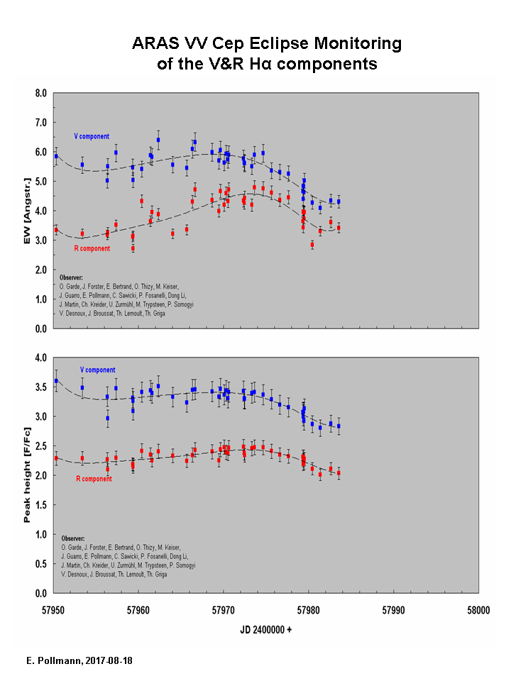

... the eclipse may have started... ??
With view on the variability of EW & PH in the attached monitoring we have to consider the following comment of Phil:
About the changing amplitude of the V component with time, I think this due to the effect of orbital motion. As eclipse approaches, the orbital motion becomes more and more tangential to our line of sight, and so the H-alpha emission peak moves more towards the systemic velocity (the radial velocity of the centre of mass of the binary system). This is because purely tangential orbital motion will have a radial velocity component close to that of the systemic velocity. Since the absorption feature (always) has a radial velocity close to systemic, what is happening is that more of the emission peak is moving into the window where the velocity is absorbed by the local circumstellar medium. That means there is less apparent change in the peak flux of the H-alpha feature: the peak flux ratio to the M star's continuum is presumably still varying as before, but the region of the peak is being absorbed by low velocity circumstellar gas.
Has the eclipse really started...??
Ernst
