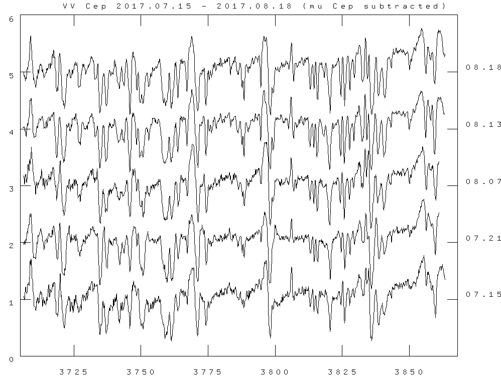

On the other hand, I've started to shoot a region 3705-3860A (can concatenate with my already published 3850-4000A) and want to follow it till I can, despite the bad SNR (half in the middle, 1/4 at left end than the CaII region). Got roughly R~3000, and calibration is more troubled (RMS around 0.010 A error, using order=4 polynom - on the contrary, 3850-4000A region has no trouble at all). But, I still consider it to be useful for the overall line identifications - especially with following the absorption changes:
In the last spectra, favouring 4 x 20 minute or even more as told it's much harder.
Mu Cep was good to remove (in this picture), though may need to rework as on the last 2 spectra it seems to be less perfect.
I'm unable to identify many of the lines, some may be FeI but seeing much more. At least, the H8 at 3797 (in the middle) seems to be more or less intact, disturbed only by 1-2 absorption lines.

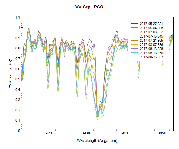

Words enough, here is the latest CaII state, central spike gets separated, and deeper absorptions seem to be permanent:
vvcep_ 20170527_031_PSO_sub.png (86.24 KiB) Viewed 180702 times

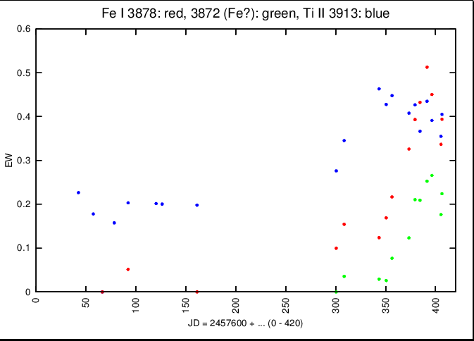

Rainy season allowed to rework my faulty calibration of the 3700-3860A covered spectra (besides processing new ones), now using the normal order=2, updated in the database by now.
As for the longterm follow of the H6+CaII (3850-4000A) region, found a method to subtract Alp Ori in a more reliable way, using the continuum slope as a property (peak at 4000A difference to a chosen continuum, more details on demand). Let me note that mu. Cep won't work, there are big differences at this resolution to Alp Ori.
This is reduction is necessary to speak about continuum in this region, allowing to provide EWs.

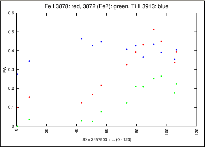

Here is what I could extract, using IRAF/splot/d (deblend) method, gaussian fit for a few selected absorptions (more features later):
and results since end of May:
The Fe I 3878 is the easiest to determine, it has reliable continuum around, visually can confirm its appearance is really starting from the end of May.
The 3872 (Fe ?) is coming up later only (2017.07.21 = JD: 2457956 visually to appear).
The Ti II 3900A is blended by Fe line, can use only 3913A - however, continuum is harder to determine here, I'd expect its EW was 0.2 all the last year. And, is definitely detached from the Fe I feature.
Last observation done on 09.09 (and 09.08 - took an experiment to see what changes in 1 day; seems H6 - and H5 - are a bit), having cloudy/rainy forecast since then.
