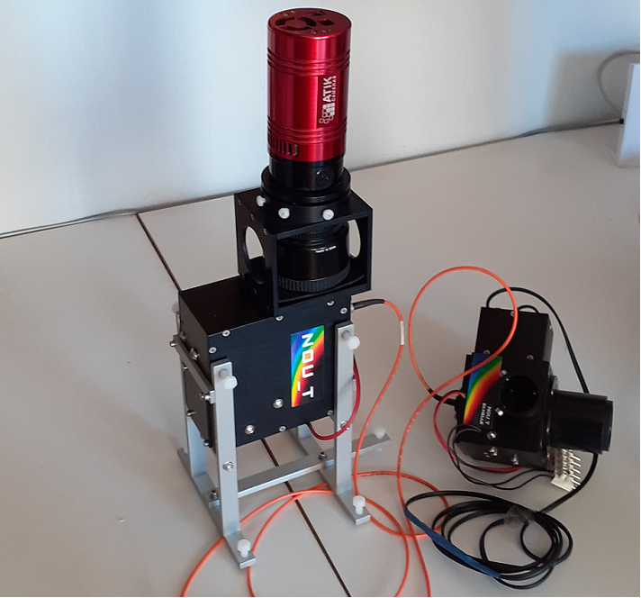

Posted: Fri Jan 07, 2022 9:58 am
by Joan Guarro Flo
NOU_T amb fibra.
NOU_T amb fibra.
NOU_T AMB FIBRA.png (812.64 KiB) Viewed 18083 times
Hello and Good New Year at all,
During these next months it's my intention mount the optics to this NOU_T  with optical fiber, in this way you can observeexoplanets and radial speeds with very high precision, on the other hand it's possible that this version lose some orders as the NOU_T without fiber.
You can see in the photo, the guide box, the orange optical fiber and the main body with a Nikon 85mm. f/1.8 objective, also there's an ATIK460EX camera, of course in this way, NOU_T permits another longer focal objectives and other camera models.  But remember the first gold rule, how all optical fiber spectrograph, it needs to a very good fiber agitator if you would likereach very nice results.
But transform the same NOU_T to from a version to other one it's only a little job, it takes only a few minutes and don't need any new collimation.
The cost of it is really affordable, I'm  trying to echelle spectrographs to be able to arrive at the most  possible people.
If you are interested in it let me know.
Best regards, J. Guarro.
