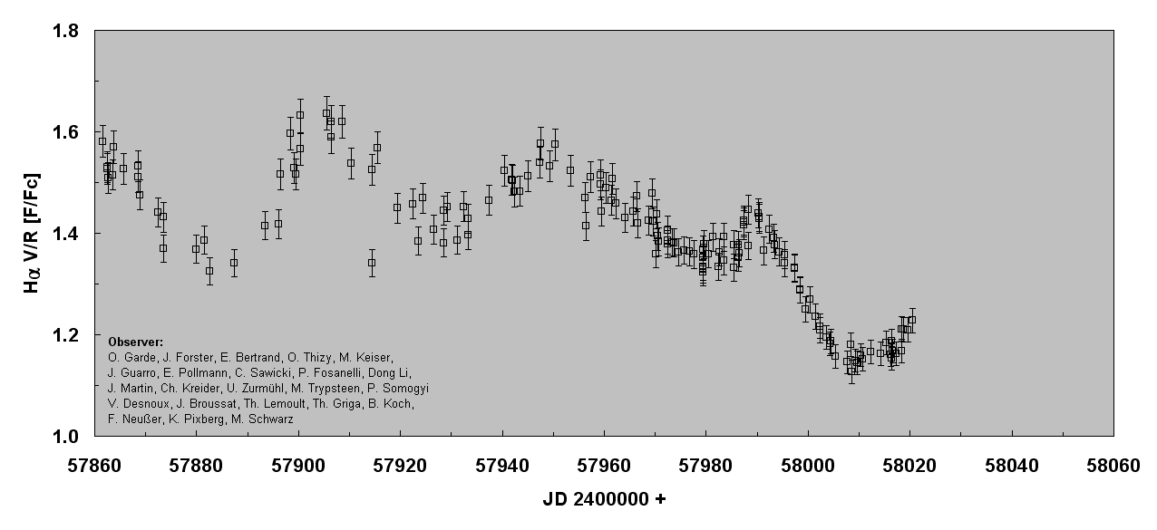

From our current observations we found the first contact approx. at end of May. That means, the second contact would be to expect then approx. on November 14. With other words, we are still in the middle of ingress. This is confirmed among others with the ARAS Hα V/R monitoring (see attachment).
That means, in our visible spectral area the B component is not hidden trough “something else”. The spectra are still determind through both components. The undisturbed observable Hα V/R ratio, which reflects the precession period of the rotation axis of the accretion disk (absolutely new and surprising in our monitoring !!), confirmes that clearly.

The inclination of the B star disc relative to the M star as seen near eclipse may not be the same from eclipse to eclipse. In the extreme, for example where the inclination of the disc was tangential to the M star edge at ingress the V/R ratio may not even change at all during ingress. The B star could even be fully eclipsed but both edges of the H alpha disc still visible. The B star photosphere is the only fixed point in this system.

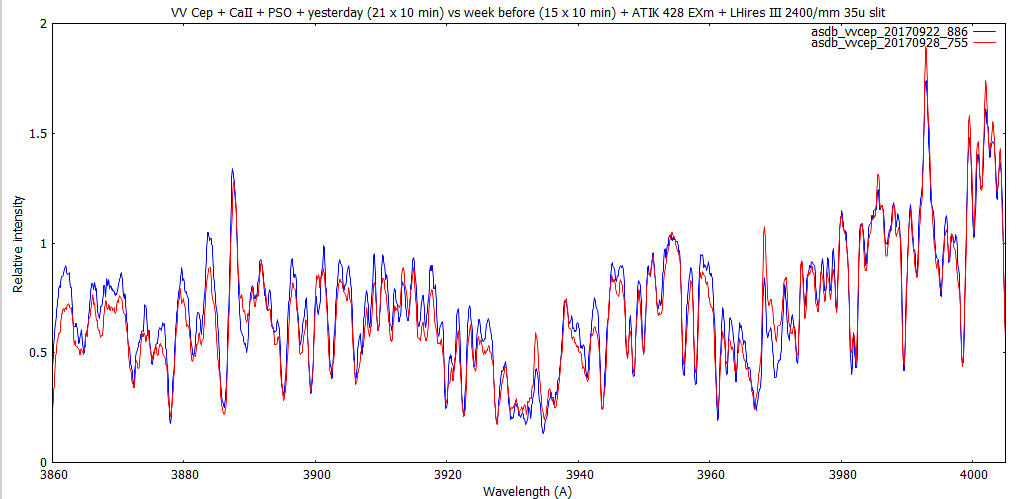

Analysing my result of 09.22 again, doublechecked validity and it's ok.
And, the earlier (till 09.09) the usual 1/5 ratio (found later better than 1/6) now on 09.22 this ratio is totally wrong, I am measuring now lika a 2:3 ratio (65.5% when rectifying to 3867.5:3870.1 and computing ratio of max[3999.5A +/- 0.2A] peak). However, subtraction result is not nice anymore. Division works a bit nicer.
What am I suspecting, the B component is partially (roughly like a 50%) glowing through a deeper layer (containing CaII) of the M component, and B is fully behind the outer layers (hence double EWs of the FeI lines). Must be quite complex to analyse, I am not getting any consumable result via subtraction anymore (since the previous at 09.09 that was still OK, ratio 1:5 worked).
That means it's yet not a total eclipse, but the deeper layer reached the B comp.
I highly recommend taking a daily Umag serie these days, using its curve drop (barycenter of a really short interval!) used to be the classic way to define the "eclipse" start (again, now I can imagine we are only seeing through a deeper layer partially + external layer fully, so that it's not a solid obstruction).
As for the H-alpha R/V graph, till those periodic variations not subtracted reliably (O-C ?), having those variations on top I can't read anything off from that graph even when I'd believe in its accuracy (something only a professional could tell us about).
The so-called violett-to-red ratio V/R does have its roots in the basic research of Be stars during 1991-98, mainly performed by R. W. Hanuschik and A. T. Okazaki. In order to understand what V/R really means, I highly recommend the study of following literature:

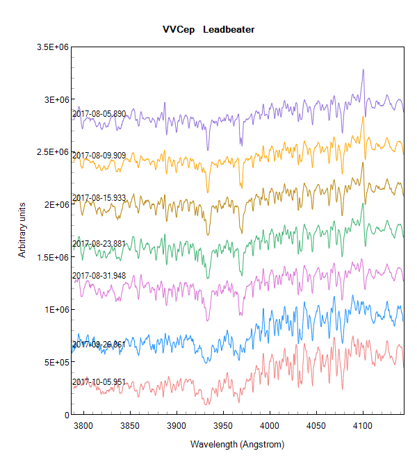

Attached are a series of spectra of VV Cep covering 3800-4150A at R ~2500 (variable 3000-1500 across the range due to LHIRES chromatism)
Note the loss of H Balmer emission, broadening of the Ca II H K lines and relative drop in continuum flux below ~4000A, particularly noticeable in the latest spectrum recorded 2017-09-26

Fresh result from yesterday:
No relevant change since last week's surpise, some ref. star problem during the 3.5 hours might have caused a global continum shift.
H6 and H5 (H5 is almost together with CaII, as usual) along with the CaII central emissions are visible at this resolution, their origin is probably from the surrounding nebula, basically these features must be known.
- Peter

Posted: Fri Oct 06, 2017 10:39 pm
Attached is an updated series including my latest observation 2017-10-05. There has been no significant further change in the past 9 days. The ingress phase now appears to be complete at this wavelength.
