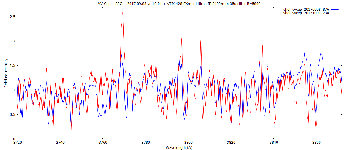

Based on Robin's observation + and BAV homepage 1.5-1.7 Umag drop has just happened as in the past, light from the B component must be mostly out for now (yet to wait for making sure there is no more drop).
However, let me remind everyone, then we are now in a critical phase for the higher Balmer lines - as I've taken my lower UV region, Balmer is still there, suspectedly some parts still coming from the remaining internal part of an internal disk:
(Could not subtract M component yet for this region, need to wait till Alp Ori is up. Have Mu. Cep that is too far from perfect to subtract at this higher ratio.)
If our speculation is right and an internal disk exists with the high Balmer lines, we should see now how the above H14-H9 lines get "switched off" week by week!
As I've looked through the literature, no other known emission exist this region than 3806 [Cu II] (+ Balmer), so I expect the outstanding emission at H11 is really from H11.
Unfortunately, weather is poor here, but now I'd chose this region to follow next.

Status of Balmer changes in the UV end:
It is surprising to see V/R variations and both wings up - it contradicts with the theory that it's from a B component's disk, whilst the B core by now is obviously in eclipse.
I did take a CaII region again on 2017.10.15, and it perfectly matches with the state of 2017.09.22 (= my 1st detection of eclipse event).
Sent all to the database.

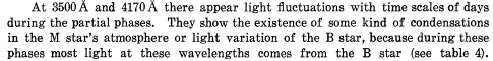

by Ernst Pollmann
Hi Peter,
you wrote:
… it contradicts with the theory that it's from a B component's disk…
M. Saito et al. wrote in Publ. Astron. Soc. Japan 32, (1980):
If we take into account that kind of possible variabilities of the M star, then the variations in your spectra does not contradict at all the "theory of the disk variability". Also the frequency of your measurements is to low to claim that.
Best wishes,
Ernst

Hi Ernst,
Thank you for looking at it! Actually I don't contradict to your theory here:
"...then the variations in your spectra does not contradict at all the "theory of the disk variability""
To be more precise, my statement is: my spectra show contradiction with a possibility, that the most of H11 would come from a B disk's emission. (Same applies to H10.)
Because if it would, we wouldn't see both R and V wings still prominent, once after B went into eclipse:
It is enough to know that the continuum part from B component dropped by 1.5 mag by now (see the already available Umag series) whilst M / B component ratio in this region was like 1/6 before the 1st contact, nowadays it should be like 1:1 very roughly (lower region, that's why not 1:2 that I measured for CaII). Some little continuum variation doesn't matter.
If H11 was mostly coming from a B star's disk, then both of its R and V wings should have been decreased a lot (as M continuum is coming up by a 2.5x factor), together with the B continuum.
The contrary has happened, V wing doubled and R wing remained prominent (see my graph above), well explainable by an external source (external from B), with a time coincidence by the eclipse event.
And, my +1 extra statement that it does have its own R/V variation - time is resolution is irrelevant here, I am not stating exactly what kind of variation it is or what's the period (still would be interesting to correlate the EWs with H-alpha). It is just rotating, that's clear to see.
Of course, some of the H-alpha variability (little or large portion: ?) may still be coming from a B star's disk. But, mostly not the H10-11.

Re: VV Cep: Fe absorptions increase around Ca II doublet
Posted: Tue Nov 21, 2017 8:30 pm
by Peter Somogyi
I think we can start collecting the T2 times of different Balmer lines - except H-alpha that possibly yet needs to be waited to finish its variations (if it will).
Balmer lines we observed as disappeared so far:
H8: disappeared between Oct.24 - Nov.06 (should be closer to 10.24), see: http://www.spectro-aras.com/forum/viewt ... t=30#p9668
H-beta around Nov.18 (thanks for Hugh), as per http://www.spectro-aras.com/forum/viewt ... t=20#p9747
And, here is the H12-H9 region, having Alp Ori 1:1 subtracted (normalised for 3780-3785) and +0.5 value added for PlotSpectra, showing my serie and last 2 ones from James Foster + my last on Nov.03:
We are setting scope and spectroscope focus on H11-H9, edges have either lack of signal and/or wavelength calibration may get inaccurate.
And, I think H11/H10 was settled already on Nov.03 (+2 spectra by James confirming).
James doing different flat handling (internal lamp whilst I use an UV lamp) hence I suspect a hole difference at 3790A, and I was dividing his spectra by a low order spline fitting to my curvature on 11.03.
One thing to note, H11 (and maybe H10) show constant emission, falling out of the rule of thumb that only H-alpha would remain.
- Peter
