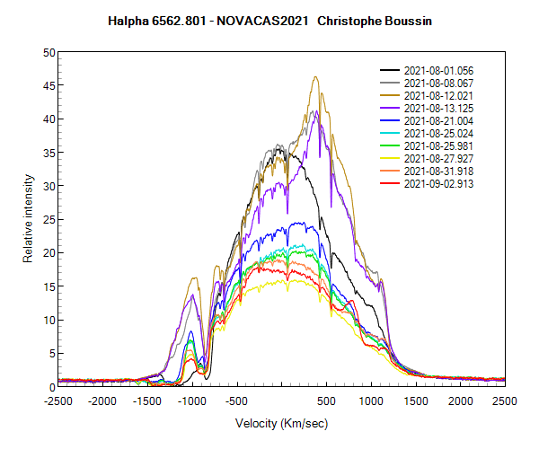

So, here is my new comparison between my two last spectra of the Halpha line of Nova Cas 2021 at high resolution on August 31 at 22 h 02 TU (resolution of 19064, JJ = 2459458.4182, 9 x 600s) and on September 2 at 21 h 55 TU (resolution of 18580, JJ = 2459460.4134, 12 x 600s) obtained with my LHIRES III (grating of 2400 lines / mm) and the previous ones in August :
Halpha line of Nova Cas 2021 on August 1st, 8th, 12th, 13th, 21th, 25th, 27th, 31th and on September 2nd 2021
novacas2021_20210902_Halpha_Christophe Boussin.png (60.66 KiB) Viewed 17624 times

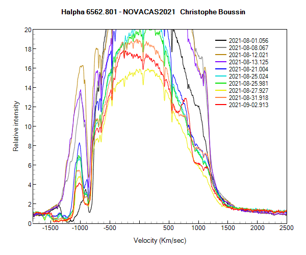

Since August 31, a peak located at + 785 km/s emerges on the profile of the Halpha line (it seems to be already visible on the spectrum of August 27).
On the spectrum of September 2, the evolution of the peak is particularly obvious !

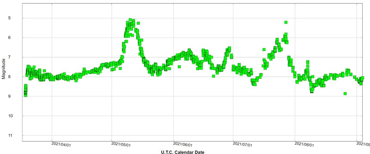

Yes, the brightness of the Nova is increasing again and it seems that a new maximum is for very soon !
Light curve of the Nova CAS 2021 (AAVSO)
I obtained a new high resolution spectrum of the Halpha line on September 9 at 21 h 00 TU (resolution of 18373, JJ = 2459467.3754, 7 x 600s) with my LHIRES III (grating of 2400 lines / mm) and, according to the AAVSO, the magnitude of Nova Cas 2021 was about 6.5 at that time !
