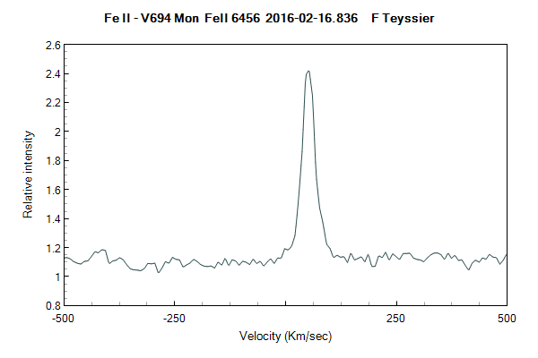

Only the *emission* component of metal lines - Fe, Ti, Mg ... - have a low FWHM (about 20 km/s, 40 km/s with a broader pesdestrial for Fe II (42) multiplet) and are considered to be produced essentially in the accretion disk, the nebula anf jet near the hot component of the sytem.
The absorption is mainly produced in the jet itself
Here's for instance Fe II 6456 in a spectrum obtained last year
FWHM = 35 km/s
v694mon_ 20160216_836_fteyssier.png (13.6 KiB) Viewed 20743 times

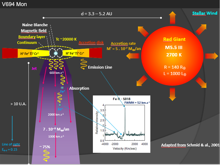

Following new questions, here's a model adapted from Schmid & al.
See also Shore & al. 1994, Tomov, 1992, 1997
The wind from the red giant (sollar type matter) forms an accretion disk around the magnetic white dwarf of low luminosity
The magnetic field acts as an propeller to form the jet
The boundary layer, the viscosity of the disk heat the upper layers of the disk at about 20 000 K which provoques ionisation (low ) of H and metals, essentially one time ionised

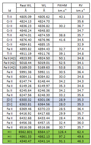

The narrow emission lines of hydrogen and ionised metals (Fe II, Ti II, Cr II, Si II ..) are emitted from a large part of the disk. These are narrow lines. From a spectrum obtained two days ago, I get FWHM of 30-35 km/s for most of the lines. Only Fe II 42 multiplet gives broader lines (50 km/s).
The jets is formed by the solar ionised matter (at least at the begining). The recombination time is long.
So the ions can absorbe the photons of the continuum at the blue shift wavelenght produced by their velocity. This is the reason why the absortions are much wider than the emission. They are not formed in the some region of the sytem.
For Fe II (42) about 25% of the photons of the continuum are absorbed. While HI can absorbed about 75% of the photons due to its higher column density.
Here's the measures of a few lines that I obtained with the excellent Tim Lester's PlotSpectra

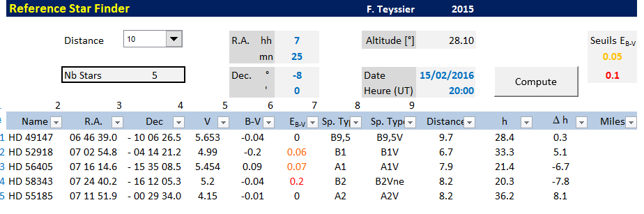

Effectivement, la correction atmosphérique n'est pas bonne. Voir les derniers spectres obtenus par David et Woody:http://www.astrosurf.com/aras/Aras_Data ... 694Mon.htm
pas facile de trouver une bonne étoile de référence dans cette région
del Mon est brillante, mais un peu trop haute. Son spectre peut être obtenu avant V694 Mon de façon à faire coïncider les hauteurs
voir aussi HD 49147

Merci François. Le spreadsheet ReferenceStarFinder sera très util. Je n'ai pas traité ce specturm avec ISIS et je pense que la réponse instrumentale n'était pas correcte. J'ai essayé encore et bien que la réponse soit meilleure, je ne pense pas que cela corresponde parfaitement à la référence A0V.
