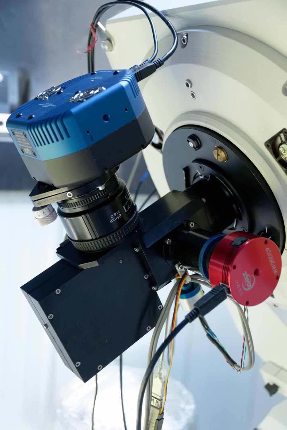

I have just acquired my first "real" spectrum with my new home built echelle spectrograph.
The conditions were not good. Clouds interfered with all the integrations but I am very pleased regardless.
The instrument is not fiber coupled but is rigidly built and I will be making a tightly fitted foam enclosure so that I can control its temperature.
So far indications are that flexure will not be a problem (but it is early days). Here is a picture of it mounted on the telescope.

Posted: Fri Jun 16, 2017 9:05 am
by Andrew Smith
Very impressive Tim. Could you post some information on the design?
Regards Andrew
Posted: Fri Jun 16, 2017 1:23 pm
Yes, impressive!
Good resolution, good SNR
Congratulations, Tim

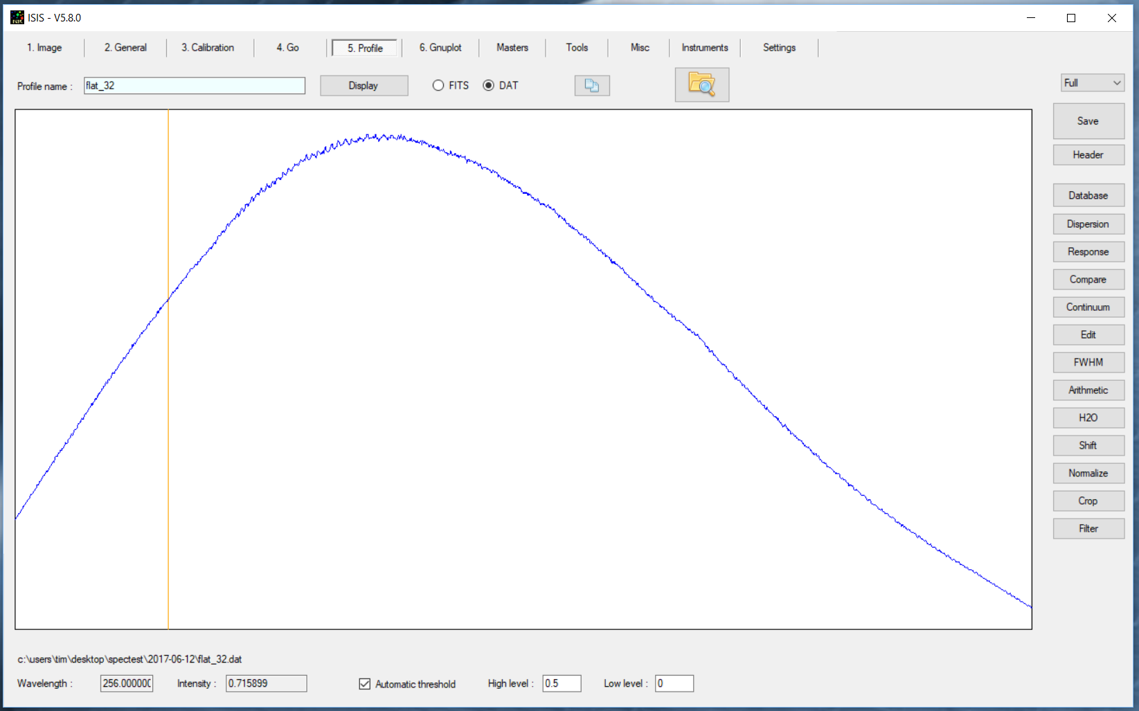

However it is another story for the tungsten flats.
Here is the profile for my flat in order 32. Notice the increased noise near the peak of the blaze, right where you would expect less noise!
If I generate a profile in MaximDL from the straightened image of the flat for order 32 it is smooth, as it should be.
However, If I narrow the zone over which MaximDL averages then the profile starts to look like it does in ISIS.
I believe this shows that Isis is not quite capturing the whole 75um line width. This makes sense as ISIS was designed with a 50um fiber in mind.
This problem does not impact the star spectra directly because the gausian star profile has fallen off significantly towards the ends of the short slit.
It does, however, affect the accuracy of the blaze function that is generated from the tungsten flats.
Christian - if you are reading this I would be very grateful if you could add to ISIS an option to specify a slightly wider zone over which to integrate. :idea: ;) :D

Posted: Sat Jun 17, 2017 11:54 pm
Hi Tim,
Thanks for the answer.
About flat ripple, did you try to adjust the binning width adjustment option ?
Posted: Sun Jun 18, 2017 2:56 am
by Tim Lester
Thanks for your quick reply Christian.
I had not fully appreciated what the binning width was but I had set it to 12 which should be a good value in my case.
Looking at the flat images the smallest binning width that would capture everything is about 8 and 20 would start to include the orders on either side (for order 32).
I have tried all values from 8 to 20 and nothing changes. Interestingly order 29 is smooth as are all the orders above 35. The flat plots for the problem orders 30 - 35 do not change at all with binning width. The matching MaximDL profiles generated from the flat images are all smooth.
I tried using an artificial perfectly uniform PRNU file in case a bad PRNU was the problem but that wasn't it.
What next? This is a little troubling. I have uploaded my working directory here if you would like to take a look: https://1drv.ms/f/s!AvXqhKI5kEGRkQbnMJRnLH8EYZyz
