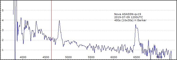

Posted: Wed Jul 10, 2019 11:13 am
by Hamish Barker
nice one terry. What software do you process with? I'm interested to make the erg/cm2/s flux calibration but have not got that far yet.
Here's mine from about the same time. ( my camera date was set wrong but it was about midnight here so I'll say 1200UTC.
I got a much better reference spectrum using beta carina. Maybe a few degrees lower but at least nice and bright and plenty of balmer lines so a better calibration. I'm pretty new to this so forgive the poor quality. i guess even rough data is better than no data.
Should I filter since I am oversampling anyway? I guess I should just bin more to reduce the noise, since seeing and chromatic loss of focus due to the converging beam is anyway limiting my resolution. Or it is better to leave the data as-is?
