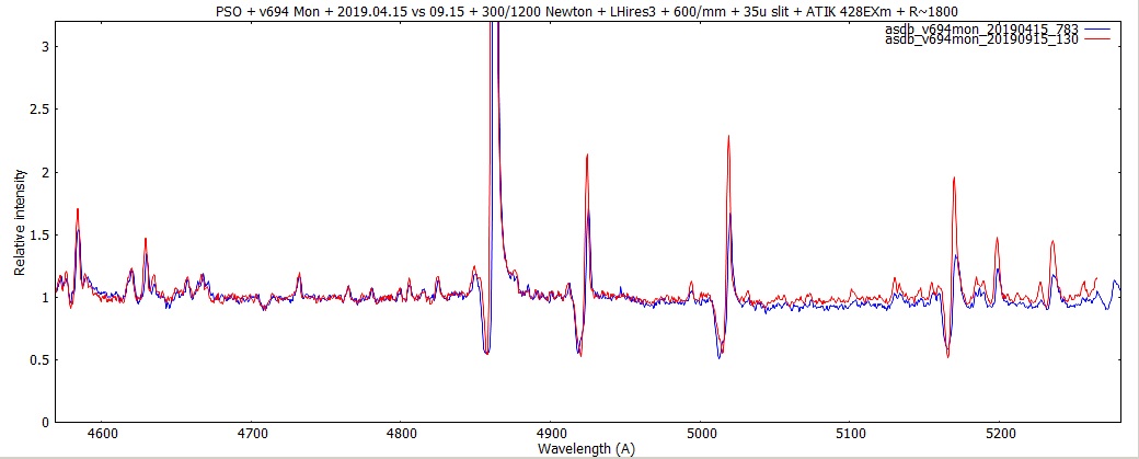

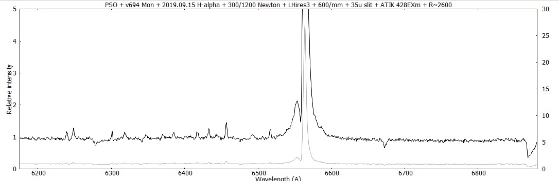

Fresh results from this morning:
After shooting H-beta (2 x 600 sec), quickly switched to the H-alpha region (1 x 600 sec, sun background could be substracted easily):
It looks to be continuing in similar state as this year spring.

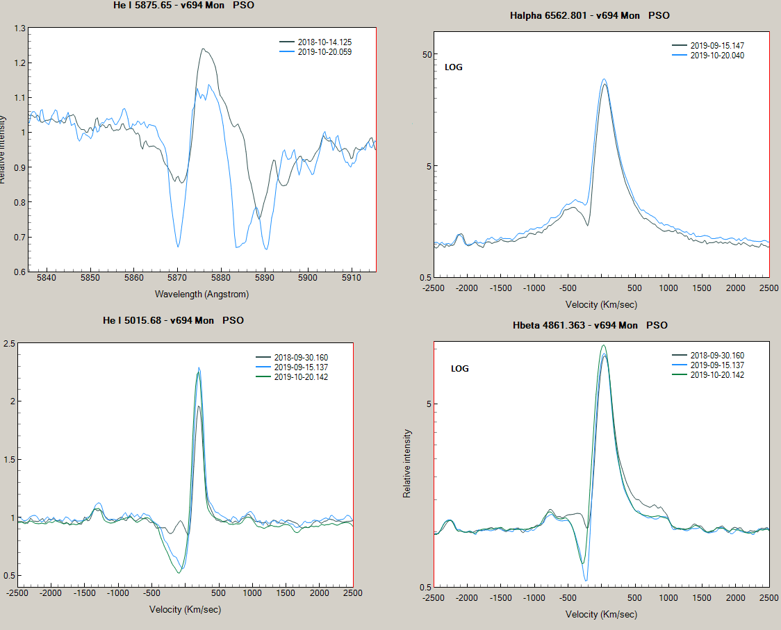

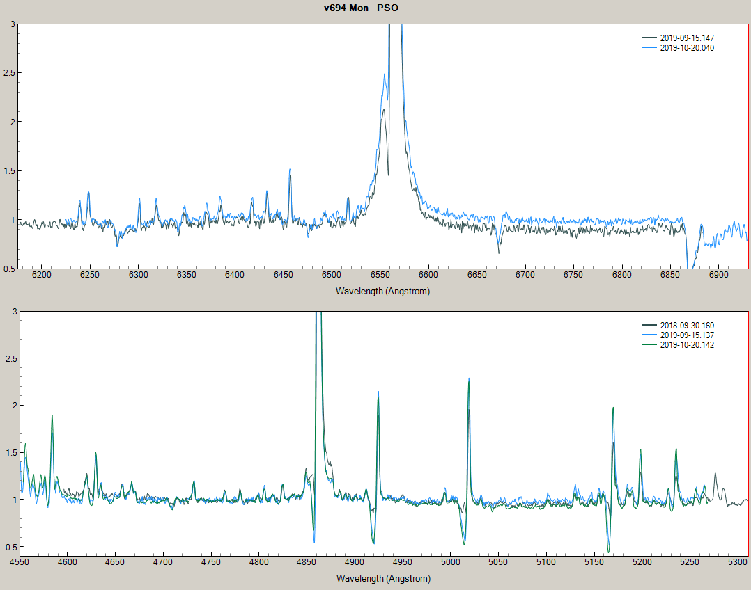

2019.10.20 morning, with LHires III + 600/mm + 35 micron slit + ATIK 428 + 300/1200 Newton (+ APM 2.67x barlow), variable sky:
- H-alpha @ R~2500
- He/Ne (~5800A) region @ R~2000=
- H-beta @ R~1800
Not much change within a month at this resolution, except H-alpha changed somewhat:
graphs produced with PlotSpectra
Velocity view (Balmer - logarithmic):
Beware, colors not maching across graphs! (noticed later)
All intensities are relative, no flux.
Next switching to 2400/mm grating (allows H-alpha @ R~13000, or H-beta @ R~8500 with wider coverage).
Being on vacation next week + weather looks promising, so planning repeats on workdays.

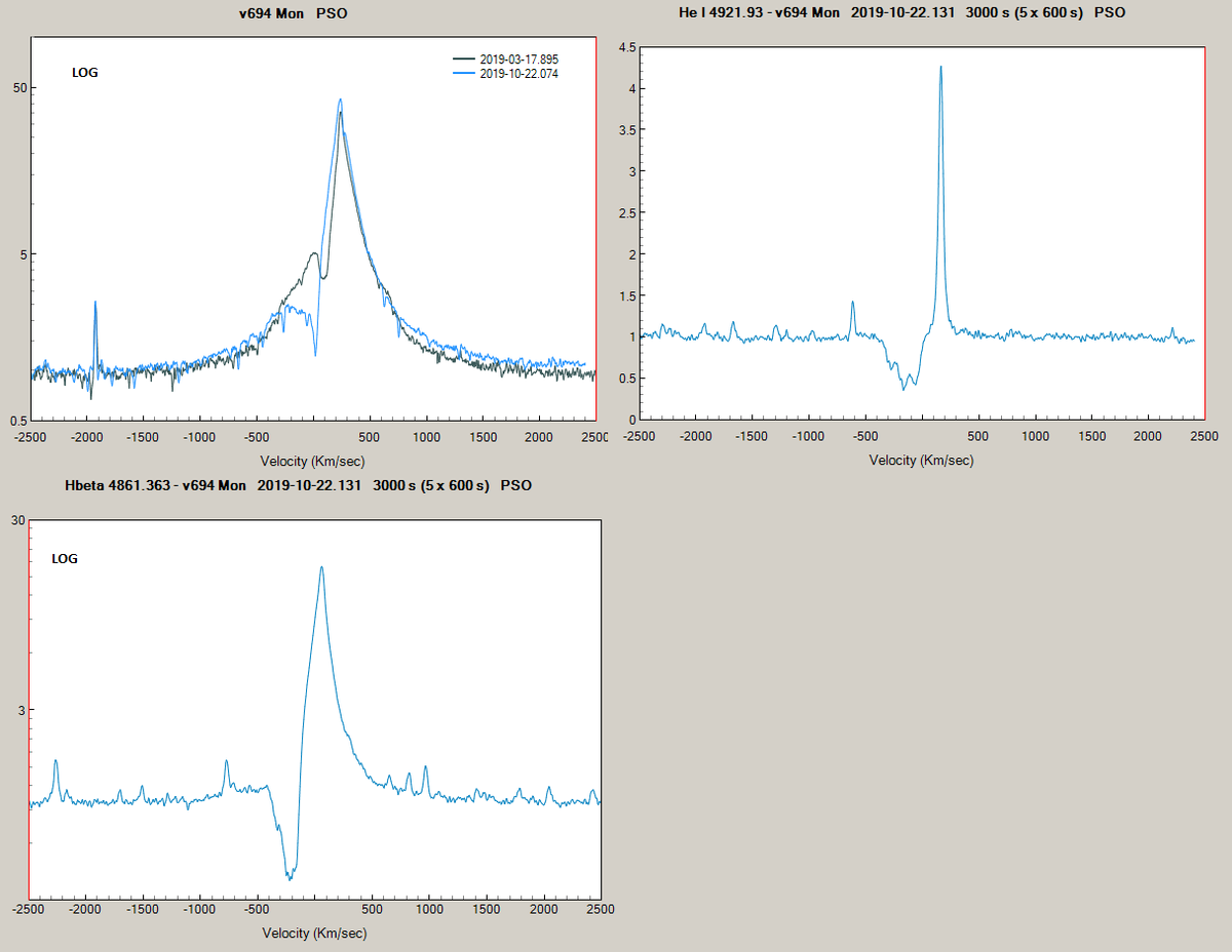

Fresh spectra from this morning, having switched to 2400/mm grating:
- 4 x 20 min. H-alpha (R ~ 15000, 6500 - 6610A)
- 5 x 10 min. H-beta (R ~ 9000, 4817 - 4961A), includes Fe I emissions + He I 4922 absorption
Velocity plot (the H-alpha is comparative to half year before):
generated via PlotSpectra + Paint (cut & paste screen capture)

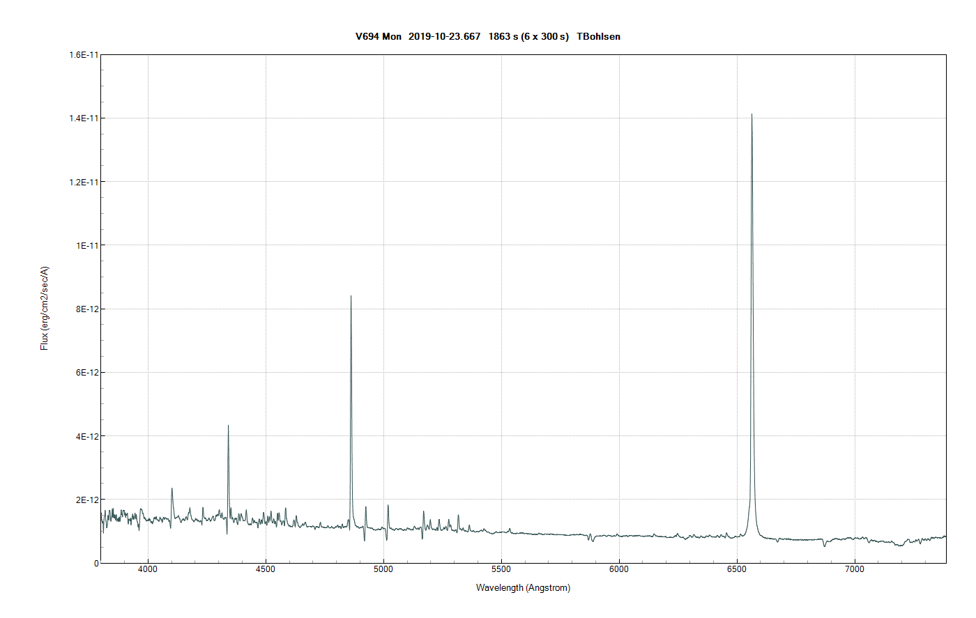

I also succeeded in taking spectra of this star last night.
Similar to Forrest's data.
