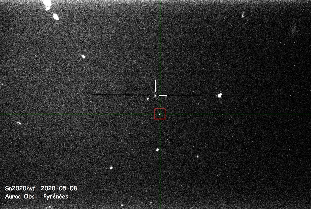

Many thanks for your alert and your are right: Sn bright enough now to get my Alpy out on this target. I estimate more a Mag between 13 and 14 but I haven't calculate it yet, by comparison with the bright star just beside.

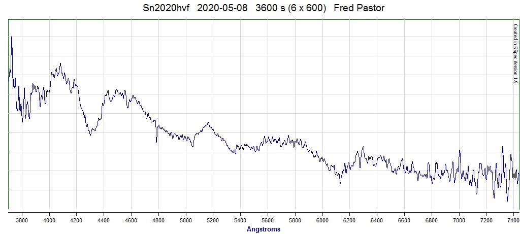

Below my contribution, I tried to push further until one hour exposure:
Sn
Sn
rspec Sn2020hvf 08 05 2020.jpg (81.75 KiB) Viewed 14188 times
guidage
guidage
Fred

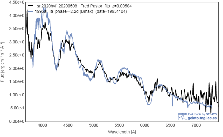

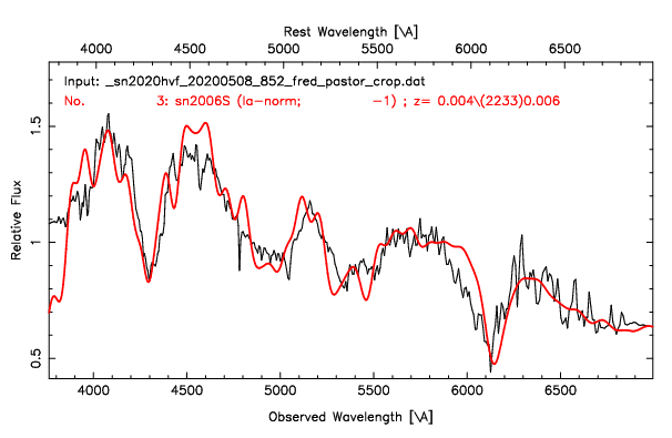

SNID gives a good fit to your spectrum for several type Ia near maximum. Here is a typical one. (The supernova was very young when I measured it. Perhaps SNID/GELATO do not have enough examples of young supernovae to compare with)
Re: another potentially bright supernova 2020hvf in NGC 3643
Posted: Mon May 11, 2020 11:48 am
by Frederic Pastor
Hi Robin,
SNID fitting is very interesting, and encouraging. To complete your matching, I may add that the SN1995al also fit perfectly this young 2020hvf, confirming a phase of -2.2 days and the type Ia :
Sn1995al
Sn1995al

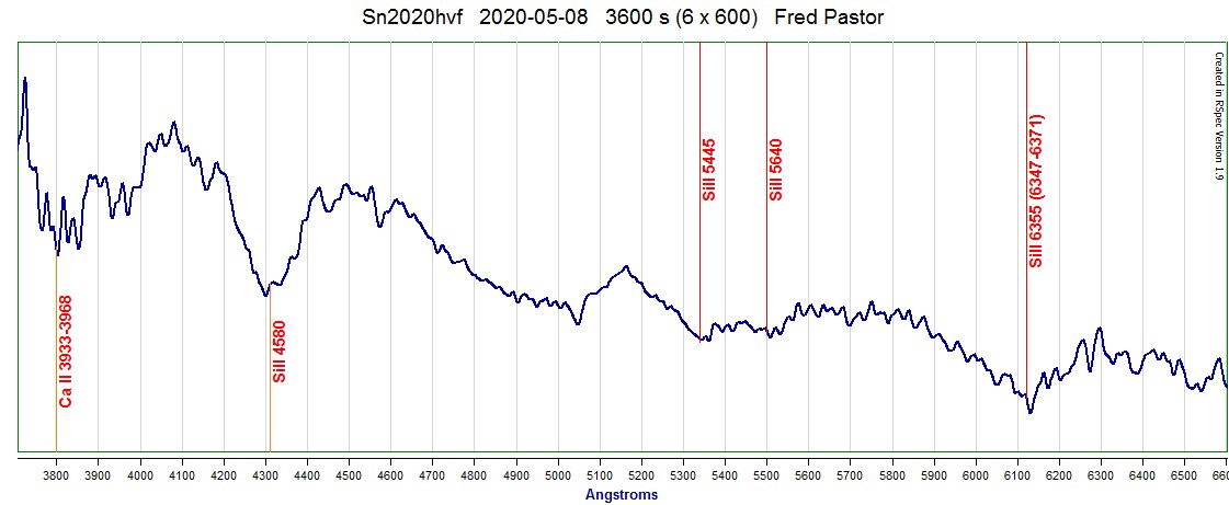

I have filtered a bit my spectrum to get it more smooth. And tried to find some Calcium and Silicium lines, as a first approach of understanding. Wasn't that easy in such a turbulent object. Do not hesitate to give your opinion :D
sn filtered
sn filtered
Sn2020hvf wavelenght.jpg (91.33 KiB) Viewed 13981 times

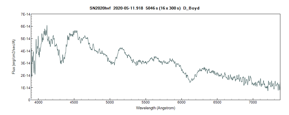

by David Boyd
This spectrum of type 1a supernova SN2020hvf was taken with a LISA spectrograph (R~1100) on a C11 and has been calibrated in absolute flux using a V magnitude of V=12.67 measured concurrently with the spectrum using another scope. The spectrum has been smoothed with a Gaussian factor 2.5.
The blue-shifted location at 6118A of the prominent Si II 6355A absorption feature indicates an expansion velocity of ~11,200 km/s.
