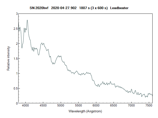

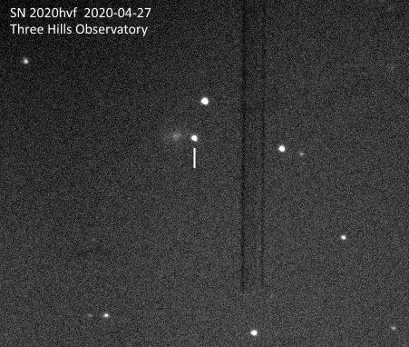

This supernova is now much brighter (mag 14 on 2020-04-27).
Here is the spectrum with the ALPY200 but it is bright enough now for any low resolution spectrograph
Although it is officially classified as a type Ia it is peculiar and does not give a good match in either GELATO or SNID.
- sn2020hvf_20200427_902_Leadbeater.png (19.06 KiB) Viewed 14653 times

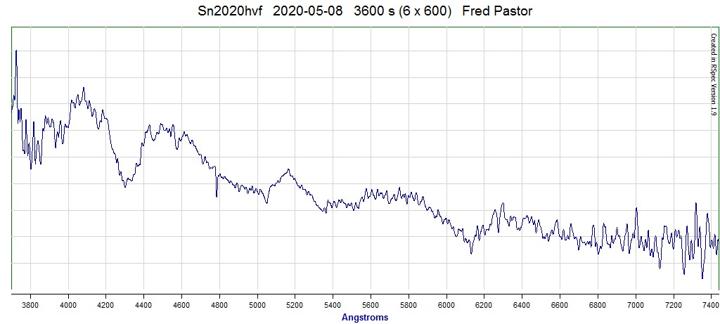

Many thanks for your alert and your are right: Sn bright enough now to get my Alpy out on this target. I estimate more a Mag between 13 and 14 but I haven't calculate it yet, by comparison with the bright star just beside.
Below my contribution, I tried to push further until one hour exposure:
Fred
Fred

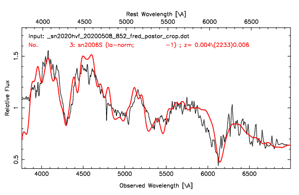

Re: another potentially bright supernova 2020hvf in NGC 3643
Thanks Fred,Frederic Pastor wrote:Many thanks Robin.
I have just sent to you my FITS file on your email adress.
Cheers.
Fred
SNID gives a good fit to your spectrum for several type Ia near maximum. Here is a typical one. (The supernova was very young when I measured it. Perhaps SNID/GELATO do not have enough examples of young supernovae to compare with)

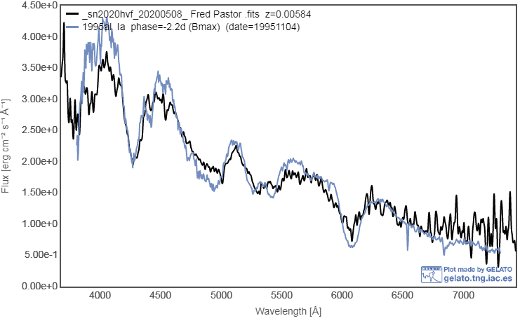

Hi Robin,
SNID fitting is very interesting, and encouraging. To complete your matching, I may add that the SN1995al also fit perfectly this young 2020hvf, confirming a phase of -2.2 days and the type Ia :

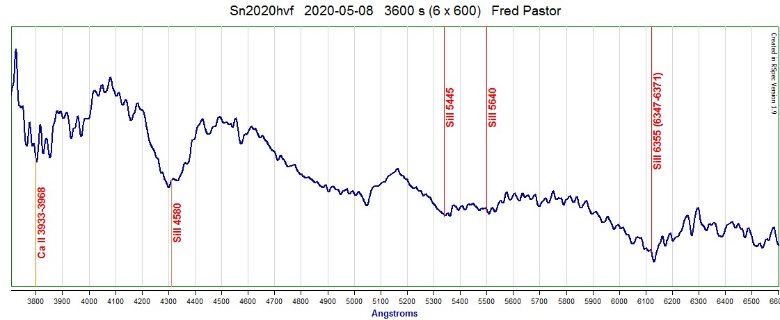

I have filtered a bit my spectrum to get it more smooth. And tried to find some Calcium and Silicium lines, as a first approach of understanding. Wasn't that easy in such a turbulent object. Do not hesitate to give your opinion
Fred
Fred

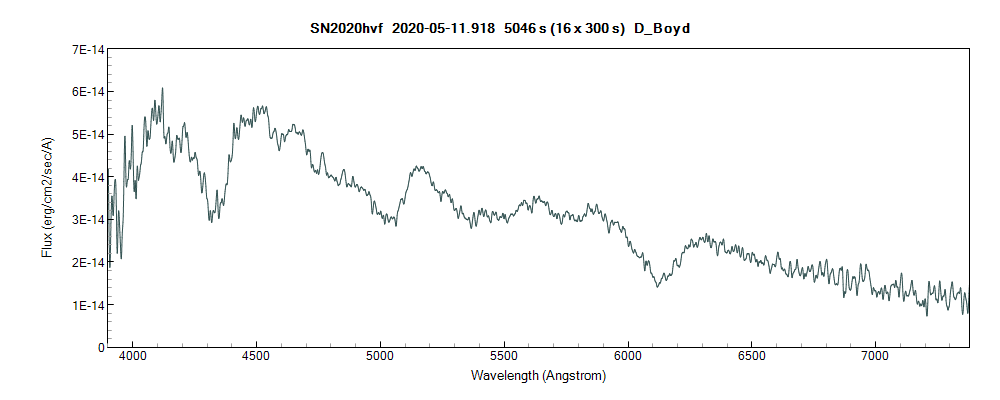

This spectrum of type 1a supernova SN2020hvf was taken with a LISA spectrograph (R~1100) on a C11 and has been calibrated in absolute flux using a V magnitude of V=12.67 measured concurrently with the spectrum using another scope. The spectrum has been smoothed with a Gaussian factor 2.5.
The blue-shifted location at 6118A of the prominent Si II 6355A absorption feature indicates an expansion velocity of ~11,200 km/s.

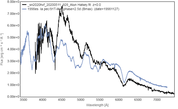

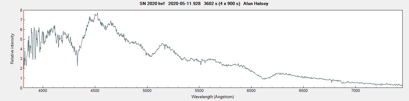

This is my very first attempt at capturing spectra of a supernova,this was taken on the night of 11/12th using ALPY 600,SX TRIUS 825 on a C9.25 with 6.3x reducer. 4x900sec calibrated using Ar/Neon lamp in calibration module. Also signed up to Gelato this evening and received this result of 100% type la
Alun
Alun
- gelatoplot.png (51.88 KiB) Viewed 13819 times

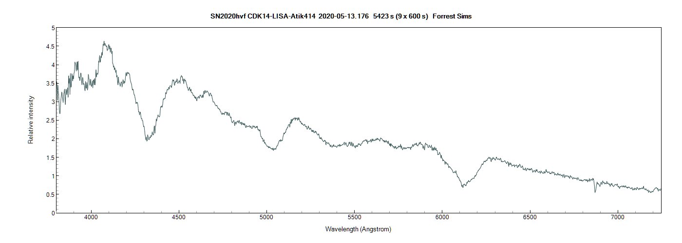

Thanks Robin for the alert on this SN.
Here is what it looks like 2 days later. This spectrum includes (9) 600sec exposures while guiding with the target on the slit. (I did manage to simultaneously acquire narrowband filter data but have not had time to assemble an ensemble as it were to do the photometry and therefore flux calibrate this spectrum.)
Woody Sims
Woody Sims
