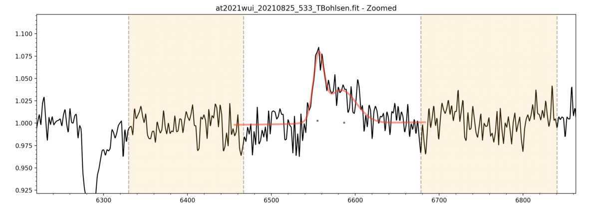

I’ve had a quick look to your [HB Note: Angel was actually looking at Terry Bohlsen's] spectra: it’s definitely H-alpha and very probably [N II] 6583 in emission, likely each line has at least a couple of components (but the resolution of your spectra does not allow to check that, you need high resolution).
Here is the screenshot of my quick check, and the results of a double Gaussian fit:
Gaussian fit 1: SNR = 16.13 RMS = 3.440e-02 center = 6556.293 ± 0.344 flux = 1.056 ± 0.065 EW = -1.06 ± 0.07 FWHM = 14.60 ± 1.14 A = 667.8 ± 52.1 km/s
Gaussian fit 2: SNR = 11.58 RMS = 1.248e-01 center = 6583.134 ± 2.060 flux = 1.677 ± 0.145 EW = -1.68 ± 0.14 FWHM = 42.36 ± 4.39 A = 1937.2 ±200.7 km/s
The broad of the emission lines, particularly the [N II] 6583 emission, suggests that there is some expanding ionised material (a bubble) around the object or ejected from the object.
The high [NII]/Ha ratio, [NII]/Ha = 1.6, indicates that the ionisation is not coming from the photoinization from massive stars/hot stars, but from shocks (as it happens around active galactic nuclei, AGNs, or around other stellar energetic sources).

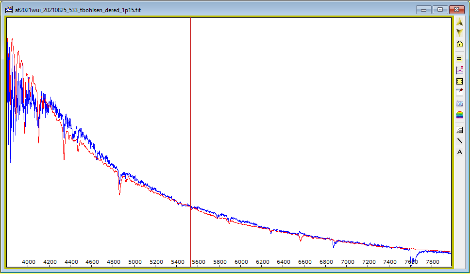

Here is Terry Bohlsen's spectrum dereddened by 1.15 compared with Pickles B1v.
Whatever it is, it is certainly not a K2iii star so to avoid any ongoing confusion I recommend amending your comment on the IAU TNS website.
