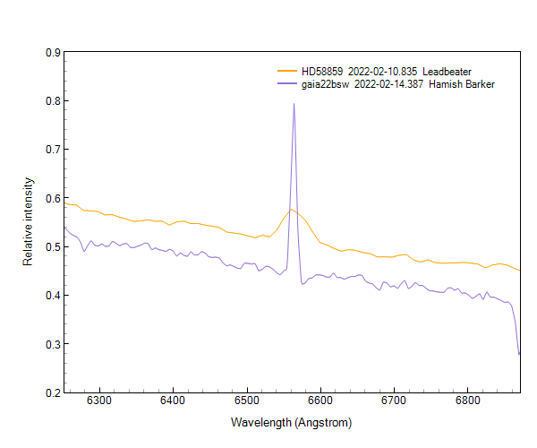

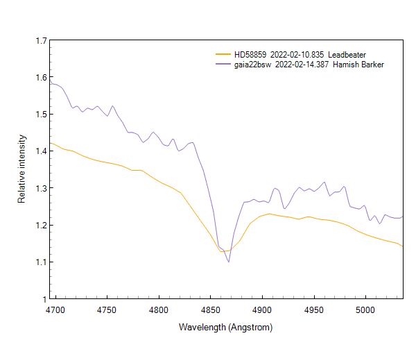

Robin Leadbeater and myself have taken spectra of HD58859. It appears that I initially took a spectrum of the wrong star (facepalm! No guider image was taken - lesson learned!) after noticing it as within reach of my equipment on the gaia alerts page (gaia21bsw). Robin helpfully pointed out my incorrect spectrum (there was a very nearby apparent F type star) after I posted it to TNS.
https://www.wis-tns.org/object/2021itq
Both Robin's Alpy 200 spectrum and my L200 spectra both show emission at H alpha. Mine also might be indicating a possible emission down in the Hbeta absorbtion trough. Robin's planned higher resolution observation should throw more light on these details.
Should this star be added to the BeSS database? I don't have a BeSS login and don't know if there is enough information yet in the spectra to confirm classification.
Hamish

Hamish Barker wrote:
Robin has also made a high resolution observation with a LHiresIII, so perhaps he will upload to BeSS?
They cannot be uploaded to Bess yet as it is not in there ;) (Not yet confirmed as a Be star) My spectra are in the BAA database though.

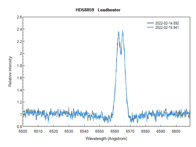

Here is H alpha at high resolution
I have alerted Coralie Neiner and Valerie Desnoux

I reported the object as a possible Be star (Or perhaps Herbig AeBe ?) because it is already classified as a B4IV/V star in SIMBAD, consistent with the low resolution spectrum I took and the high resolution H alpha also showed a clear disc profile. The slow increase in brightness reported by Gaia in TNS could also be consistent with the building of a disc. There are no reports of emission for this star previously so it appears to have gone into emission since the original spectral classification. I think a new Be star this bright could be of interest. What more tests could we do to prove or disprove it is a Be star and distinguish it from other possibilities ?
