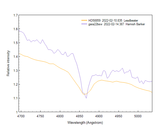

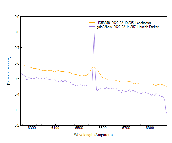

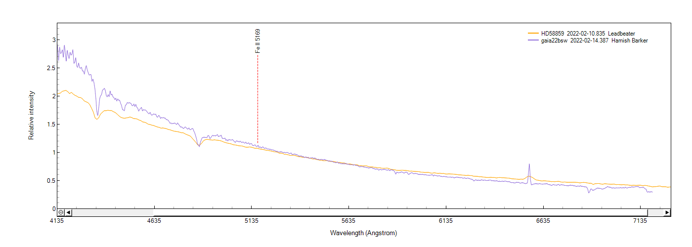

Robin Leadbeater and myself have taken spectra of HD58859. It appears that I initially took a spectrum of the wrong star (facepalm! No guider image was taken - lesson learned!) after noticing it as within reach of my equipment on the gaia alerts page (gaia21bsw). Robin helpfully pointed out my incorrect spectrum (there was a very nearby apparent F type star) after I posted it to TNS.
https://www.wis-tns.org/object/2021itq
Both Robin's Alpy 200 spectrum and my L200 spectra both show emission at H alpha. Mine also might be indicating a possible emission down in the Hbeta absorbtion trough. Robin's planned higher resolution observation should throw more light on these details.

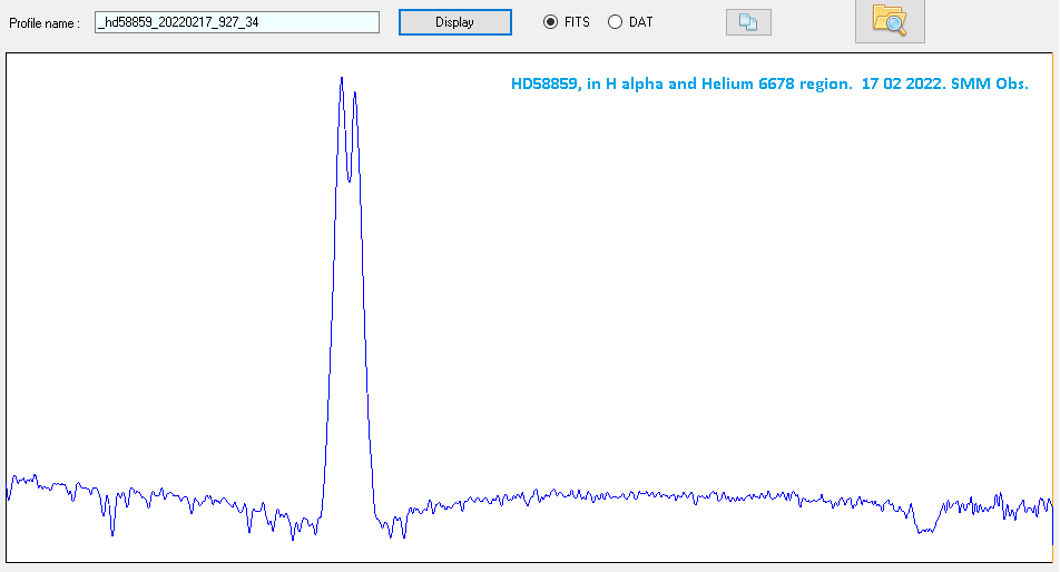

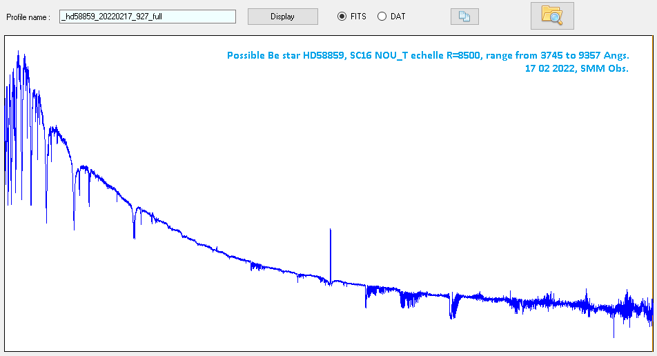

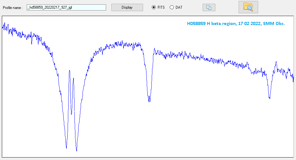

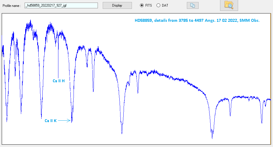

Hello Hamish,
These are the results about HD58859 last night, it's a vry interesting star.
I hope that like you, I'm going to contact someone trom BeSS database and send the fits.
Cheers, Joan.
Cheers, Joan.

Those are nice looking spectra Joan! How much exposure time and telescope aperture was used?
Robin has also made a high resolution observation with a LHiresIII, so perhaps he will upload to BeSS? I have taken low resolution spectra several nights this week, but have been battling some calibration gremlins at shorter than 4500A, including a blue LED light on the power strip supplying my telescope ( now swapped for one with no LED!).

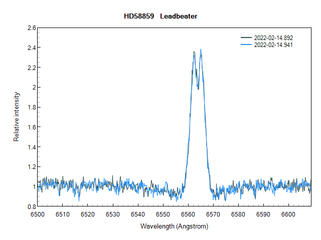

Re: Possible new Be star HD58859 (gaia21bsw / AT 2021itq
They cannot be uploaded to Bess yet as it is not in thereHamish Barker wrote:
Here is H alpha at high resolution
I have alerted Coralie Neiner and Valerie Desnoux
Hello Hamish and Robin,
You know, I took this observation with the remote telescope in Santa Maria de Montmagastrell, - really short name -, from 75 Km. my house. There is the result of 5 x 1200 sec. integrations, with a Meade SC16", reduced to f6.7, NOU_T echelle and a ASI2600MM camera. I take the opportunity to say that working with this camera it's another world and if you use ISIS tools to reduce your observations. Virtually, at minimum you double the area of your telescope.
On the other hand, I have seen that you sent your graphics in TNS, could I send it the one mine ? What is the procedure ?
Thanks Robin for alerting C. Neiner and V. Desnoux, I understand you'll let us know what they say.
Cheers, Joan,
Cheers, Joan,

I reported the object as a possible Be star (Or perhaps Herbig AeBe ?) because it is already classified as a B4IV/V star in SIMBAD, consistent with the low resolution spectrum I took and the high resolution H alpha also showed a clear disc profile. The slow increase in brightness reported by Gaia in TNS could also be consistent with the building of a disc. There are no reports of emission for this star previously so it appears to have gone into emission since the original spectral classification. I think a new Be star this bright could be of interest. What more tests could we do to prove or disprove it is a Be star and distinguish it from other possibilities ?
