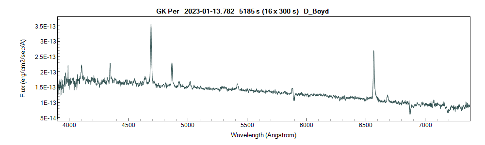

by David Boyd
Another spectrum of GK Per taken with a LISA (R~1000) and flux calibrated using a V magnitude concurrently recorded by Franky Dubois (AAVSO AID).

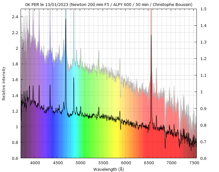

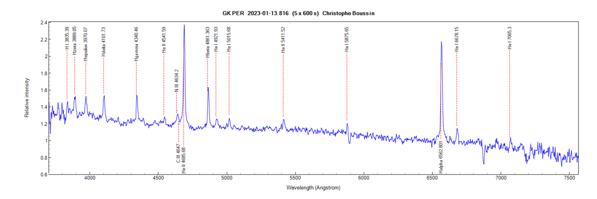

by Christophe Boussin
Congratulations to all the observers !!
Finally, a clear sky to observe GK Per...
The following spectrum was obtained on 13 January at 19:35 UT (resolution of 540, JJ = 2459958.3156) with my Alpy 600 and an acquisition time of 50 min (5 x 600s) :
GK Per on January 13th, 2023
_gkper_20230113_816_Christophe Boussin_3700_7565.png (117.93 KiB) Viewed 49743 times
GK Per on January 13th, 2023 (identification of some lines from PlotSpectra)
Clear skies to all !!

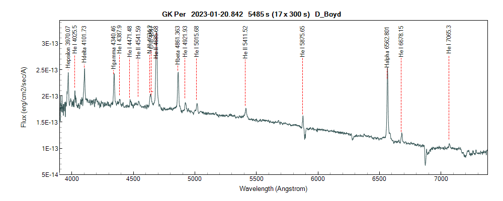

Posted: Sun Jan 22, 2023 12:36 pm
by David Boyd
Here is another spectrum of GK Per taken on 20th January and calibrated in absolute flux using concurrently measured V magnitudes with a mean of V = 10.96.

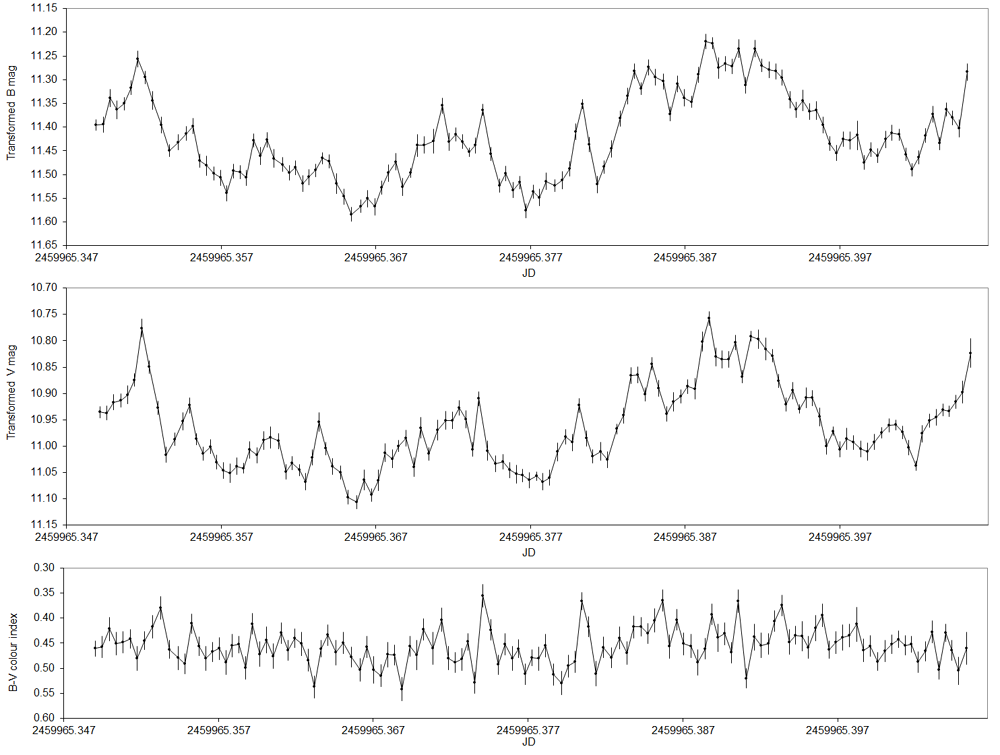

I continued to record B and V magnitudes for 1.4 hrs while recording the spectra and the resulting light curves and colour index are shown below. These show that while there are large variations in both magnitudes, presumably due to flickering(?), these are correlated and the colour remains relatively constant.

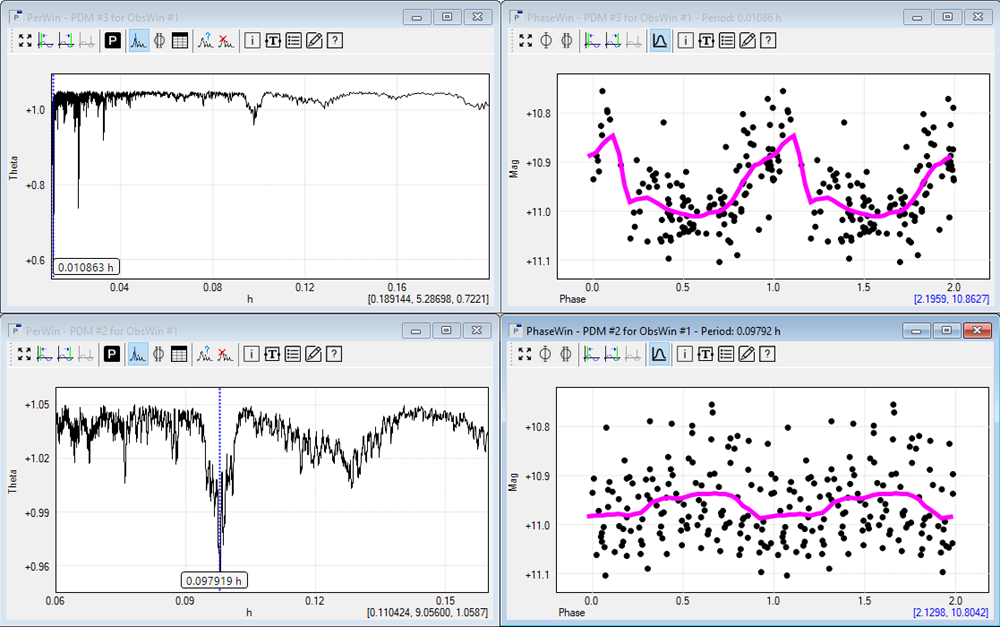

Being curious, I carried out a period analysis of the V band light curve using the PDM method in Peranso. The results are shown below. The upper pair of plots show a strong peak at 0.01086 hr = 39.1 sec with aliases. This may be a QPO in the flickering? But I was also curious about the small broad peak around 0.1 hr. The lower pair of plots show an analysis of this peak which gives a period of 0.09792 hr = 352.5 +/- 1.0 sec. A search of the literature revealed that this is the same as the WD spin period of 351 sec found in X-rays by Watson, King & Osborne (1985). I was surprised to see this signal in the V band light curve.

Re: GK Per Outburst
Posted: Mon Jan 23, 2023 11:47 am
by Hubert Boussier
Hello David,
About the rapid variations of the B and V magnitude you underlined, you guess that it may be due to flickering, what was the time exposure you used ?
It seems yhat the B and V are more or less related so don't you think that if it was flickering the variation would be more stochastic ?
Hubert
Re: GK Per Outburst
Posted: Mon Jan 23, 2023 6:29 pm
by David Boyd
Hello Hubert,
According to Bruch, A&A, 266, 237 (1992) the mean B-V colour index of the flickering light source in GK Per is close to 0 so the B and V magnitudes should change together, subject to the stochastic variation inherent in the flickering process.
The exposures were alternately 10 sec in V and 20 sec in B. This means the interval between V measurements was close to the 39 sec signal which appeared in the power spectrum so it looks as though this may be the cause of that signal.
