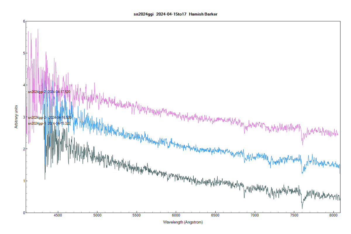

by Hamish Barker
A few more from this week.
- sn2024ggi-1_20240415_322_Hamish Barker.png (153.97 KiB) Viewed 35708 times

by Tom Love
Not much in the way of structure emerging tonight.
