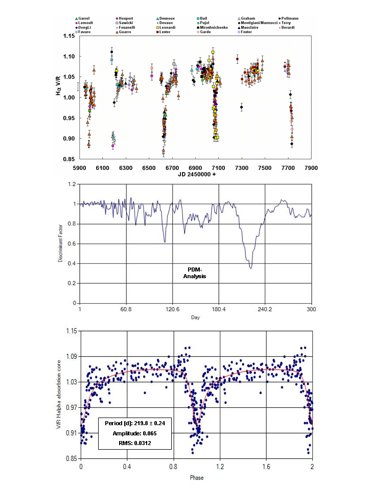

Dear colleagues,
attached you can find the V/R & RV period analysis of the Halpha absorption core of 28 Tau.
In contrast to my last postings and due to a calculation error, the last periastron took place already at JD 2457698 (2016-11-05).
Because of the fact that until now 8 periastron passages has been covered, the period of RV corresponds now more to the period by Nemravova in A&A, 516, A80, 2010. Compare in that context the published RV period in IBVS No. 6199:

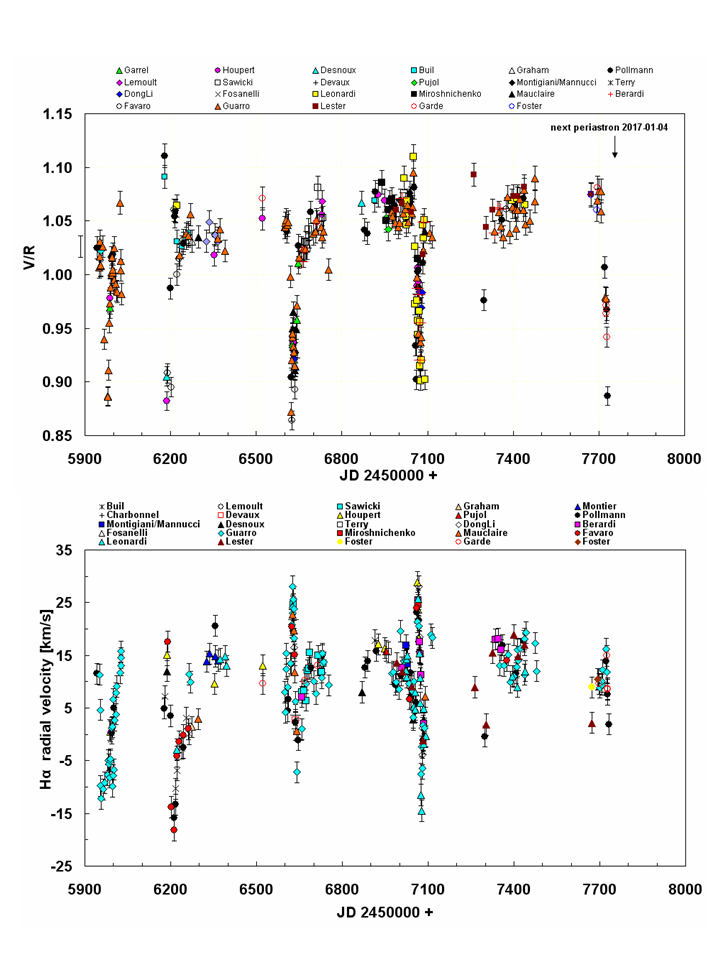

Re: 28 Tau ARAS monitoring
Posted: Sat Dec 17, 2016 1:25 pm
by Ernst Pollmann
... a supplement to the observation result above:
The next periastron will take place:
JD 2457916 = 2017/06/11 (unobservable)
JD 2458134 = 2018/01/15
It seems, the periastron we observed very well, did happen fairly precise without any distortions or time delays.
But there are signs that the ratio V/R does react much more sensitive than the radial velocity RV.

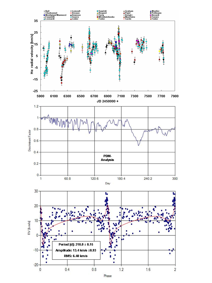

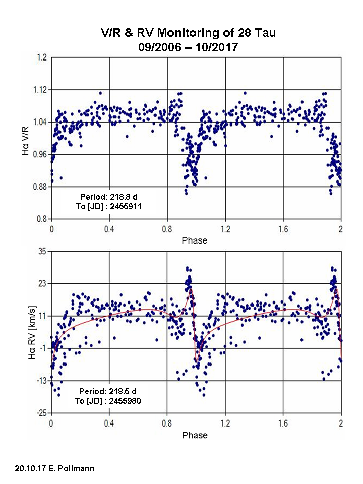

Dear colleagues,
the coming season offers again the opportunity to supplement our studies of Halpha radial velocity and V/R of Plejone (upper Fig.). Even if our monitoring so far did provide a fairly stable period of both, this measurements are performed while the Halpha EW of the disk was (more or less) in its minimum (Fig. bottom)
It is not known, what happens with RV & V/R if the disk EW growth up again.
