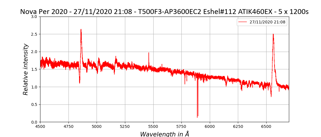

Posted: Fri Nov 27, 2020 6:58 pm
by etienne bertrand
Comme Olivier avec l'Alpy j'ai un spectre un peu bossu qui monte du bleu vers 5800A puis après qui descend.
Olivier, tu montres des évolutions de la raie Ha extrêmement rapides, ça évolue aussi vite ?

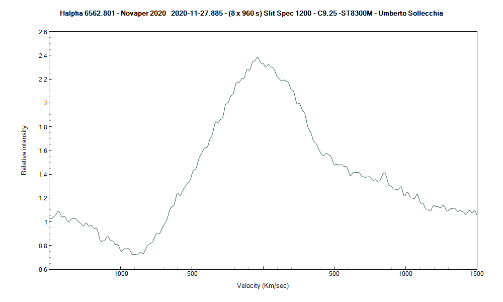

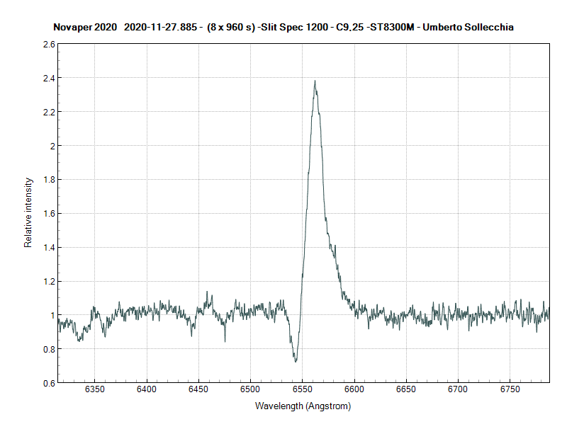

by umberto sollecchia
Salut à tous, je place ma contribution à l'observation de cette nuit 27/11/2020.
Umberto Sollecchia
novaper2020_20201127_885_Umberto Sollecchia.png (41.28 KiB) Viewed 12076 times
novaper2020_20201127_885_VR_Umberto Sollecchia.png (22.48 KiB) Viewed 12076 times

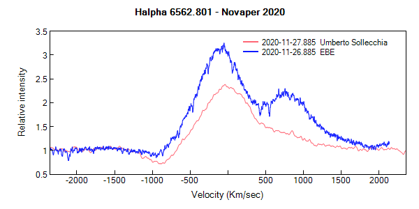

Posted: Sat Nov 28, 2020 9:36 am
Impressive change in one day. See also Olivier Garde's graphs.
The red component (linked to the absortion - 850 km/s) disappear
EBE = Etienne Bertrand
Database updated: http://www.astrosurf.com/aras/Aras_Data ... er2020.htm
Bonne continuation!

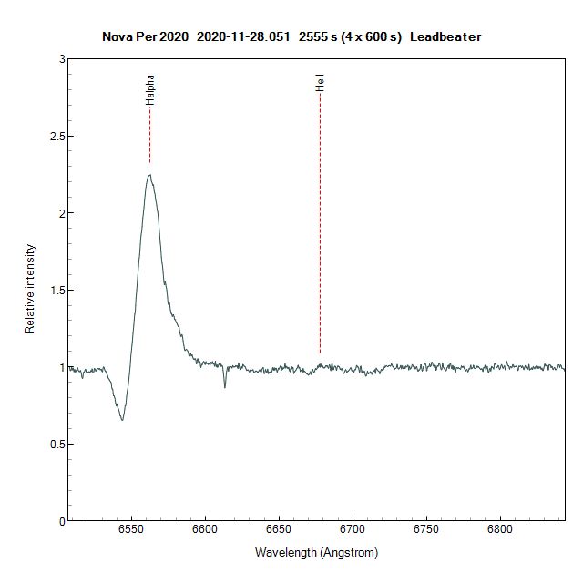

Posted: Sat Nov 28, 2020 9:42 am
by Olivier GARDE
Second night on this Nova with a bad weather (feezing fog).
Here's the evolution of the balmer lines in one day

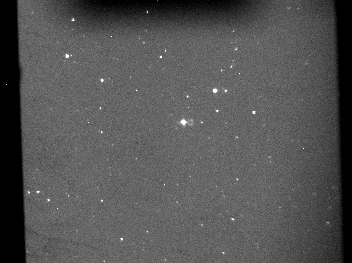

Posted: Sat Nov 28, 2020 12:21 pm

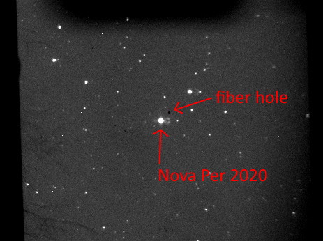

by Stephane Charbonnel
My little contribution ...
Shifted field :
Champ décalé
Champ décalé
Field with Nova in the hole :
Champ spectral
Champ spectral
The result :
Spectre
Spectre
Stephane
