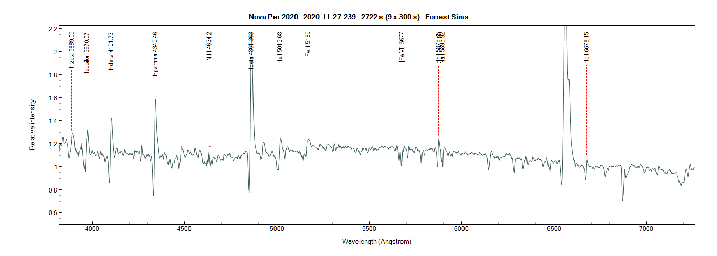

I had luck with the weather and was able to capture the spectrum of this object with my LISA. I have tentatively identified a few lines. Thanks Robin and François for the alert. The fits data has been submitted to the ARAS database. Olivier, I hope your clouds go away and we get to see a high resolution spectrum soon:)
Woody

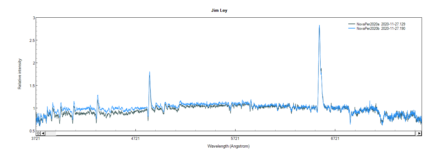

Great spectrum Woody.
I recorded mine with my ALPY a little before you. I'll probably have to reprocess a little bit.

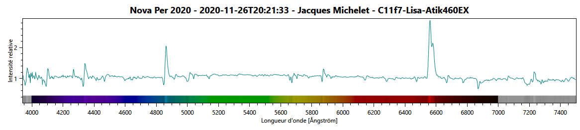

Post by Jacques Michelet »
Yet another one. Clouds prevented me to exposure for more than an hour.
Nova Per 2020
Nova Per 2020

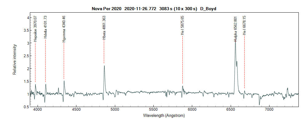

Post by David Boyd »
Here is the first of two spectra I was able to record last night, 26th Nov. Thick fog eventually ended observations.

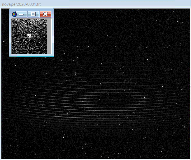

Last night was not very fine with some fog...
But I have some results with an eShel spectrograph R=11000 and RC400 Astrosib.
The target in the auto guiding field (ATIK 314L+)
And the full spectrum of all the exposure taken during all the night (28 exposures of 1200s each)

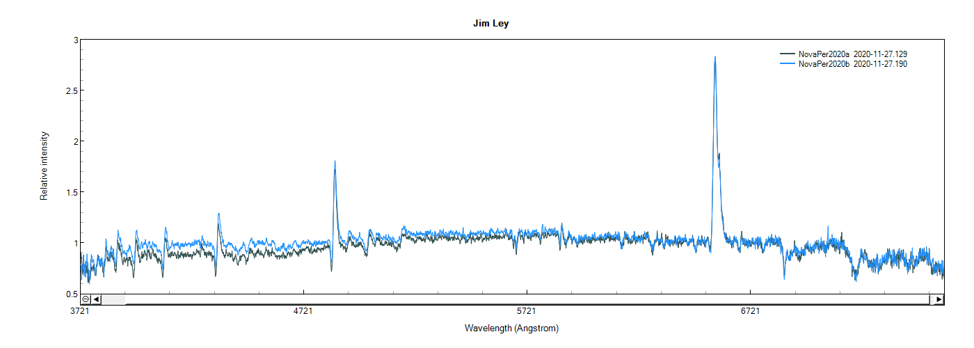

The spectrum is very noisy specially in the blue end.
Because the target move from 37 to 88 degrees in altitude, I separated my observation in 4 parts of 2 hours each. (Can't use the same instrumental Response)
Here's the evolution of H Alpha and H beta during the night
And an animation center on H alpha line during the night. We can see the evolution of the P Cyg profil and mesure the ejecta velocity (around 1000km/s for H Alpha, less for H beta)
And if we put all the Balmer lines together we see that the velocity is not the same with all the Balmer lines.
Many lines presents P Cyg profil like He 5876 Å
