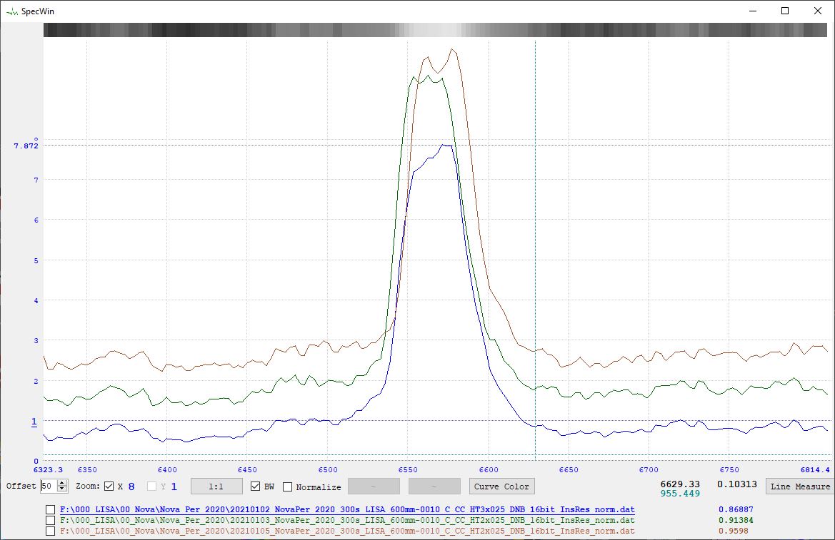

I have some spectra from January 2, 3 and 5 made with a LISA
From bottom to top are 2, 3 and 5 January 2021

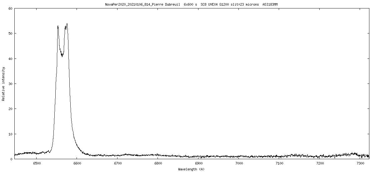

Ci dessous le spectre autour de H-Alpha réalisé avec UVEX(4) G1200 le 6/1/2021
spectre complet:
complet
complet
_novaper2020_20210106_814_Pierre Dubreuil_complet.png (6.33 KiB) Viewed 16170 times
Autour H-Alpha:
NovaPer2020  H-Alpha
NovaPer2020 H-Alpha
_novaper2020_20210106_814_Pierre Dubreuil.png (7.16 KiB) Viewed 16170 times

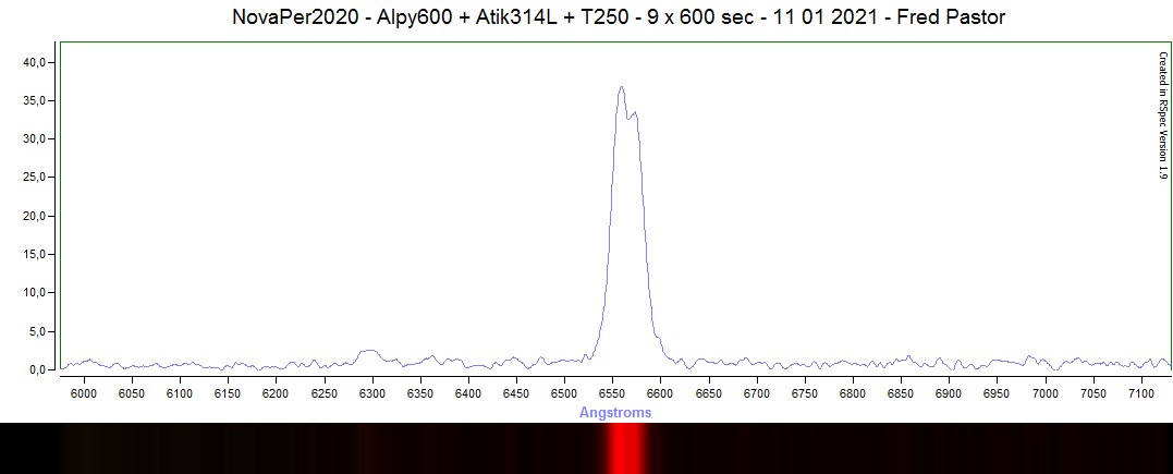

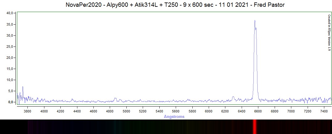

Profitant d'un début de soirée clément, je viens de prendre ce soir 9 spectres de 10 minutes sur la Nova Per 2020. La magnitude doit approcher les 12 maintenant.
Spectre basse def Nova
rspec nova Per 2020 11 01 2021.jpg (59.17 KiB) Viewed 16100 times
On retrouve bien cette large raie Halpha avec ses oscillations au sommet. Ce soir, cette oscillation penche du côté du bleu:
close up Halpha
close up Halpha
close up Hakpha Nova Per 2020 11012021.jpg (54.88 KiB) Viewed 16100 times
Les mouvements d'un soir à l'autre sont particulièrement impressionnants. Et bravo à tous pour ce suivi et ces explications précieuses (tout comme la passionnante conférence de François vendredi dernier ;) )

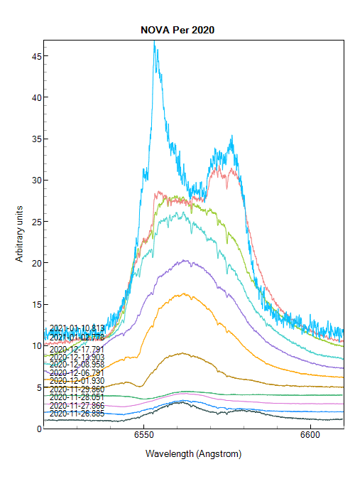

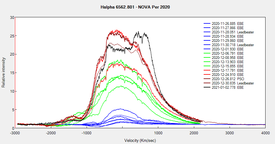

Posted: Sat Jan 16, 2021 5:41 pm
by John Coffin
I've been trying to understand the evolution of the spectra collected by everyone contributing. I noticed that the profile of H alpha at the very beginning on 26th November is similar to the most recent, that is to say, there appear to be twin peaks. Francois, you commented on the most recent spectrum of H alpha and said that this profile suggested that the ejecta were optically thin. What would explain the appearance on the 26th November, were the ejecta optically thin then?
After this a P Cygni profile developed and the absorption component moved further and further towards the blue. After mid December the profile became a purely emission spectrum.
Can anyone explain to me what is happening?
H alpha region of Nova Per 2020
Nova Per 2020 H alpha.png (70.67 KiB) Viewed 15965 times

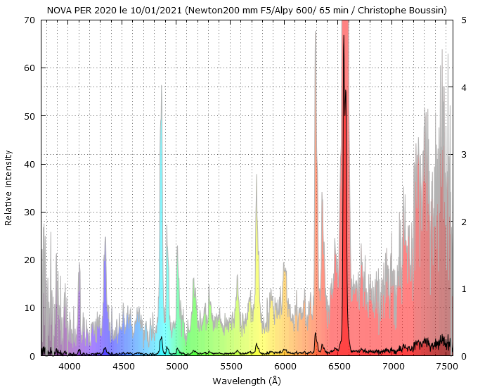

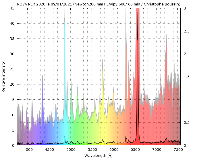

Here is my new update for the monitoring of the Nova Per 2020.
The following spectra were obtained with an Alpy 600.
The 9th of January at 18 h 17 TU (resolution of 510, JJ = 2459224.2617 and an acquisition time of 60 min) :
Nova Per 2020 on January 9th, 2020
_novaper2020_20210109_762_Christophe Boussin_3750_7565.png (91.2 KiB) Viewed 15914 times
The 10th of January at 18 h 19 TU (resolution of 508, JJ = 2459225.2635 and an acquisition time of 65 min) :
Nova Per 2020 on January 10th, 2020
_novaper2020_20210110_764_Christophe Boussin_3750_7565.png (96.32 KiB) Viewed 15914 times

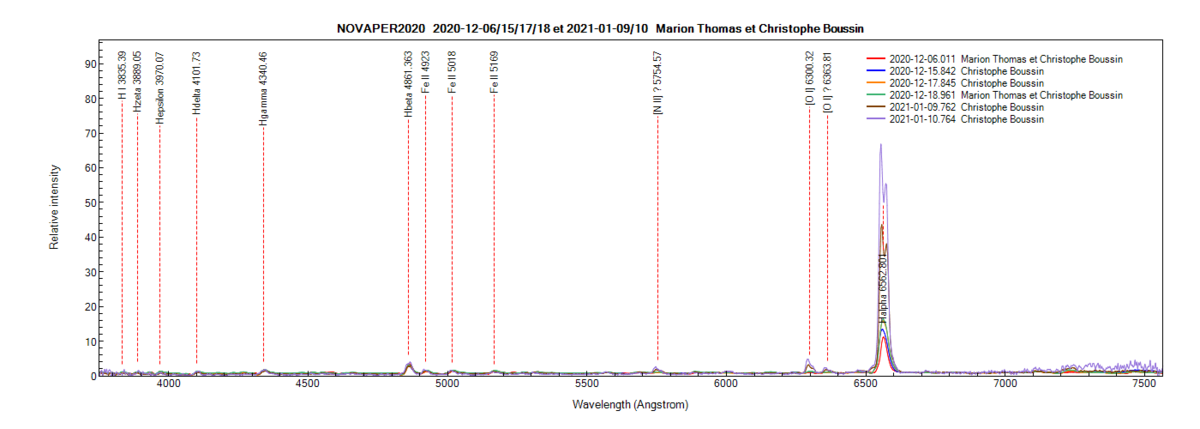

It seems to me that the lines [NII] at 5457A and [OI] at 6364A are now visible in the spectrum... is that correct?
Nova Per 2020 on December 6th, 15th, 17th, 18th, 2020 and January 9th and 10th (identification of some lines from PlotSpectra)

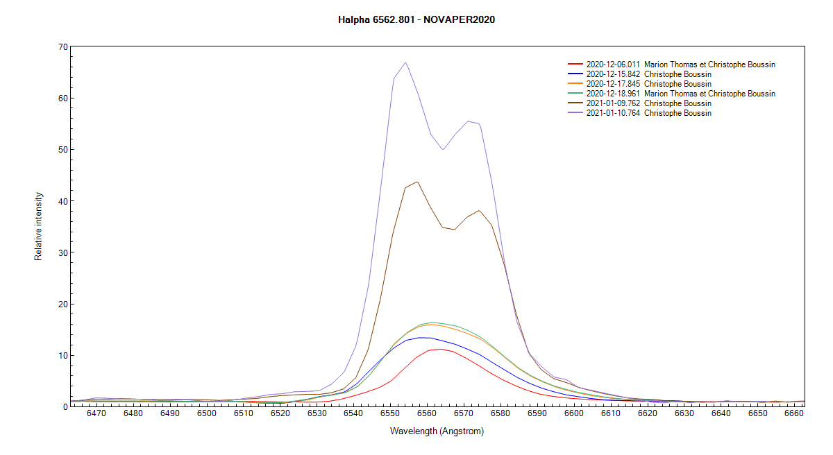

The relative intensity of the Halpha line continues to increase and, as the ejecta appears to have become optically thin, the "structure" of the Halpha line is now clearly visible even at low resolution :
Nova Per 2020 on December 6th, 15th, 17th, 18th, 2020 and January 9th and 10th (Halpha line)
novaper2020_20210110_764_Christophe Boussin_Halpha.png (50.75 KiB) Viewed 15914 times

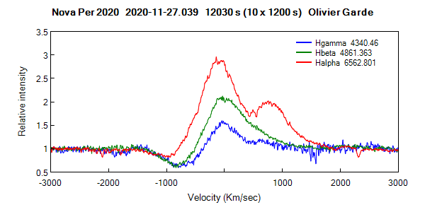

Posted: Sun Jan 17, 2021 7:17 pm
Paolo: excellent and very informative result: He I 6678 still missing.
Christophe: l'identification est correcte.
John:
The clues:
As I explained during the workshop,

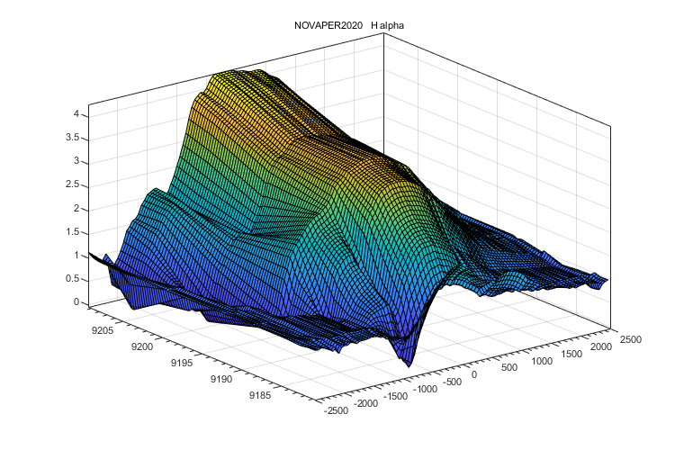

First spectrum 2020-11-26 (Olivier Garde): the bump on the red part of H alpha doesn't appear on H beta profile, thus it -probably- do not belongs to Balmer transition.
At the date, there no identification, no explanation for this feature.
Last echelle spectrum 2020-12-25 (Joan Guarro): the red emission in H alpha line begins to rise. We see it also in H beta, and faintly in H gamma: it belongs to the Balmer series.
No explanation at the date for the development of this red emission component which were observed in other novae.
Thus, the two bump have different origines.
Last: about the absorption systems.
They are still present late December as shown during the workshop.
With maximum absorptions at rv = -1200 and 2100 km/s
H alpha_asdb_NovaPer2020_20201225_744.png (180.75 KiB) Viewed 15891 times
I have not yet sudied the last data.
