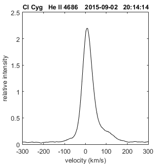

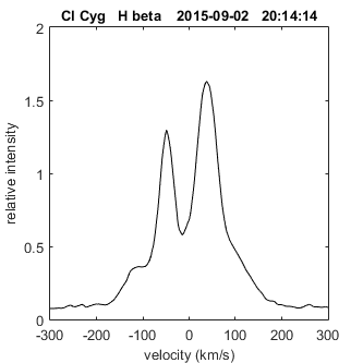

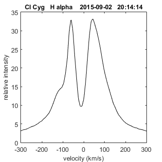

First spectrum of my "pet symbiotic" with eshel at Mag V = 11.2
8x600 sec exposure
Pretty good snr
Here's the profile of a few lines
_cicyg_20150902_843_full_H alpha.png (13.56 KiB) Viewed 3995 times
_cicyg_20150902_843_full_H beta.png (11.82 KiB) Viewed 3995 times
_cicyg_20150902_843_full_He II 4686.png (11.73 KiB) Viewed 3995 times
Thank you to Peter and Dong who opened the way with high res spectra of faint symbiotics, mag 11 to 13, (H alpha with Lhires 2400 l/mm)

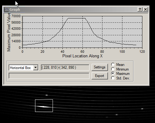

J'ai failli me faire avoir ce soir avec AG Peg.
180 sec de pose : Ha complétement saturée. Il a fallu que je descende à 60 sec pour descendre le signal Ha à 45000 ADU.
