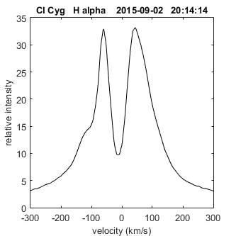

First spectrum of my "pet symbiotic" with eshel at Mag V = 11.2
8x600 sec exposure
Pretty good snr
Here's the profile of a few lines
_cicyg_20150902_843_full_H alpha.png (13.56 KiB) Viewed 3994 times

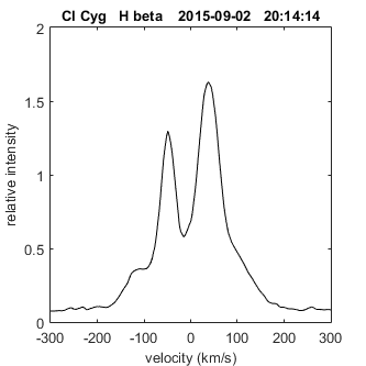

_cicyg_20150902_843_full_H beta.png (11.82 KiB) Viewed 3994 times

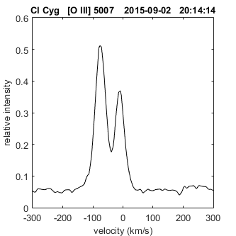

_cicyg_20150902_843_full_[O III] 5007.png (12.89 KiB) Viewed 3994 times
Note the double peaked line

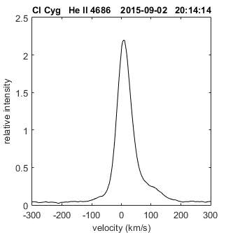

_cicyg_20150902_843_full_He II 4686.png (11.73 KiB) Viewed 3994 times

Re: CI Cyg at R = 11000 Mag 11.2
Francois,
I am wondering whether the O III line is expected to skew that much. Or is it merged with another feature?
It would be interesting to check whether it has a known variability of shapes on these lines.

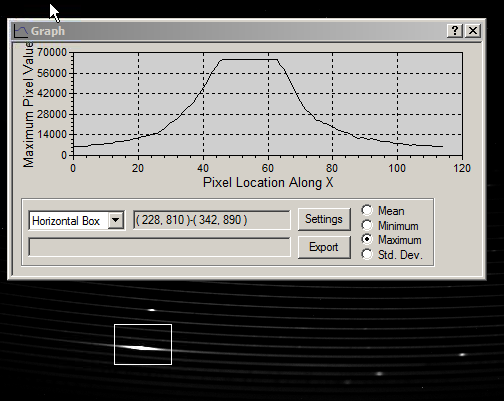

J'ai failli me faire avoir ce soir avec AG Peg.
180 sec de pose : Ha complétement saturée. Il a fallu que je descende à 60 sec pour descendre le signal Ha à 45000 ADU.

Peter : I think that this profile results from a two components emission
