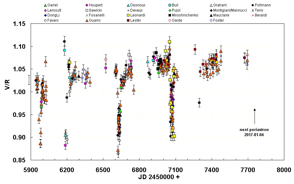

Dear colleagues,
attached you can find the ARAS monitoring of the Be star 28 Tau. As you can see, the last periastron is obviously past already. It's a pity, because the next will be in approx. 218 days.

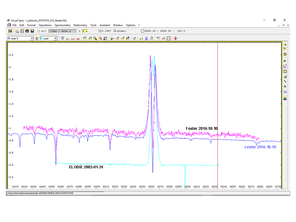

By chance I shot Pleione on 10Oct16, here is the graphic of the Ha region:
Are these to Fe2 lines real? Its curious that there so prominent in this region.

Hi James,
I didn't find any information of the FeII lines (6456.376 & 6516.53) in literature. But at least it seems to be real, by comparison with the BeSS spectrum of Tim Lester at the same date. On the other hand, these both Fe lines are absent in a ELODIE spectrum from 2003 (see the Fig. below).
So, I can't say anymore to that observation fact.
Ernst

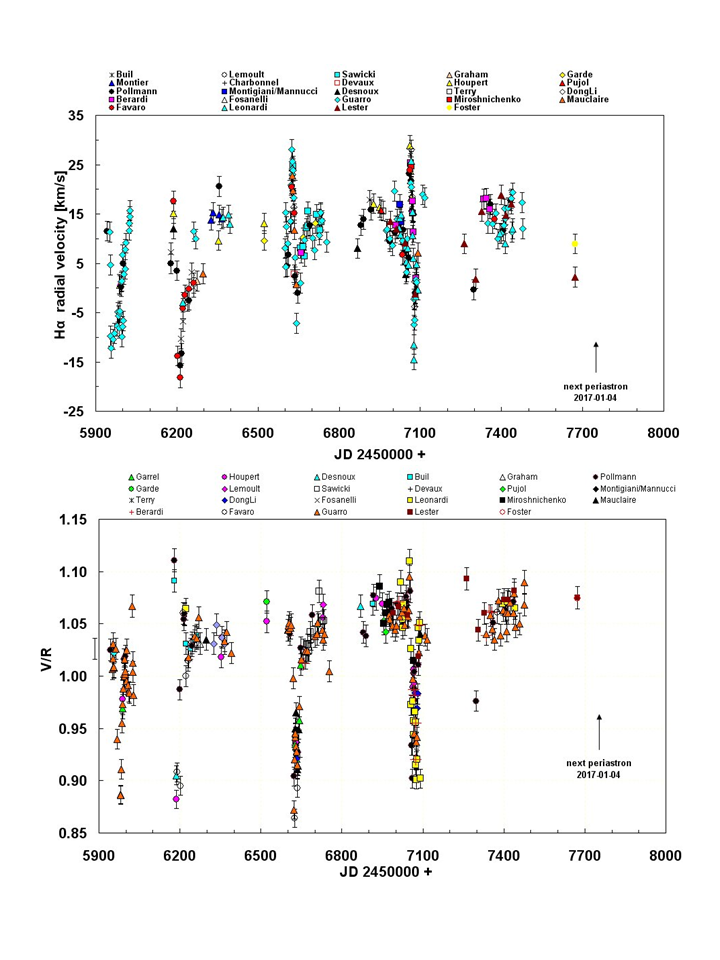

Dear colleagues,
don't forget to observe the next periastron passage of the Be binary star 28 Tauri at January 4th 2017.
Attached you can see the current RV and V/R observation of James Foster and Tim Lester.

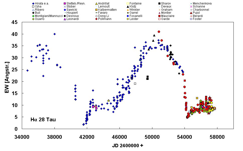

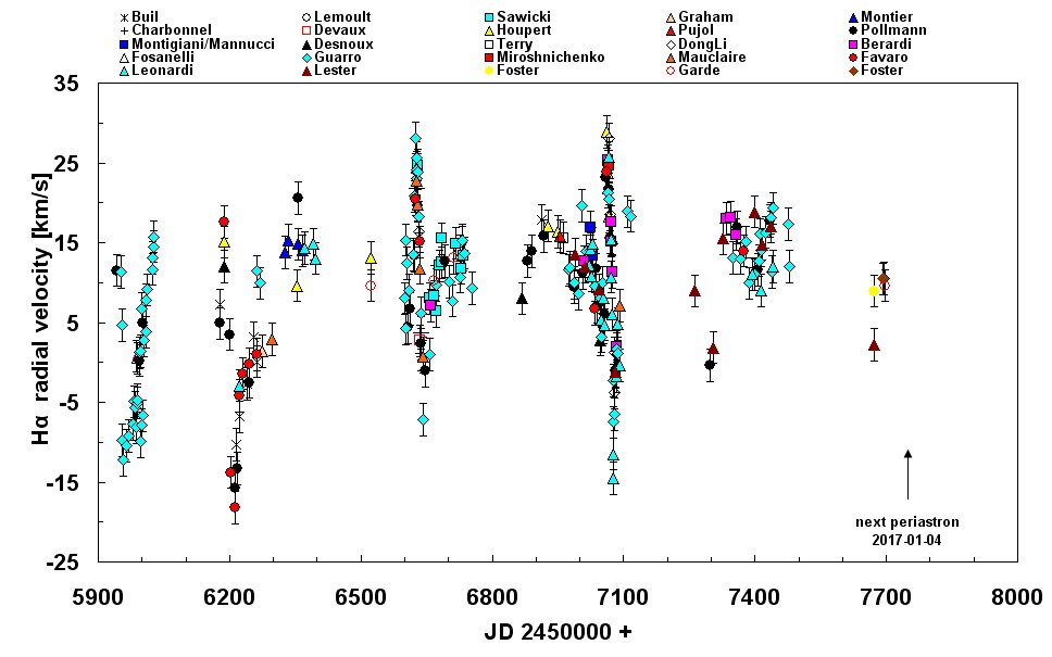

by Ernst Pollmann
James,
here comes the Halpha EW, V/R and RV evaluation.
The link...
http://astrospectroscopy.de/media/files ... glisch.pdf
... offers some information about previous passages.
Ernst
