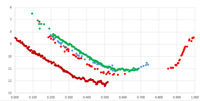

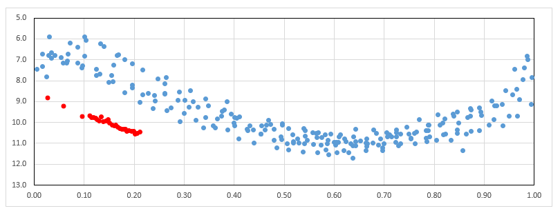

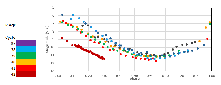

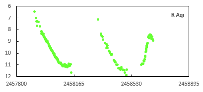

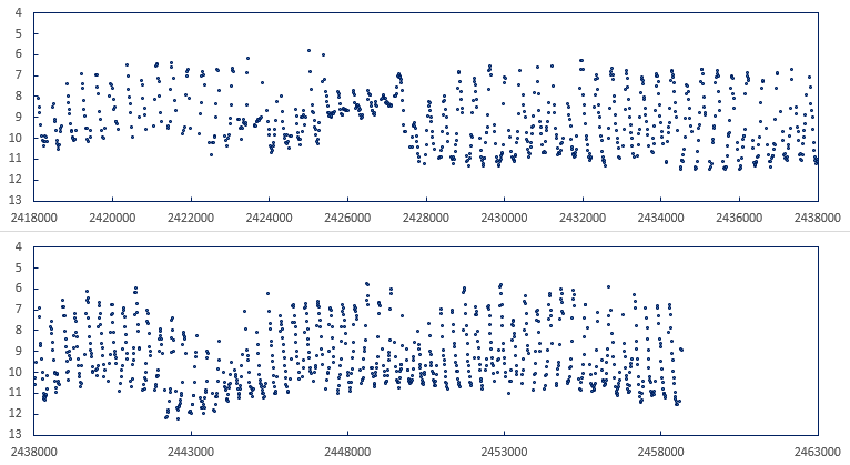

The historical light curve in AAVSO database (Visual, 15 days mean)
since 1908
The 3 last pulsations of the Mira
with the recent maximum about 1 mag under the previous ones.

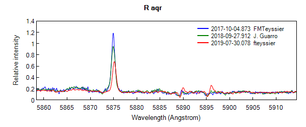

Echelle spectrum obtained this morning.
Emission lines looks weaker than during the previous pulsations of the mira at about the same luminosity
Na I D in emission.

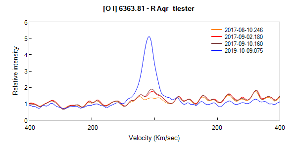

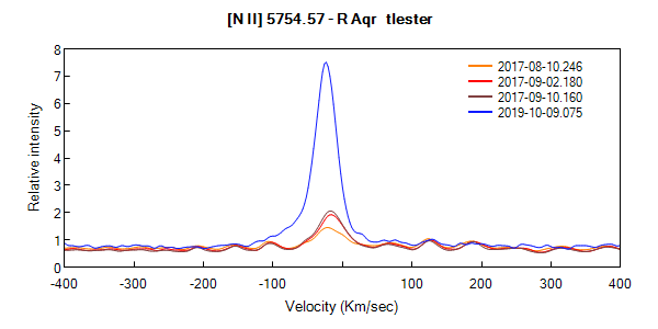

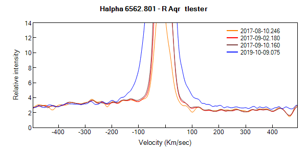

Posted: Fri Oct 18, 2019 4:30 am
The luminosity of the current pulse remains much lower in comparison to previous pulses
Significant changes of the main lines, EW and profile, especailly in the blue part of the lines:
Tim lester's spectra R = 140000
Margarita Karovska:
There it is definitely something going now...
Let see how the spectrum changes in the next couple of months.

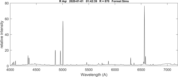

I will throw this idea out in answer to your question. I have been using HD192907 as the Reference star. Because R Aqr is setting so early I take its spectrum first, followed by the Reference star. HD192907 is a Miles Reference star in ISIS. Other helpful factors are that it is a B9III star and an E(B-V) = 0.02. The airmass at the time I shoot the Reference star is pretty close to that at the midpoint of the R Aqr exposures. HD192907 is also on the same side of the pier as the target. Possible disadvantages are that it is pretty bright at mag 4.395, which depending on your system might mean pretty short exposures and is Northwest whereas the target is Southwest so the airmass may be somewhat different. Other possible Reference stars I have considered get too far away from a late B to an early A star and or have really bad E(B-V) value exceeding 0.05. Maybe this will spark some discussion and we can come up with a better option.
Here is my spectrum of R Aqr from last night.
Woody Sims
