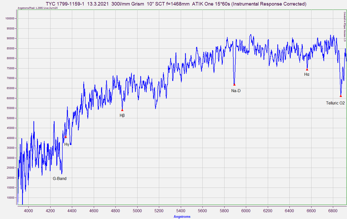

- Spectrum taken by Uwe Zurmuehl
Dear Forum members,
just now I received a spectrum from German amateur Uwe Zurmuehl, taken last night under difficult conditions. It looks like a normal K spectrum, with Na D, G band, H-alpha, -beta, -gamma in absorption, and no emission apparent. Uwe Zurmuehl commented that the run of the continuum (calibrated via a neighbouring A0 star) is consistent with an unreddened K2III star.

1) It takes the urgency out of my request. It answers my main question on the star perfectly and conclusively. Any even better spectrum would of course do no harm
, and a spectrum taken during the next eclipse minimum would be a gem. That minimum will be the last one to (possibly) be reachable before the seasonal break. It will occur on April 10, around 20:30 UT. It will not be observable from far northern latitudes, and generally from a fairly restricted range of longitudes only - if at all.
2) The astrophysical conundrum posed by the HRD location of the star and the characteristics of the eclipse lightcurves is confirmed, and kind of deepened even.
