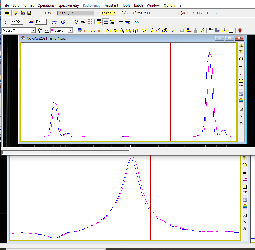

It is certainly strange that you are not seeing any blurring effect in the spectra. ISIS does not align the spectra unless the box is ticked and I do see a broadening of narrow lines with my LHIRES which can shift several pixels during a long exposure (mainly due to flexure). As standard I take lamps at start and end and sometimes in the middle of an observation and average them. The shift in the lamp spectrum is clear just viewing the images. (Note that the ISIS alignment tool uses a lamp at the start and only works well if there are good features in the spectrum to lock onto.) Is is possible somehow that your lamp spectrum is shifting but the star spectrum is not. (It would be difficult to explain how though ) What do you see if you just bin the individual spectra at the same Y location and overlay them without calibrating? Do they line up perfectly (also the same for lamp spectra at start and end)

An example with the LHIRES showing the same shift in lamp and star from start to end of run (2 pixel shift in 45 min (15x 3min exposures)
binned in the same Y position using Visual Spec.
