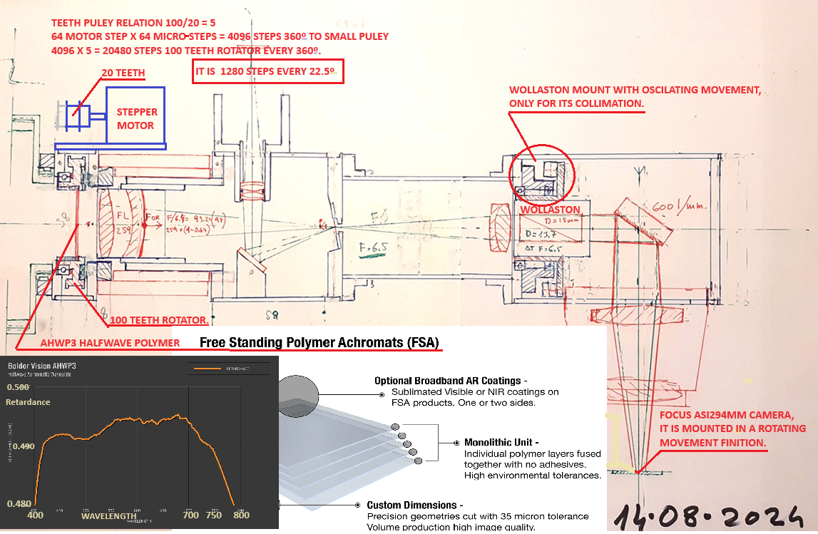

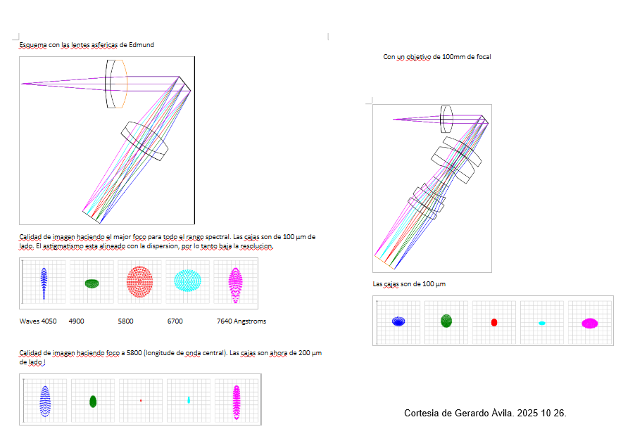

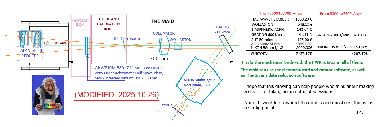

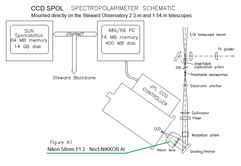

Hello at all,
Led by Gary Cole who has been dedicating almost part of his life to stellar polarimetry, I show here a spectro-polarimeter sketch that I'll try to build during this year.
If you see C. Buil's website, you will realize that this isn't the first attempt to connect this "new" observational specialty.
The main aim is to fill an important gap in the stellar study.
This way are plenty of doubts and unknowns, that is only the beginning, then we'll see.
Having projects helps to have good feelings.
Your opinion is very important to me.
Cheers, Joan.

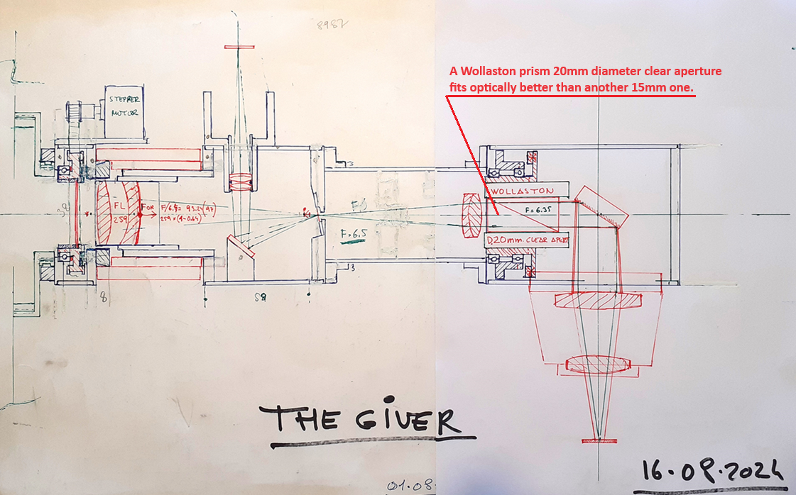

These are the last sketches.
Joan.
Joan.
- SKETCK N 18.png (1.31 MiB) Viewed 398223 times
- SKETCK N 17.png (998.35 KiB) Viewed 398223 times

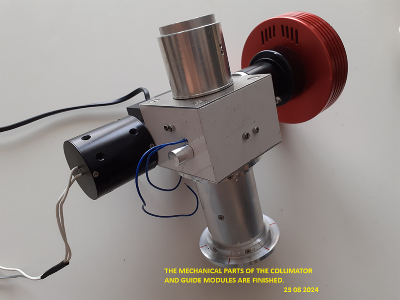

- Posts: 731
Re: POLARIMETER DEVICE PROJECT
Two modules are finished, without the optics, of course.
J.G.
J.G.
- COLLIMATOR AND GUIDE.png (540.83 KiB) Viewed 398161 times

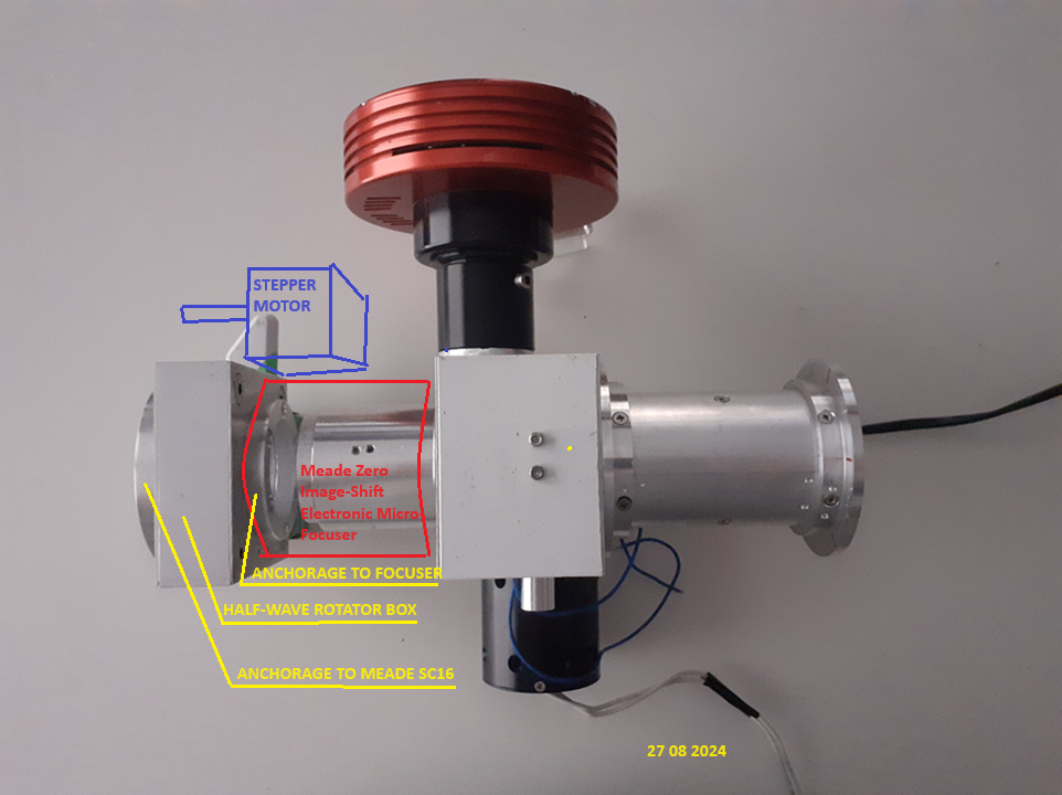

- Posts: 731
This is a picture from 27 08 2024. Slowly the container is growing.
Joan.
Joan.
- ROTATOR COLLIMATOR AND GUIDE.png (780.15 KiB) Viewed 397957 times

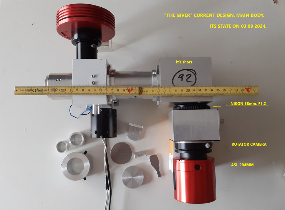

- Posts: 731
This is the current state.
JG.
JG.
- THEGIVER 2.png (970.74 KiB) Viewed 397789 times
