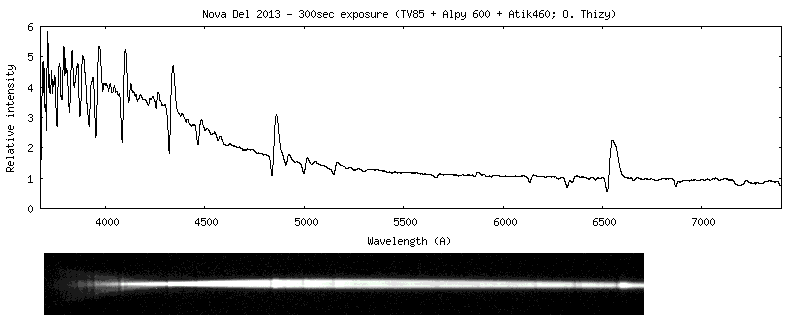

Here is a 300sec exposure with a very small 85mm refractor and our new Alpy 600 spectrograph.
I quickly processed with last night calibration (I'll do the calibration in about one hour) and the result is impressive with only one exposure:

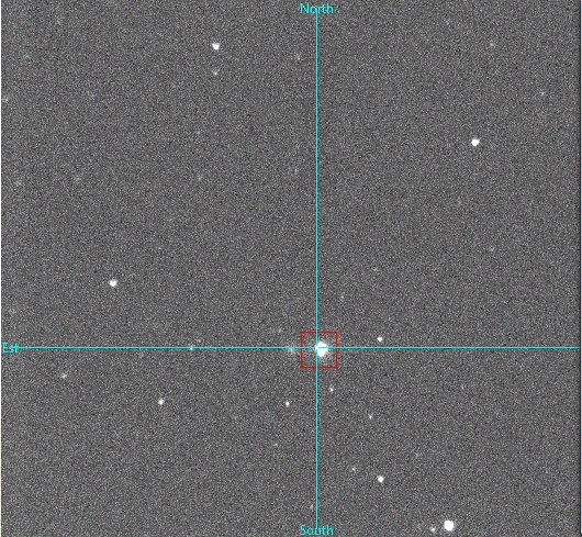

and here is the guiding field of view:

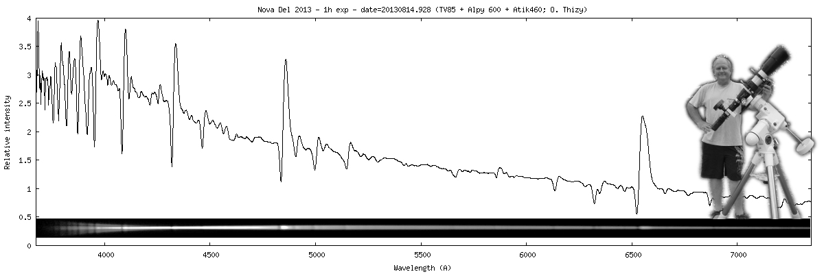

Le même spectre mais avec 1h de pose (12 poses de 5min) maintenant...
Same spectrum but with 1h (12*300sec) total exposure now...
