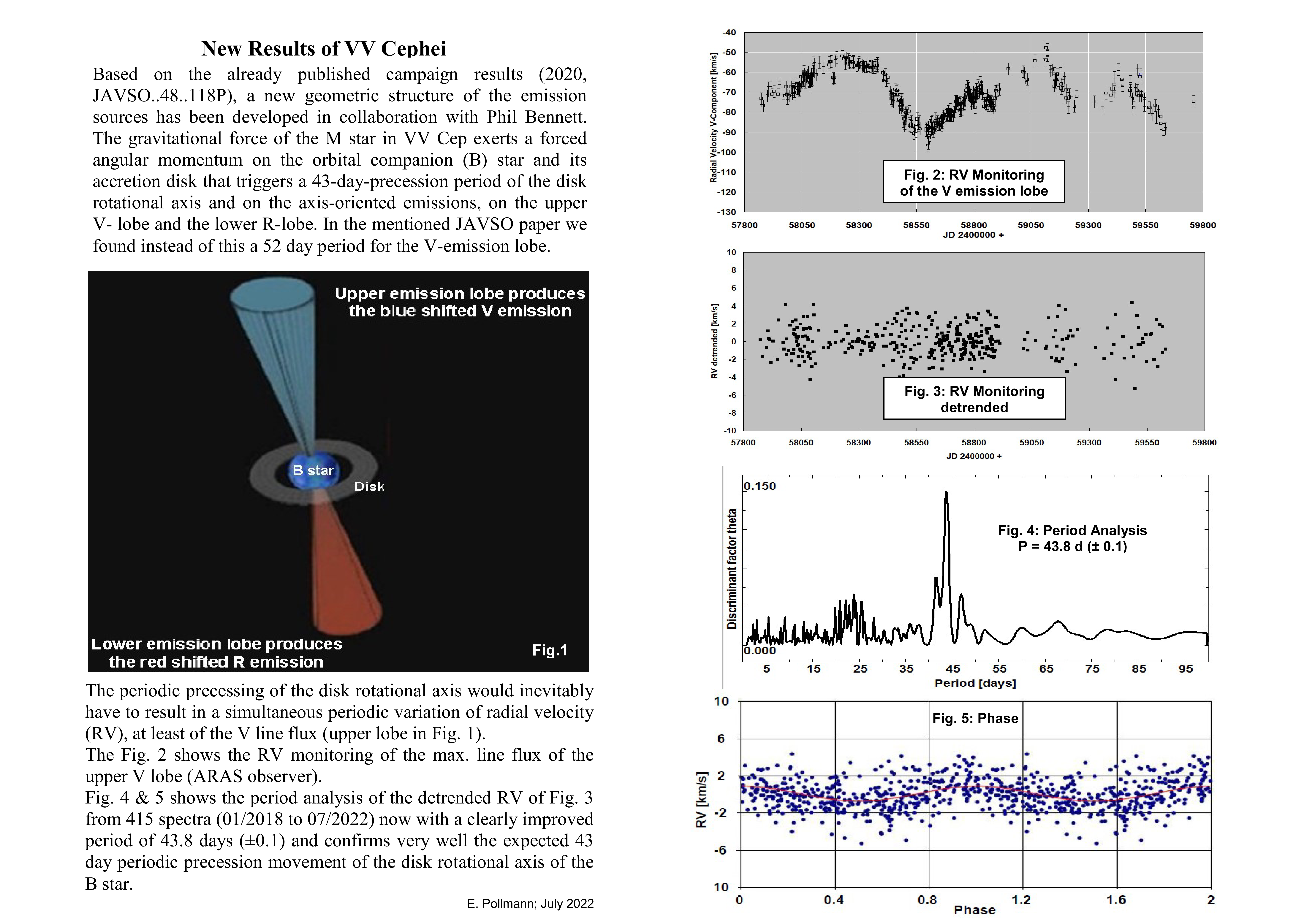

herewith I want inform you about the newest evaluation of VV Cep. The growing data set since approx. JD 2459000 did enable a new analysis of the radial velocity of the V emission component.
The question has been, whether the former precession period of 52 day could be improved. See the attached analysis.
Many thanks for your worthwhile spectra!!
