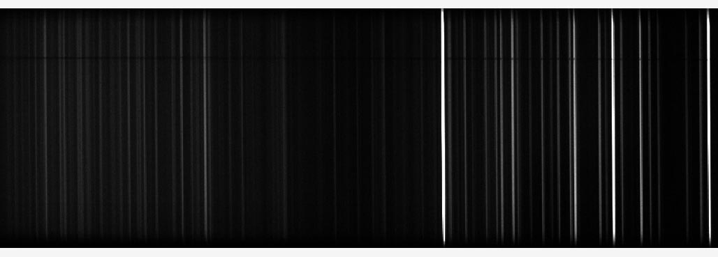

I recently decided to change the slit from 25μ to 35μ. I found that the calibration lines are slanted, as well as the emision lines of background sky in long exposures.

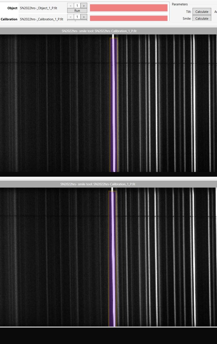

Here i attach an image of the calibration lamp's spectrum lines at the the step "Geometry." First image shows the lines with a bit of slant, about 5º.
Second image shows the same after hitting the button "Preview". The lines are now obviously more slanted. Smile obviously does not work for slant in Demetra, unless i am doing something wrong.
