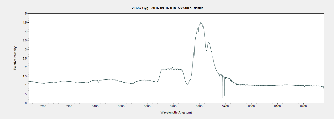

Here is my first try. High in the sky right now so relatively easy to get good S/N. R = 7300 for this spectrum.

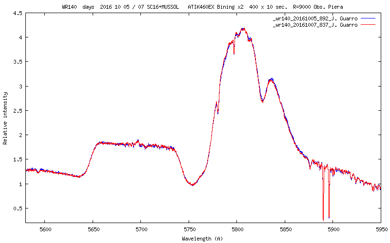

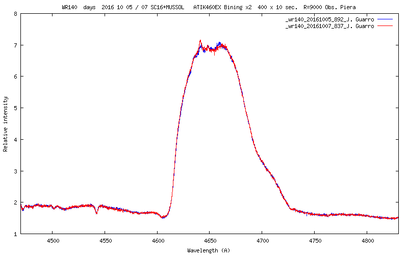

Hello to all,
These are the first results test of the echelle Mussol.
Friendly, Joan.
Friendly, Joan.
- _WR140_4470-4830 A 20161007.png (6.8 KiB) Viewed 8747 times
- _WR140_5580-5590 A 20161007.png (7.57 KiB) Viewed 8747 times

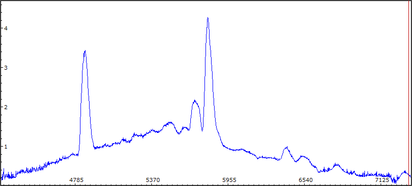

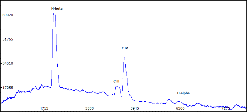

we took the WR140 on 5 oct 2016 and 16 nov 2016 and noted wide emissions in CIII and CIV. Hbeta decrease and CIII e CIV increases in th two dates!

- 11 nov 2016
- v1687 cyg.png (12.28 KiB) Viewed 8683 times
- 05 oct 2016
- V1687.png (12.07 KiB) Viewed 8683 times
