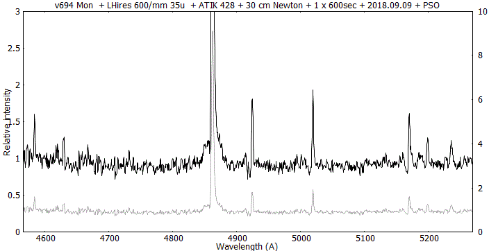

Here are some more LhiresIII spectra of V0694 Mon done before inclement weather set in (used HD071155 at instrument calibration reference star):
Ha region:
Hb region:
There were quiet a few emission line around the emission spike of the H-Beta line; I could only identify the FeII line around 4923.92A.

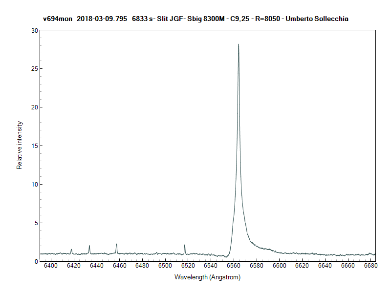

Post by umberto sollecchia »
Bonjour à tous, placez le profil de l'observation du 09-03-2018. Umberto
v694mon_20180309_795_Umberto Sollecchia.png (21.47 KiB) Viewed 12423 times

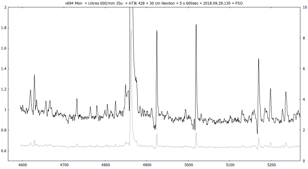

Re: V694 Mon revisted
Today morning's result - similar, in a better quality (5 x 10 mins):
This SNR would allow high resolution (maybe next time).
A narrow absorption is definitely still there (as previous result suggested).
- Peter

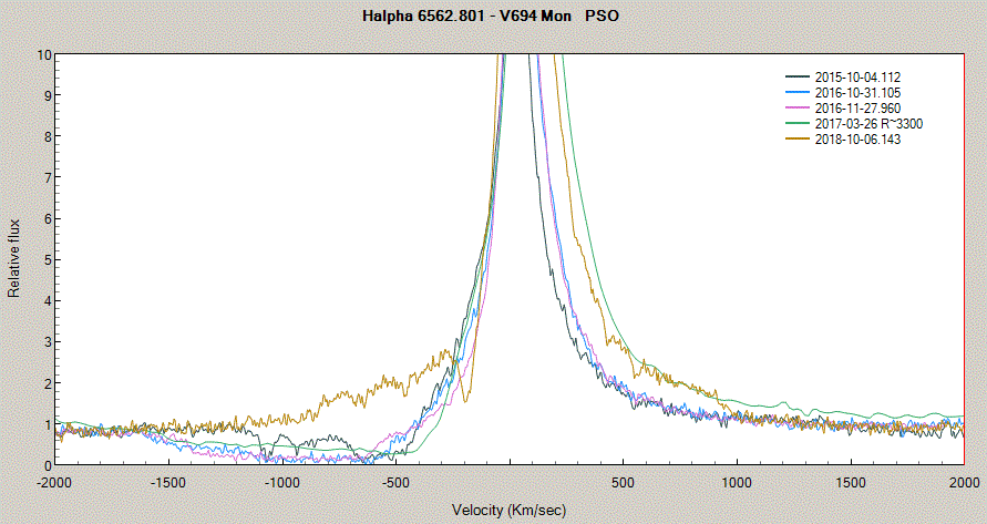

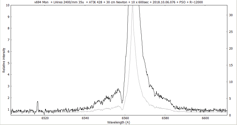

Fresh result from this morning, a similar structure at H-alpha - this time high resolution (R~12000):
A year-to-year comparative evolution (all spectra captured by me):
The plateu suddenly drops at -800 and +900 km/sec.

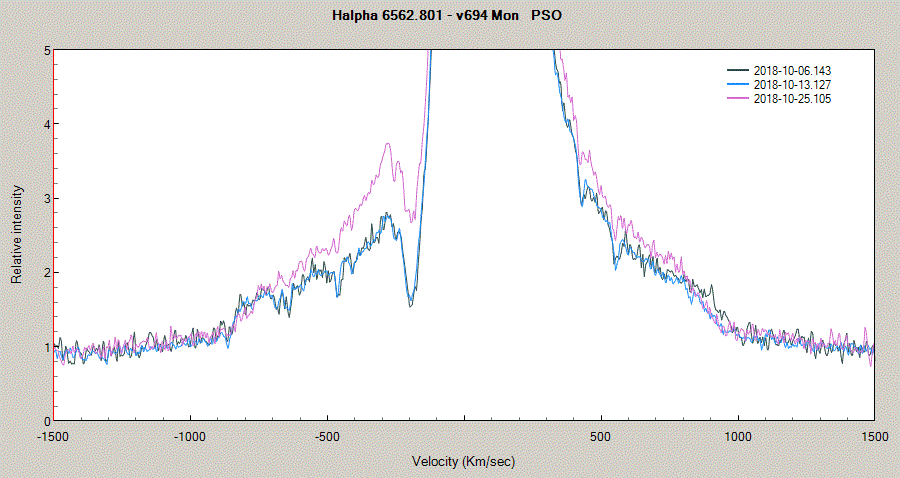

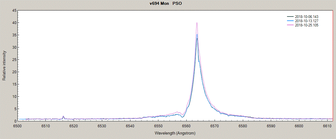

With a fresh result from this cloudy morning, presenting H-alpha evolution in the past few weeks:
The essence of changes require magnification + good SNR:
Although there have been no remarkable change between 10.06 and 10.13, the V wing has increased by now (whilst the R side remained proportional to the H-alpha intensity).
Perhaps (hard guess), a V-side peak is uncovering?

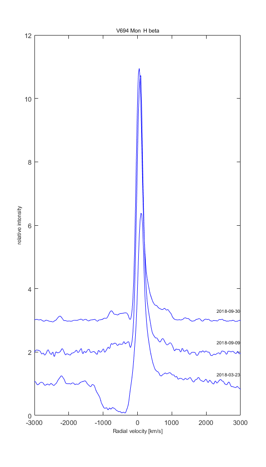

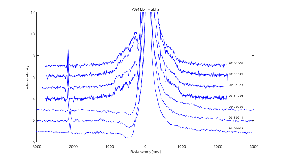

H alpha and H beta this year from spectra obtained by Peter and Umberto
showing the sudden changes of the profiles.

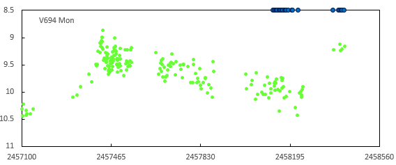

The lightcurve:
