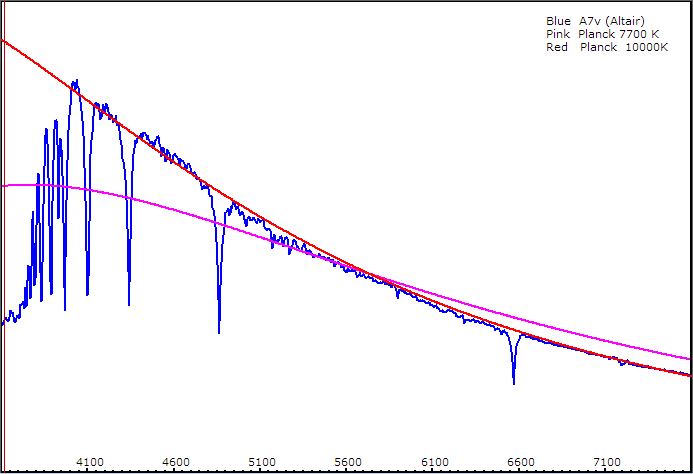

This question is often coming up. You should not claim you can measure the temperature of stars by fitting a planck curve to the continuum. No astronomer actually does this. Spectroscopic classification uses the strength of different lines, not the continuum shape.
The method just does not work. For example the claim is that the a 7700K Planck curve is a good fit to Altair (A7v) is but if we look at the fit is is not good at all.
We can fit a Planck curve to the part of the spectrum which is a black body but that gives a temperature of 10000K. The figure 7750 K Kaler gives is Teff which is the temperature that a black body would have to produce the same total amount of radiation. It is theoretical and does not represent the actual temperature of the star photosphere.
