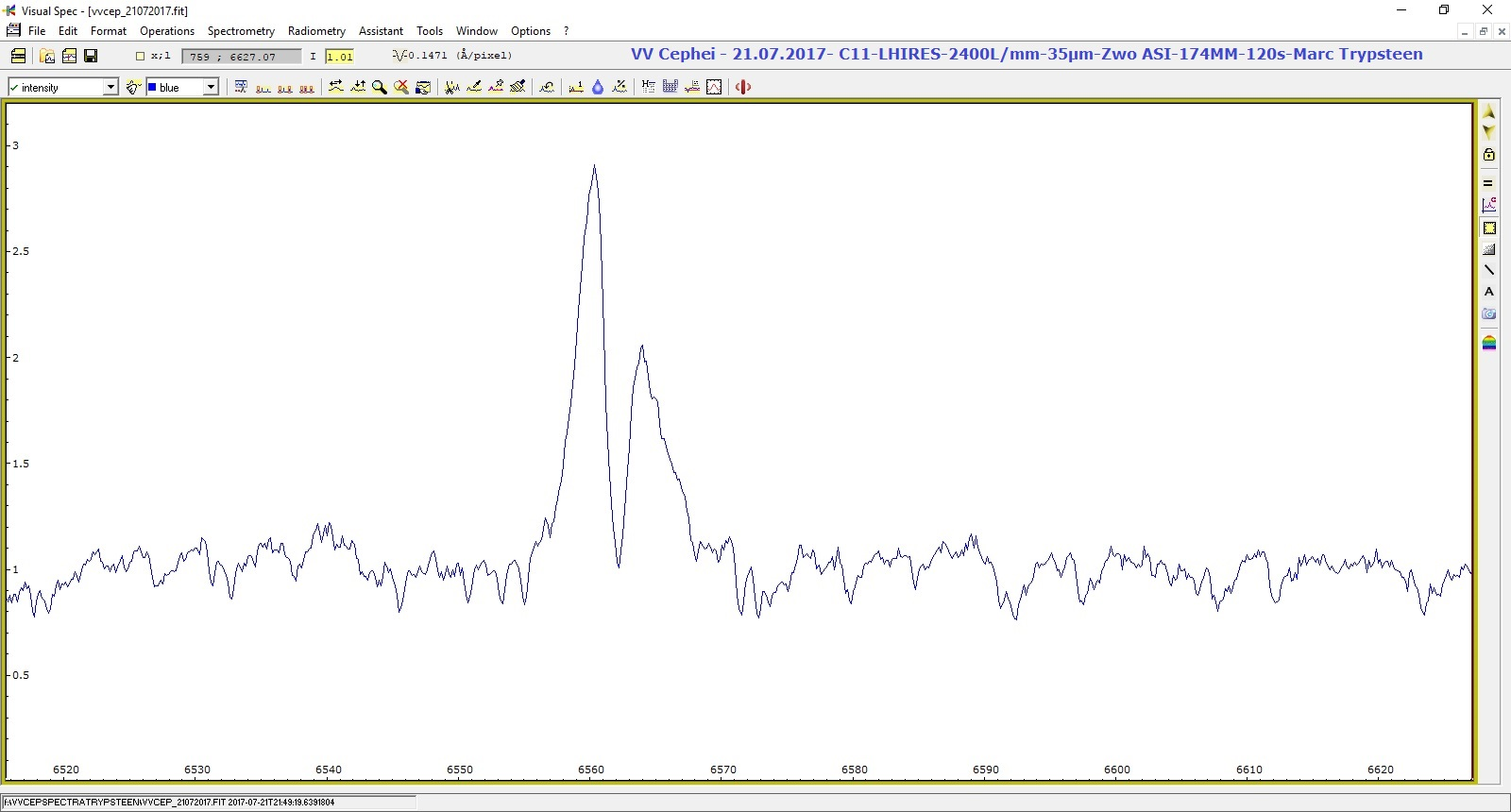

That's a nice spectrum, I see a difference between your 35 and my 23 micron slit widths.
Regards,
Jack
Essex UK
Regards,
Jack
Essex UK

Indeed the main investigation of this campaign is now the H-alpha behaviour.
However the ingress and egress phases of the eclipse can be well monitored as reported by Moellenhoff et al H-ß variations seem to be more rapidly noticable.
Ingress H-ß monitoring: http://adsabs.harvard.edu/full/1978A%26A....64..253M
Egress H-ß monitoring: http://adsabs.harvard.edu/full/1981A%26A....94..333M

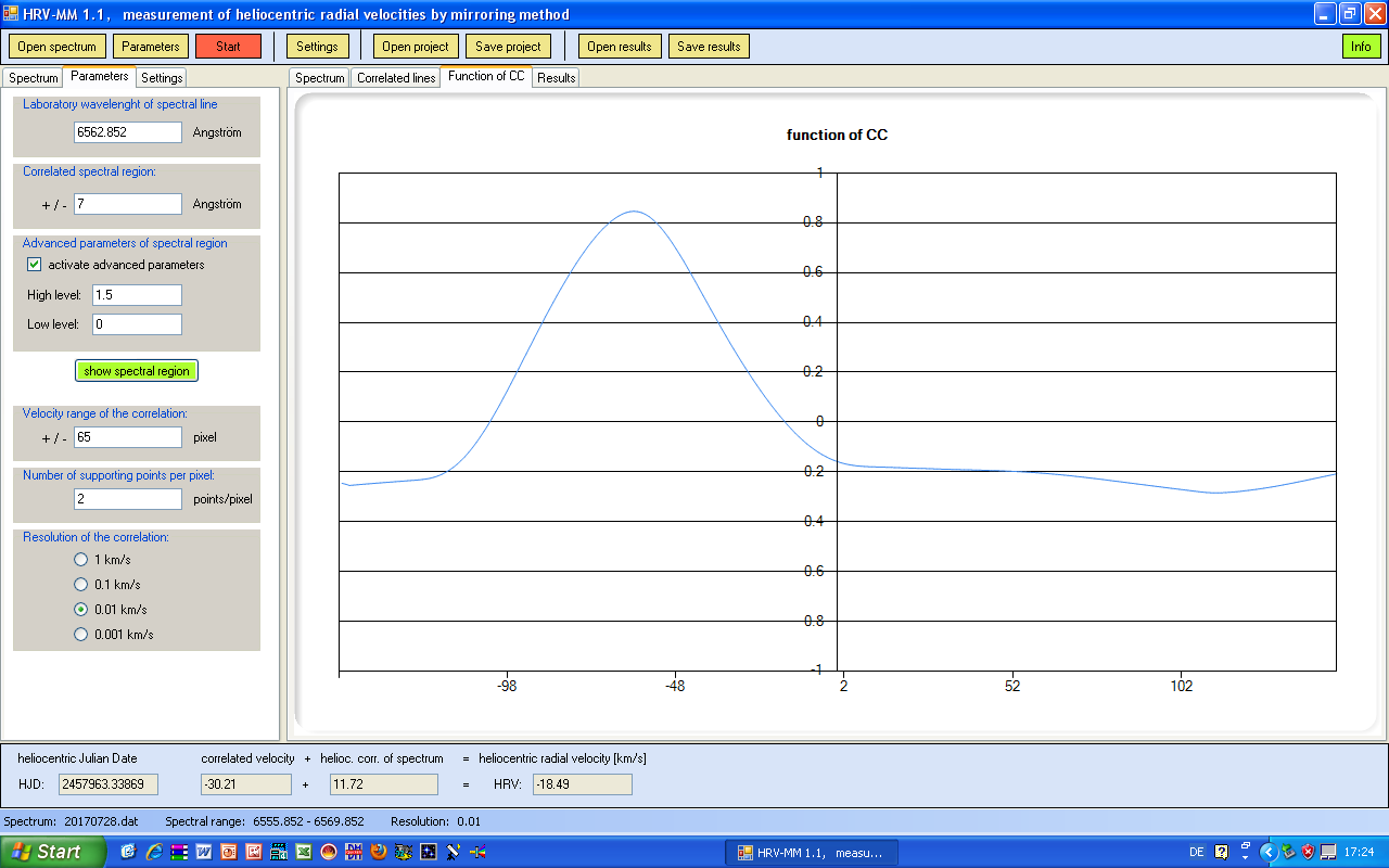

Here's a spectrum taken last night with eshel spectrograph
Order 34 : H alpha
Order 34 : H alpha

... a great (first class) spectrum, Olivier. That´s a quality I love. It´s evaluated meanwhile.
I calculated the radial velocity (see Fig. below): RV = -18.5 km/s.
The average value of approx. 40 measurements with different spectrographs = - 22.2 km/s (+/- 1.9 km/s) Ernst
