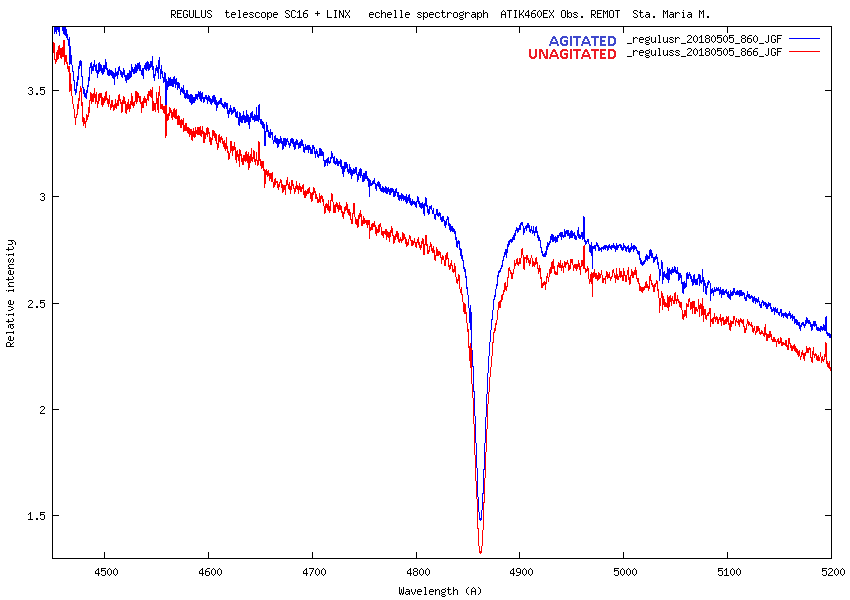

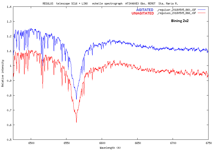

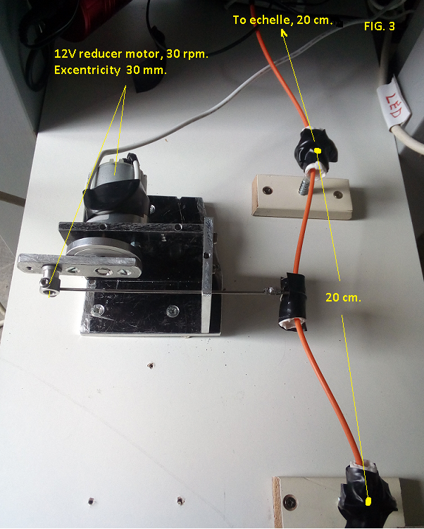

I have built this agitator in Fig.3, which I could test last night with Regulus, the agitated graphics improves, but I think that it does not do enough.
 Perhaps a solution would be to use an optical fiber of 5 meters in length and place another agitator. Now with 2 meters I can not put any more.
What is your opinion ? What do you think I have to do to get better results?

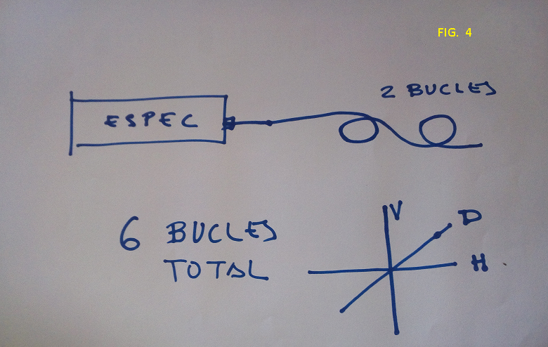

Another question, if instead of shaking the fiber, they would be made a series of loops similar to Fig.4. Could it work?
