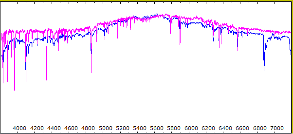

Here's comparison between Christian and Miles observed spectra, using VSpec :
There's little difference between intrumental/atmospheric correction.
Up to date, we can say :
- use only E(B-V) = 0 stars to compute the instrumental response
- when the continuum of a processed spectrum doesn't mathche with the theorical spectrum, one must considerer a possible difference in color excess index between the starused to compute intrumentral response and the observed star.
