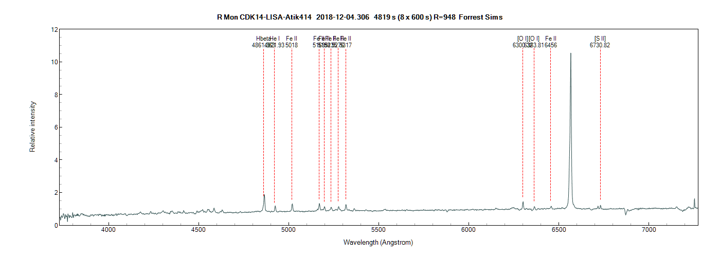

Post by Forrest Sims »

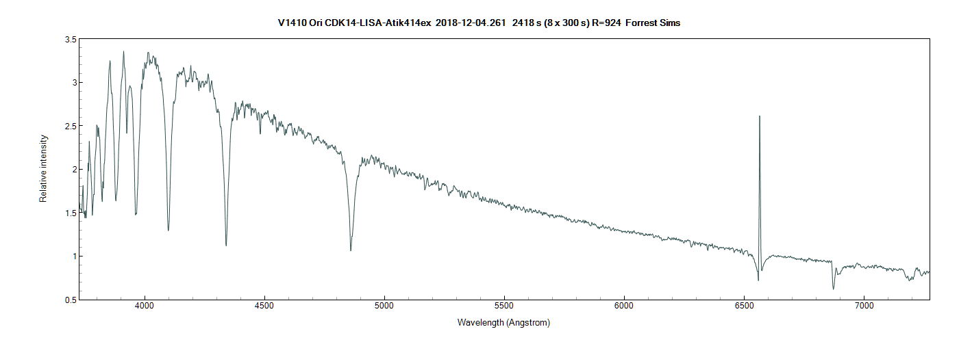

Here are spectra of R Mon and V1410 Ori. R Mon was a more difficult target at approximately magnitude 11.8. Located at the tip of the diffuse Hubble’s Variable Nebula, it is a bit hard to put the star on the slit and guide on it. You can see what the target looks like at the tip of the nebula in the attached auto guider image. The spectrum of R Mon shows HeI, many Fe lines, OI and SII emission lines.
The spectrum of V1410 Ori looks very much like the one David posted from 2018-11-21.862.
Woody

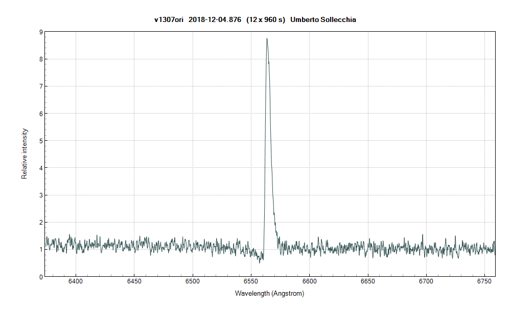

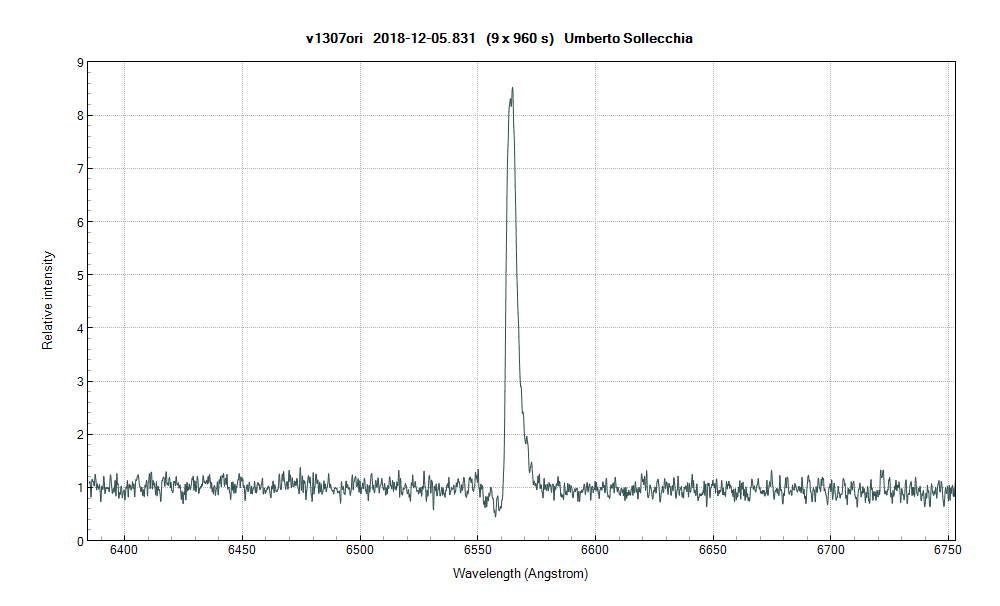

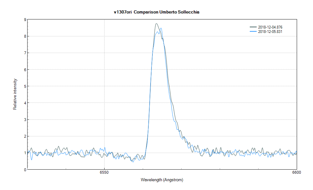

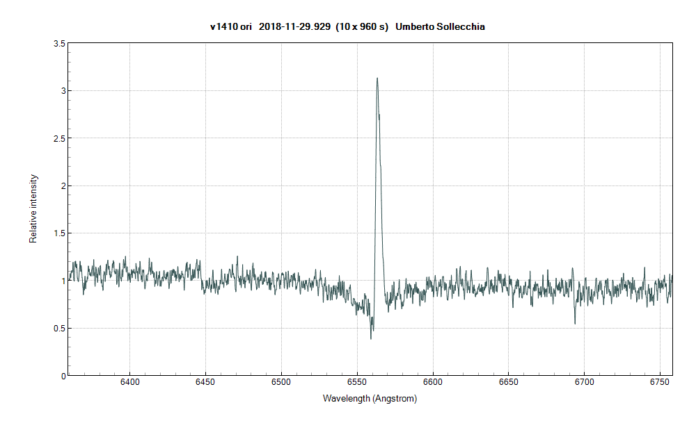

Bonjour, voici ma contribution. Umberto
v1410ori_20181129_929_Umberto Sollecchia.png (51.28 KiB) Viewed 20769 times
v1410ori_20181206_845_Umberto Sollecchia.png (58.56 KiB) Viewed 20769 times
Comparison
v1410ori Comparison Umberto Sollecchia.png (42.41 KiB) Viewed 20769 times
v1307ori_20181204_876_Umberto Sollecchia.png (45.03 KiB) Viewed 20769 times
v1307ori_20181205_831_Umberto Sollecchia.png (42.25 KiB) Viewed 20769 times
v1307ori Comparison Umberto Sollecchia.png (37.5 KiB) Viewed 20769 times

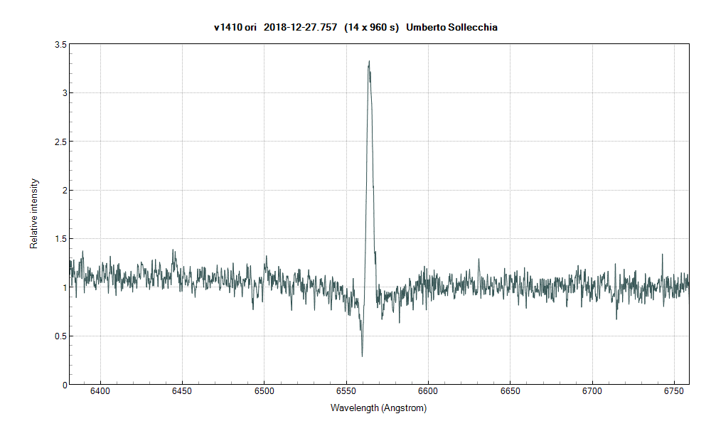

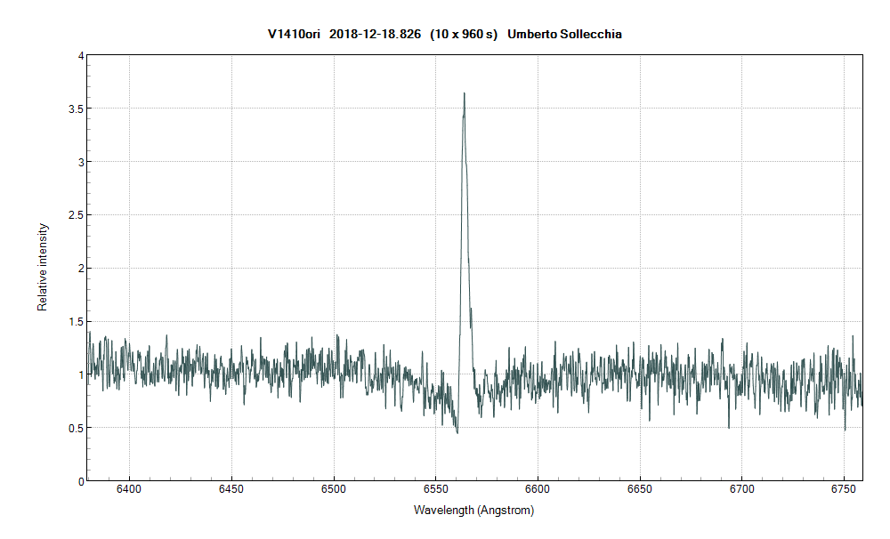

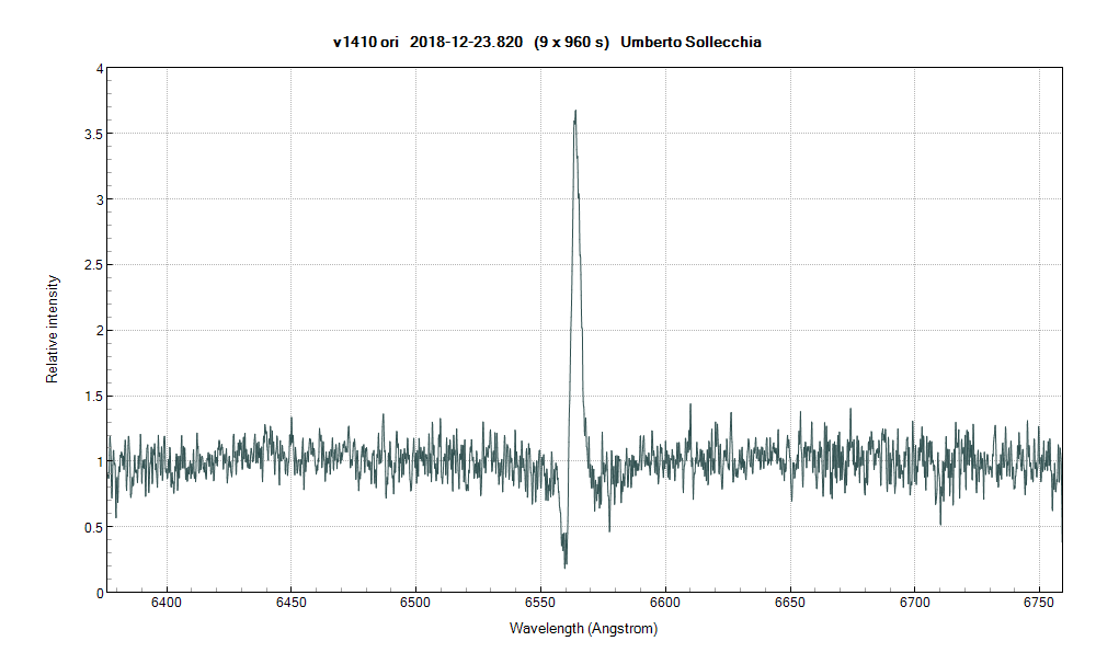

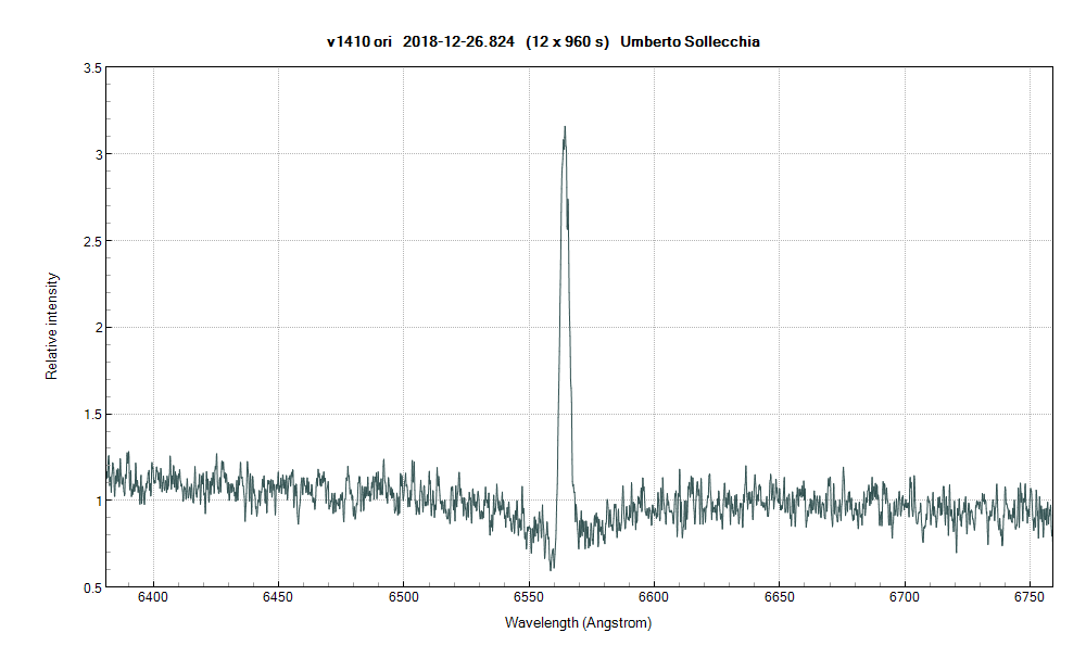

Bonsoir, je poste d'autres profils de mes observations de l'étoile 1410 ori.
v1410ori_20181208_849_Umberto Sollecchia.png (58.49 KiB) Viewed 20645 times
v1410ori_20181218_826_Umberto Sollecchia.png (66.51 KiB) Viewed 20645 times
v1410ori_20181223_820_Umberto Sollecchia.png (64.38 KiB) Viewed 20645 times
v1410ori_20181226_824_Umberto Sollecchia.png (55.42 KiB) Viewed 20645 times
v1410ori_20181227_757_Umberto Sollecchia.png (56.29 KiB) Viewed 20645 times
