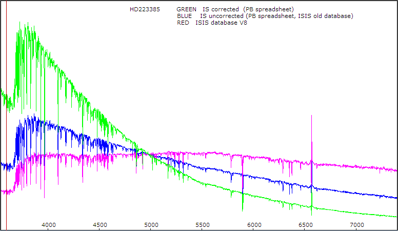

Hi Christian,
I am seeing large differences between the old and new ISIS databases. Here is MILES HD223385 for example. Is the reddening working correctly ?

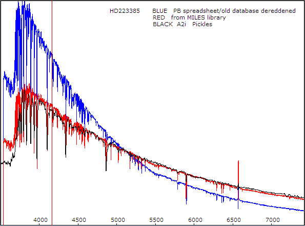

It looks like the spectra uncorrected for IS extinction used in PB's spreadsheet and the original ISIS database may be the problem. If we start with this spectrum for HD223385 and correct for IS extinction (using either PB's spreadsheet or ISIS) we get a much hotter star than type A3i. The IS extinction corrected spectrum in MILES is a good fit to the Pickles spectrum of the same type. I have not checked any other spectra to see if this is just a problem with this star or a more general problem
