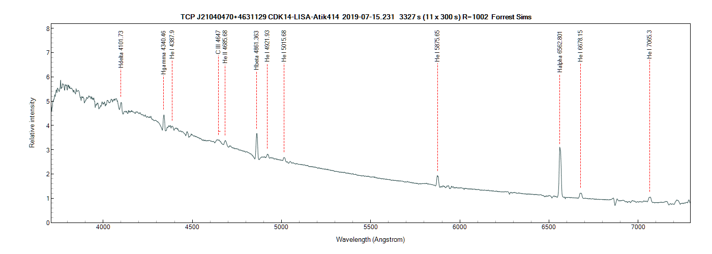

And my contribution on TCP J21040470+4631129 taken with my LISA late evening 2019-07-14.
Woody

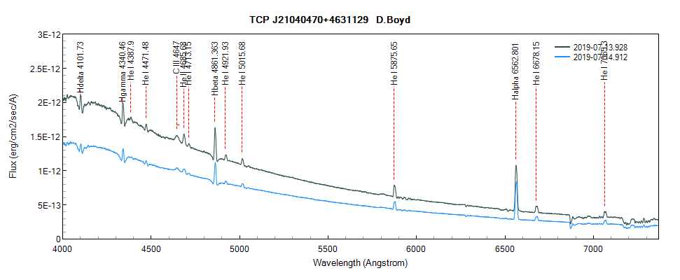

This shows the change in the spectrum of the dwarf nova over 24 hrs as its V mag faded from 9.14 to 9.52, a flux reduction of 30%. The B-V colour index was unchanged at -0.22.

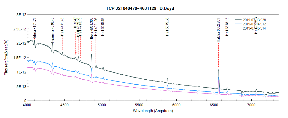

Another spectrum 24 hrs later shows a further reduction in the continuum flux level. The V mag used to flux calibrate the spectrum is now 9.76. Assuming the continuum flux at this stage is primarily from the accretion disc, the auto-planck function in Vspec gives a disc temperature around 30,000K which is reducing slowly.

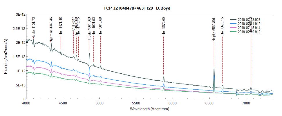

The continuing good weather has enabled me to get one more spectrum showing a further reduction in flux, now at magnitude V=9.92, and the colour index is becoming slightly less blue at B-V=-0.19.

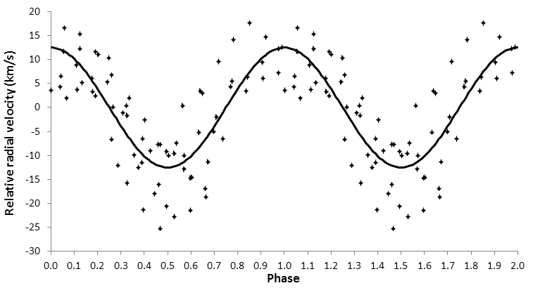

Time resolved spectroscopy of the dwarf nova with a LISA spectrograph at R~1000 on 5 nights between 13 and 18th July provided 73 spectra, each a 300 sec integration. Each session lasted about 1.6 hrs, longer than the binary orbital period. SNR per spectrum fell from ~100 at V=9.1 to ~50 at V=10.4. Each spectrum was cross correlated with respect to the first spectrum taken each night to find their relative radial velocities. Period analysis of these relative radial velocities gave three strong signals with frequencies separated by the expected 1 c/d aliases. One of these periods, 0.05335 ± 0.00017 d, agreed with the orbital period derived from photometry. Phasing the RV data on this period gave the following phased RV plot. The rms residual to a fitted sine function (assuming the orbit is circular) is 6.5 km/s.
