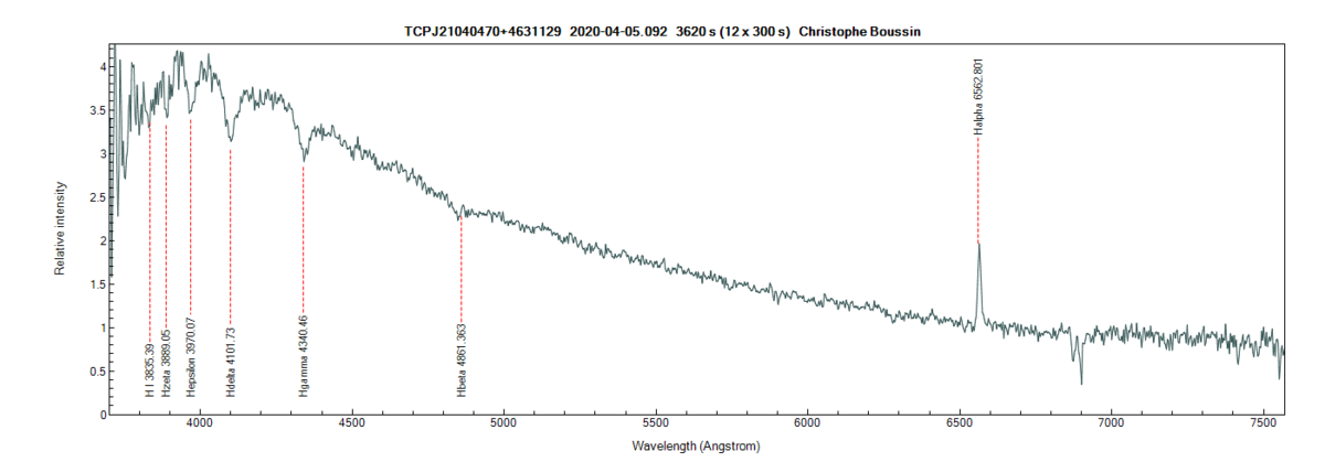

Here is my contribution to the monitoring of TCPJ21040470+4631129.
The spectrum below was obtained, on April 5 at 2 h 12 TU (Alpy 600, resolution 500, JJ = 2458944.5918, 12 exposures of 300 s) :
Take care of yourself and clear skies to all !

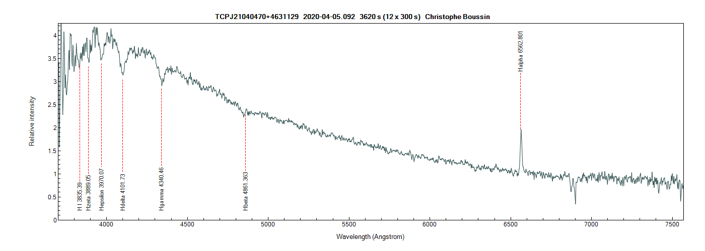

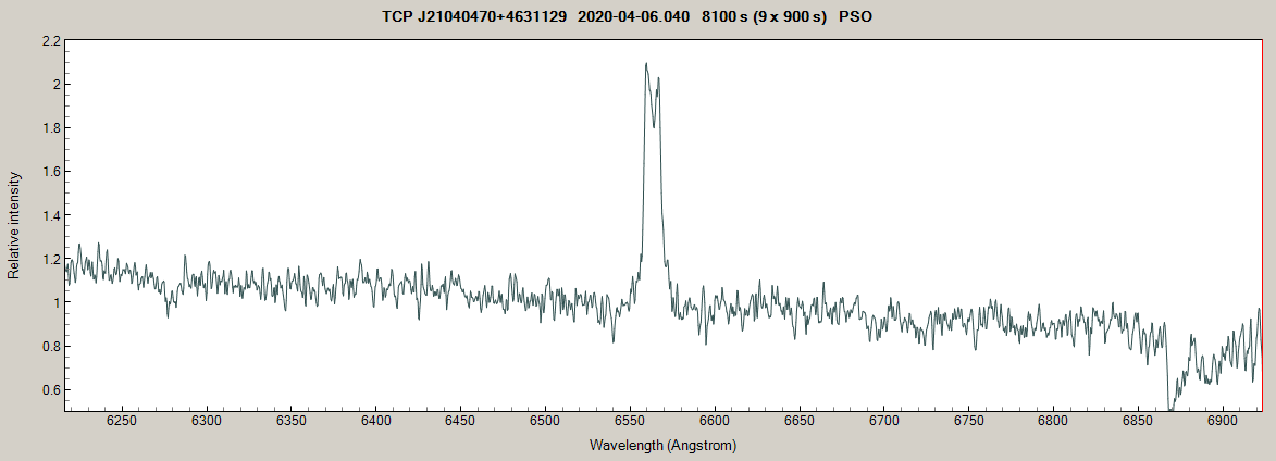

Re: Further outburst of the (DN) Dwarf Nova TCPJ21040470+463
Catched a few days late after the outburst (~ 11.3 mag now), fresh result of this windy morning (12" Newton, ATIK 428Exm, LHires III + 600/mm grating + 35 micron slit): I belive H-alpha is changing in the meantime above noise.
By RV range, it looks similar to Paolo's excellent spectrum on 2019.12.11.
Sent result to ARAS DB.

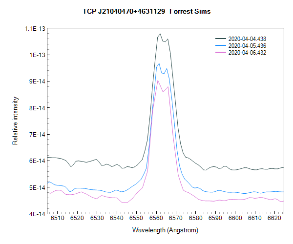

Very nice spectra Christophe and Peter!
Here is a plot of Halpha from the last 3 nights. These are flux calibrated spectra. The average V mag I measured in date order were:
11.432 error = 0.021
11.573 error = 0.029
11.595 error = 0.026
I can clearly see the dip in the center of the Halpha line but Peter's spectrum provides so much more detail! All spectra have been submitted to ARAS and uploaded to the BAA database.
Woody Sims
Woody Sims
