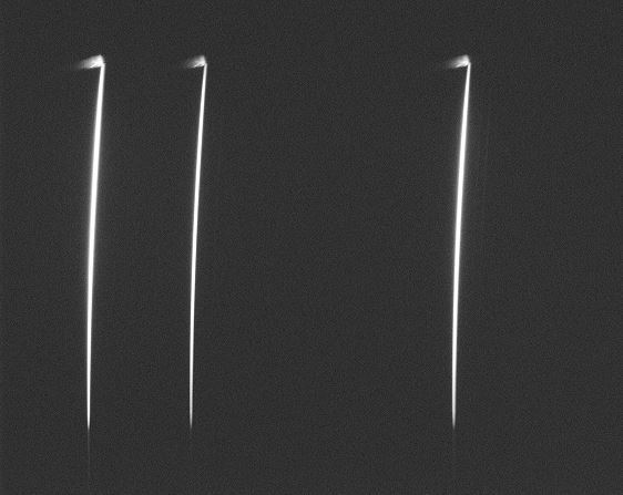

Here an image of my calibrationlamp with 2400 l/mm grating:
I'm also going to try ISIS as a tool to achieve the best focus. I will try this out next weekend.

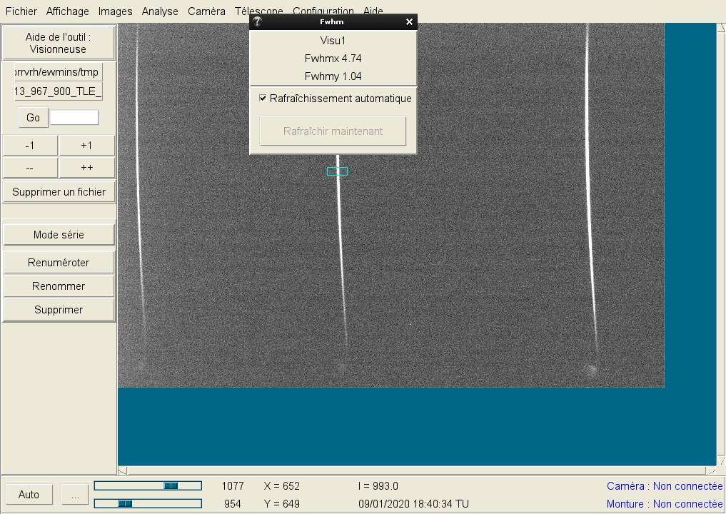

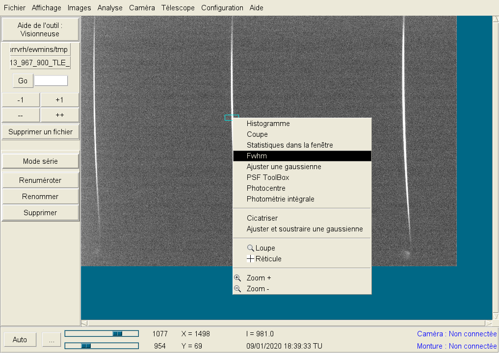

There is a dedicated FWHM measurement tool for focusing process available in Audela software [1].
1. First you draw a rectangle (left click mouse button) around line's zone you want to do FWHM measurement
2. Click right mouse button and select FWHM:
Select FWHM with right click
3. Check radio button at window's bottom in order to get measurement refreshed when a new image is displayed during focusing precess:
FWHM refreshed measurement
